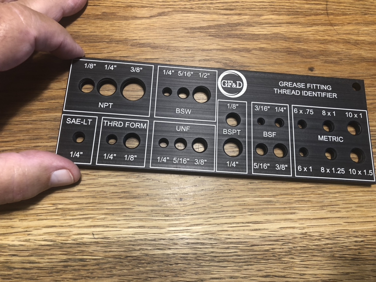

Most, all? Kubota grease zerks are British thread. Kubota dealer can sell you the correct replacement zerk but unlikely tell you the thread size. Dealer prices are not too bad just inconvenient.
Have large assortment set of SAE zerks. Works good for older equipment. 46 grease zerks on my 65 Dodge power wagon.
Ordered metric assortment from McMaster for the Kubotas. None fit.
British assortment set are very expensive. Did find a package of 4 at TSC.
What I’ve done is get a couple spare zerks in two sizes from the dealer to have on hand for the loader backhoes. Kept in a pill bottle with all the grease maintenance parts and tools drawer.
Really need to use the thread guide and post the thread sizes on my tractors. Wintertime project.

Smokeydog, Will you please post a link or tell us where you found/got that particular thread identifier?
I looked on amazon and they have a lock-n-lube one.....but very expensive and does not look exactly like yours. I did not try a GF&D search though. I'd like to have one of those in my toolbox. Probably not get used often, but when needed would be extremely handy.
Thanks Greg
Never mind...I googled GF&D and there it is! I've got to remember to google first I guess!

When looking for BSF grease zerks......they call them nipples.

I bought myself a zerk gauge just like the one pictured after smokeydog posted on another grease thread. Very nifty thread gauge, so I got one for my tractor buddy as well. Hard-anodized aluminum.
So far neither one of us have found a use for it....but I'm hoping.
I agree with smokeydog that the key to having the right zerk on hand is to be systematic and orderly. So I keep all the zerks and zerk tools in a 5 gallon grease cartridge pail where they can gently sink into the ooze at the bottom. Safe and secure & I know where they are....or rather, where they must be......
