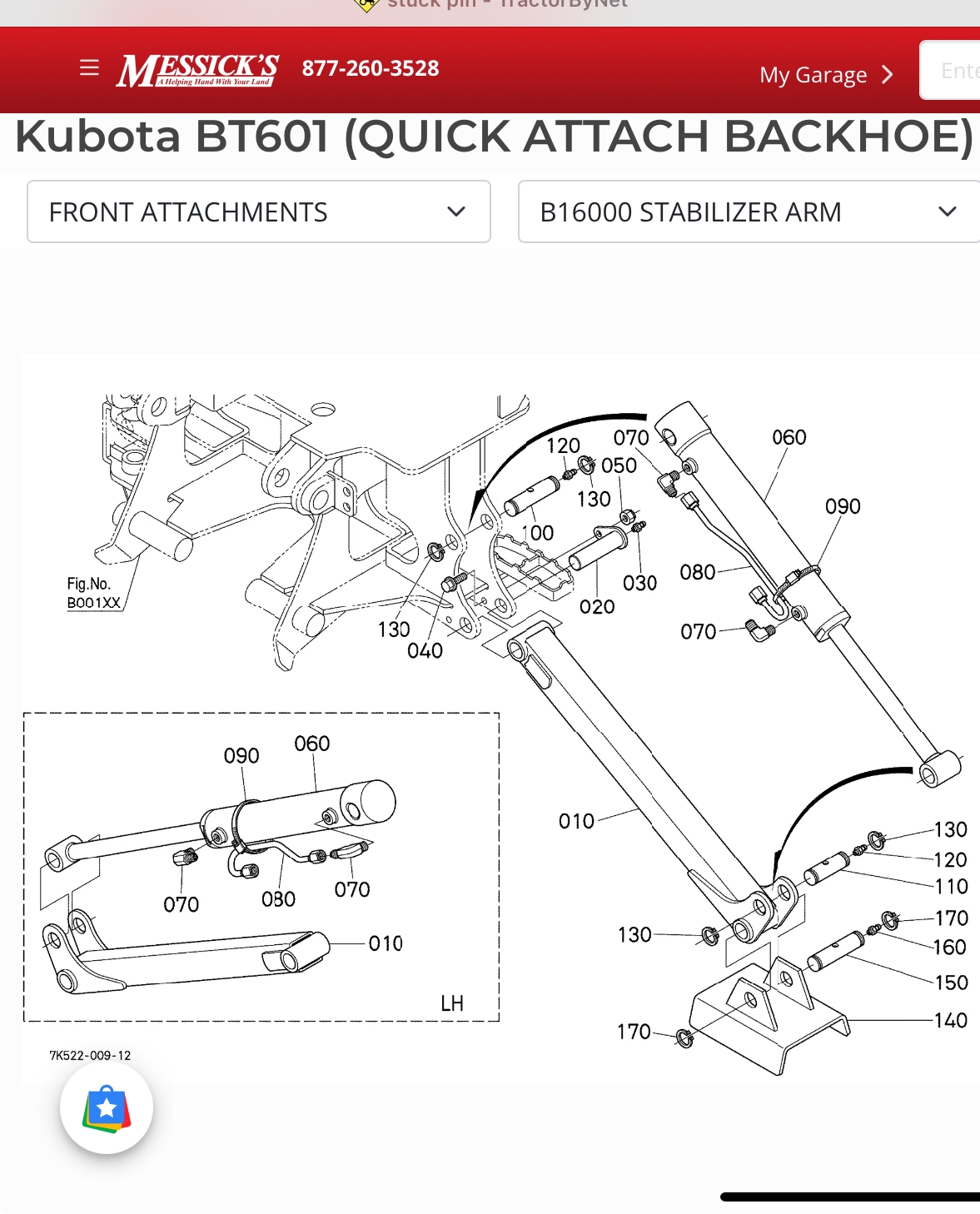

Thanks MT. Have already unscrewed, and even replaced the zerk fitting. Even acquired one of those grease joint rejuvenators, didn't help. If the pin is solid, I can pound it out appropriately, but didn't know if it was. Certainly seems so, but didn't want to do the wrong thing to start off. Like I said, already removed the clip and tapped some, but didn't budge. Was hoping someone could confirm it is solid and ok to hit harder. BTW, know where I could get an exploded parts list ?
If as with most Kubota’s, the zerk screws into the middle of the pin, then your pin is drilled at least partially till at leas one cross drilled hole is encountered (my guess approximately 1/2 the length of the pin. If you decided to use heavy tapping to remove the pin, I suggest you have a replacement in hand as damage is likely.
You indicated you have removed the zerk and even replaced the zerk. Did you use any cleaning product to try to get old grease out/loosened?
One trick to try would be to relieve hydraulic on that cylinder/pin and see it it will accept grease. Try with tractor not running to lower the stabilizer. Light contact with the ground would be best I think. Without power just relief if the stabilizer wants to bind, you have an issue. At that point replacement of the pin is required in my opinion. At that point, I would drill the pin and then drive it out.

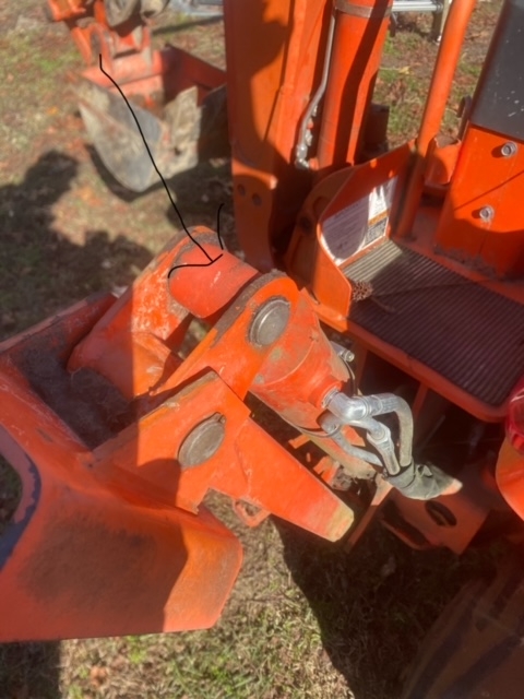

2019 BX25D. During last greasing operation, I could not get grease in the top joint of the outrigger. The arrow points at it. I took the C clip off, thinking the pic would come out, but light tapping got nowheres. Before I hit it hard, I need to know if it is solid and OK to hit hard. Wish I had an exploded view parts document, but don't.
Zerk fitting is on the otherside.
If you are going to use heat extend the rod out as this gets the piston away from that end. Next the heat has to be fast so it does not soak into the pin. A cutting torch is what you would use as tip temp on a neutral flame is 6000 degrees. Have help and as you start heating have a friend tapping. Once you start with heat you need to finish as anything you heat will be a bit smaller when it cools, thus the bushing will be even tighter on the pin if you do not get it out. Have a garden hose handy in case the cyl gets warm or a small fire starts. Big heat fast is the only way. I have been a welder since finishing high school, now 70 yrs old

Most likely one of two things has happene. Either the pin has become bound to the cylinder rod bore, and or this has allowed the rod to turn in the stab leg wearing a notch in the pin. I always hate hammering on a pin, if you mushroom the end, it’s not going back through the hole. Before getting carried away, get a good high power heat gun and or a hand torch and heat the pin from both sides and see if that loosens the harder grease any, and that itself may allow the pin to move. If all else fails, I have had to saw out the pin and then get the cylinder in a press to get the piece out. FYI Messicks has an easy to use parts book system for Kubota
the pin will be drilled halfway down from the filling hole to the middl, then cross drilled to get grease to the rod
Careful though. Looks like when that pin does come out the outrigger is going to drop. .

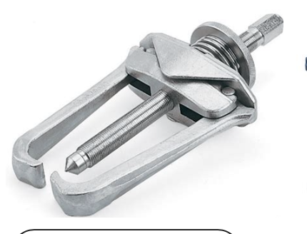

Maybe a heavy equipment shop might be able to use a track pin remover like on a dozier. Doesn't hurt to ask . Caterpillar makes such a tool that has tremendous power.

Look at post #3, it's all right there for ya!
