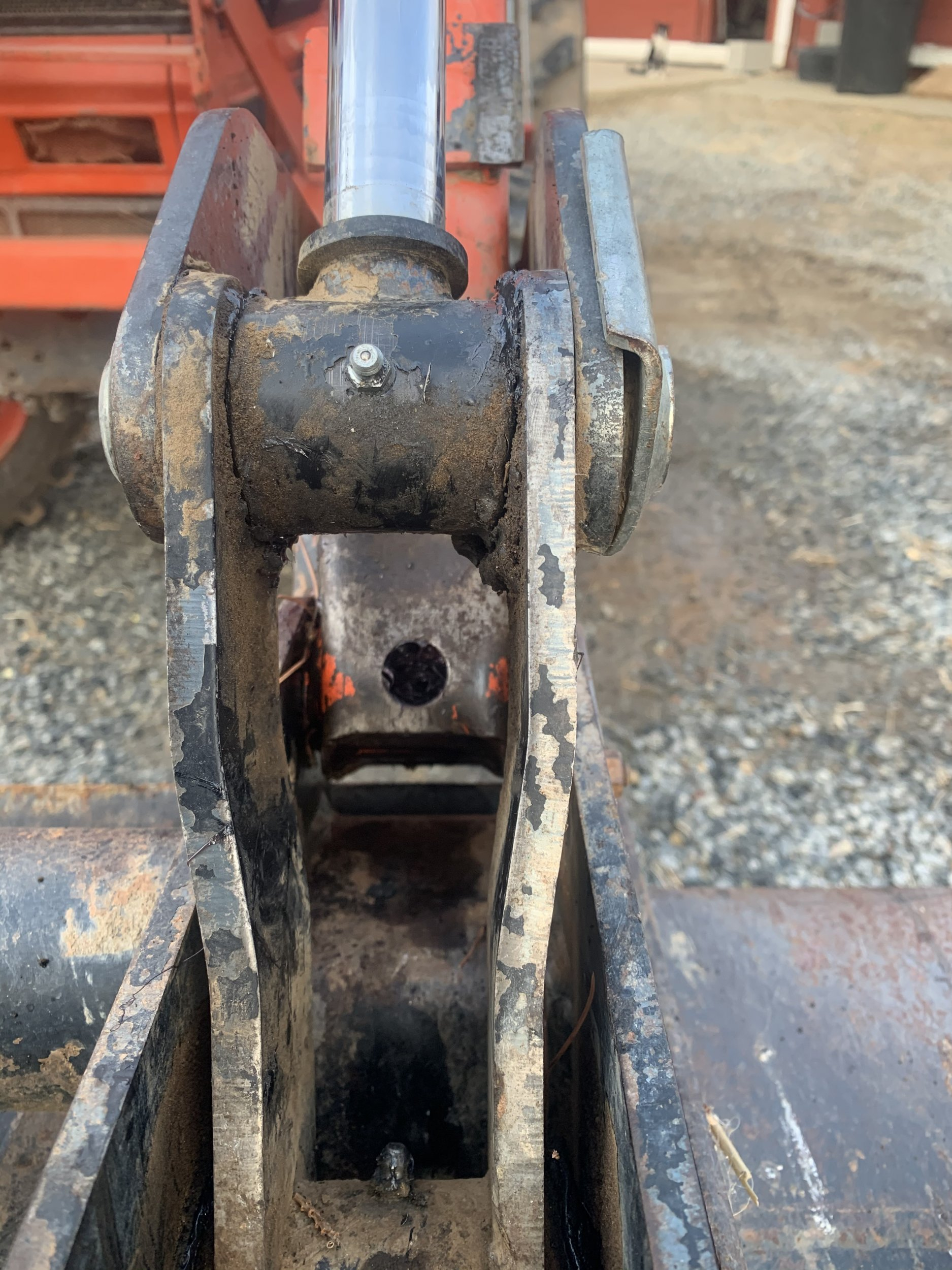

Today was set aside to clean up the tractor, change the air filters, blow out the radiator, etc., and check it over generally, and grease it. All went well with the greasing until I found one zerk missing - in the most difficult zerk location. Nothing I had would fit - I removed a zerk from elsewhere on the FEL to test the size and it would not fit either - feels loose. I cleaned the hole out and tried to see if there were threads remaining - I think not but it is really hard to see that particular area. I cannot tap new threads there because of the hard-to-get-at location and because the cutting part of the tap does not start until about a quarter inch up the tap and the tap would dead end before it started cutting. I went on with greasing and while greasing another area a zerk came off in the lock-n-lube. It would screw back in but remained loose and came out by hand. That area, btw, would not take grease before it came out.

Post a picture.
Of the hole where one was missing? where one fell out? Will do - not sure if light will be ideal.
Update: Went out to take pics - not sure what use they will be - just show where one was missing (first pic) and one came out (second pic).

The second picture looks like the fitting was possibly welded in place.

-My problem is that on the one that fell out, the threads in the hole appear to no longer work to hold the zerk in, they catch slightly but not enough to remain useful. And the hole where the one is missing is even looser - I cannot see down in there to even see if it has threads - it is down inside one of the arms. I can only shine a light straight in and not an an angle that would let me see the threads - or even if there are threads.
-there is no welding anywhere near either zerk - I have been the only owner of the tractor. On the pictures, the missing zerk is down small hole in the middle of the picture.
Sberry, I may do what you say - as I have never taken the pins out of the FEL I was a bit apprehensive about what kind of a jam I might make for myself once I start dismantling that. But as you have explained it it seems doable and that would let me use a tap to rethread it - just need to make sure I have zerks to match the new threads. I can also clean everything out. It may remain a challenge -or impossible - to rethread the holes given where they are located - I will assess that before I take it apart.

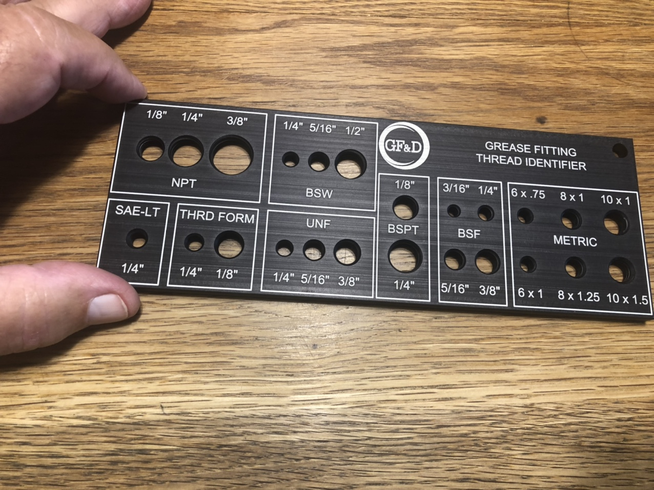

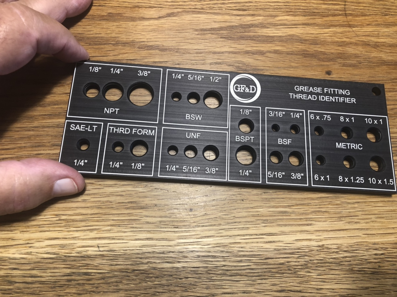

Smokeydog, Will you please post a link or tell us where you found/got that particular thread identifier?
I looked on amazon and they have a lock-n-lube one.....but very expensive and does not look exactly like yours. I did not try a GF&D search though. I'd like to have one of those in my toolbox. Probably not get used often, but when needed would be extremely handy.
Thanks Greg
Never mind...I googled GF&D and there it is! I've got to remember to google first I guess!

I bought myself a zerk gauge just like the one pictured after smokeydog posted on another grease thread. Very nifty thread gauge, so I got one for my tractor buddy as well. Hard-anodized aluminum.
So far neither one of us have found a use for it....but I'm hoping.
I agree with smokeydog that the key to having the right zerk on hand is to be systematic and orderly. So I keep all the zerks and zerk tools in a 5 gallon grease cartridge pail where they can gently sink into the ooze at the bottom. Safe and secure & I know where they are....or rather, where they must be......
