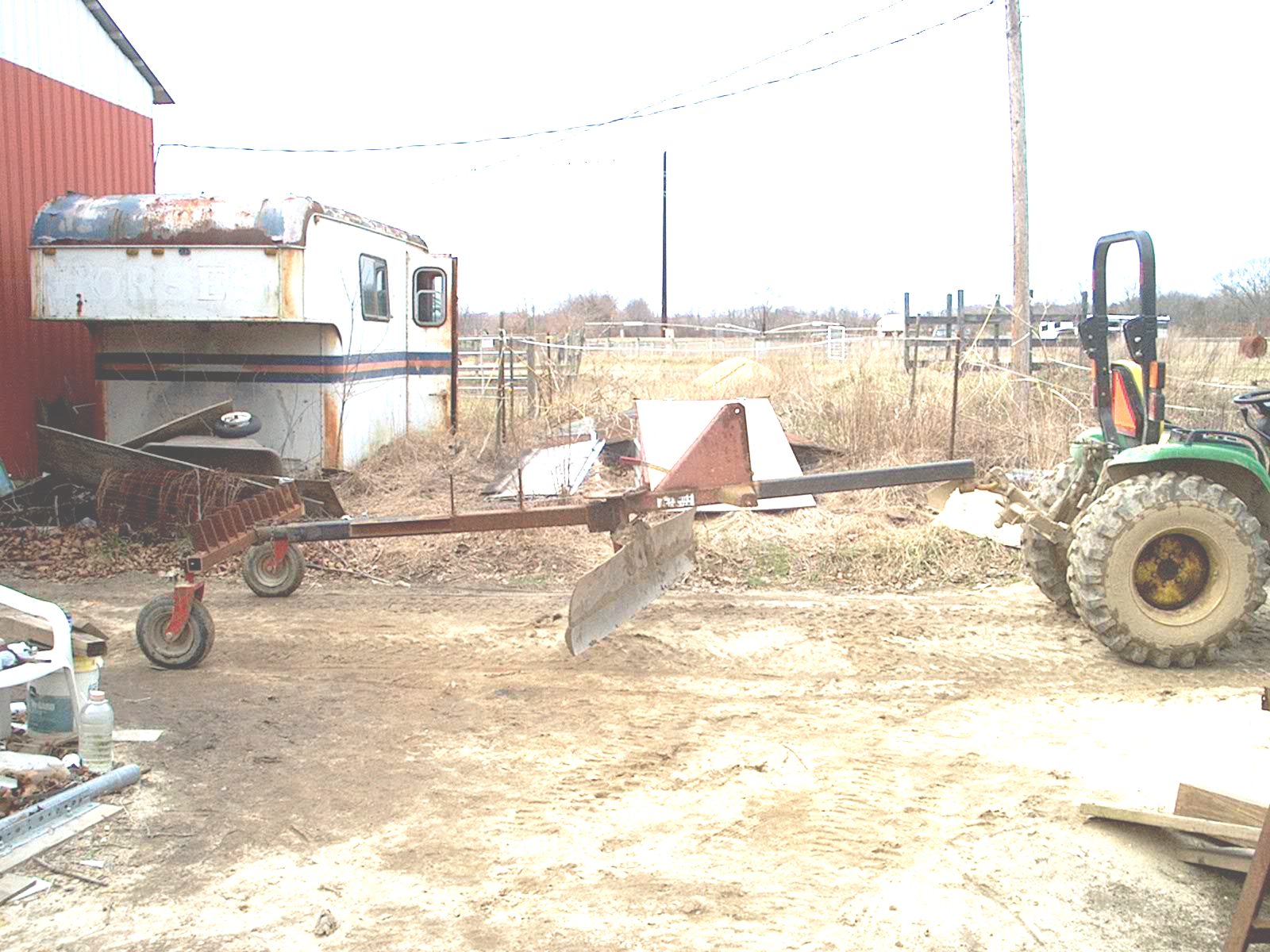

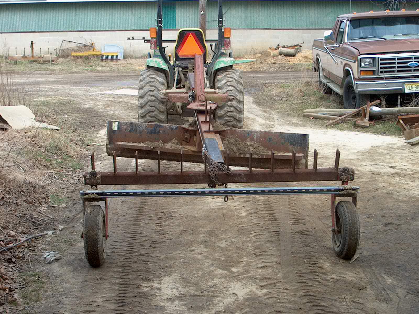

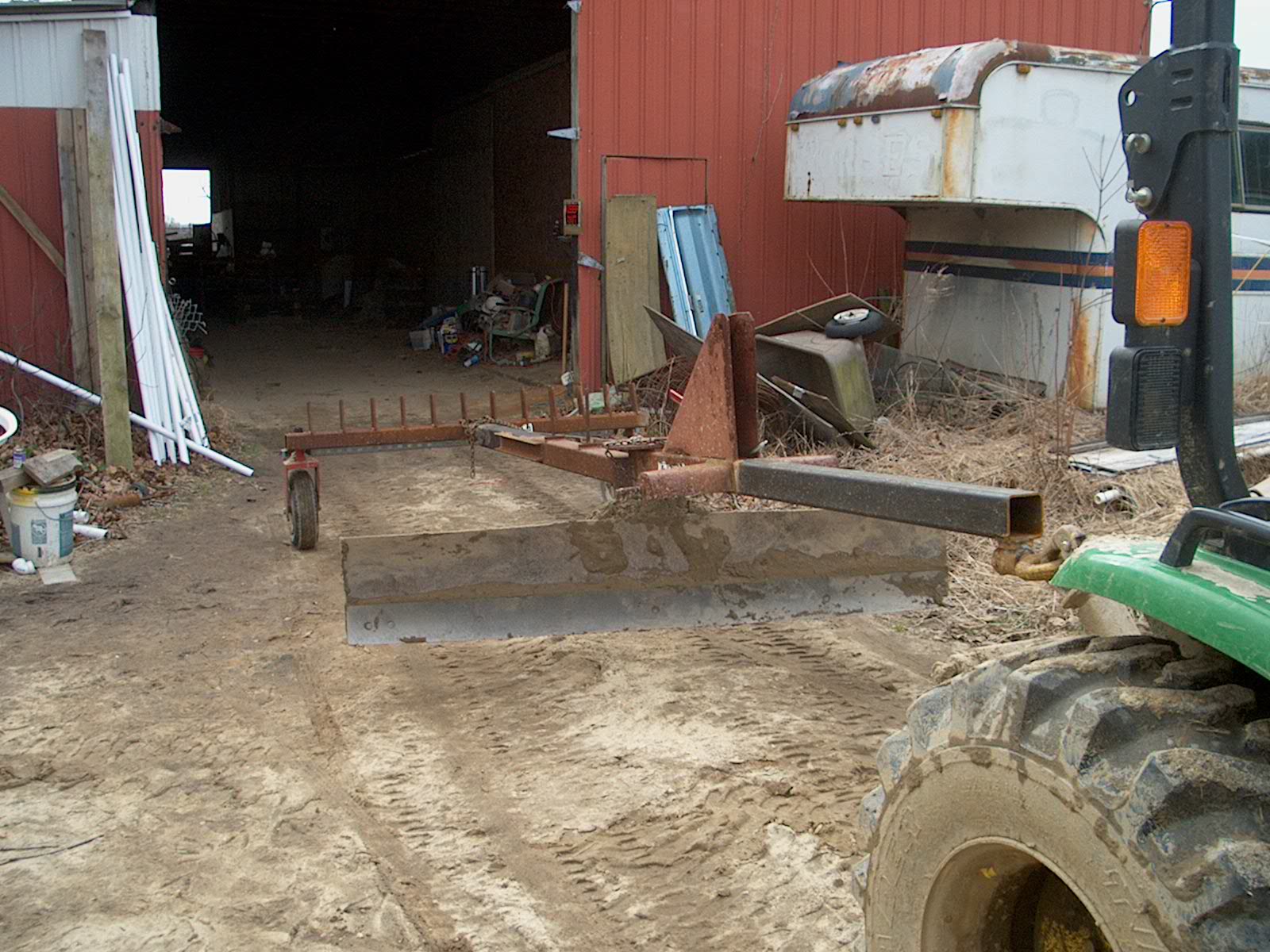

Renze the grader wheels had to be angled by feel. Depencing on the cut and the material you were in. I used a longer steering cylinder and could really put the angle into it. I also got a hold of a set of high ribbed implement tires off a Ford tractor front end. They really increased the steerablilty of the grader. While Ihad the grader and the larger tractor here I graded alot of road and re terraced a small garden I use. With the rear steering axle I also got the added benefit of the blade following the tractors
tracks. When using a drag scraper you can turn too sharp and the corners dig in and duck walk and the blade wants to jack knife. when turning you can steer the lever over left or right and the blade would track and follow in more of an arc. I recently found a mud axle Hydraulic assist 4 wheel drive unit for a combine. Its got planetaries I thought of making another grader for our 4000 Ford at work when it get overhauled. That way when doing the grading I could use the pto pump to run the rear axle with the steering and the drive for the extra push should make a good combination. I really wished I still had my old pictures of the grader at work. Im planning to build another one some time this summer to go behind my 30 HP Yanmar.

I have a 3 ton rigid axle available with 10-15 wheels. Those will do, a center pivot axle wont change blade depth due to caster angle.
Ideally, it would have hydraulic forced steering, like a trailed rake has (euro style dual spinner)
The rear wheels countersteer in the corner so the mid of the machine (where the rakes are) follows the tractor track. When this forced steering system uses two hydraulic cylinders instead of a push/pull rod, i could add oil to one side of the circuit to offset the grader, but it will still automatically follow in corners even in offset..
Dont know if i have enough cylinders to do that... And a forced steering system would limit the grader to one tractor that has an extra mount for the master steering cylinder, or would force me to go 3pt hitch mounted...
Tractortaylornut, did you make the graders 3pt mounted, or lower drawbar ? I'm afraid that 3pt hitch mount is too far back, pushing the rear of the tractor over, and reacting more violently at dips and bumps that the front wheels of the tractor hit.

The road crew in town modified one of those pony graders by removing........
Our towns road crew had a grader 30 years ago, but sold it for scrap to a local agricultural contractor who cut off the front end right in front of the cab, welded a tow eye to the frame and hooked it to a tractor, pulling it reversed, with the blade turned around 180 degrees on the slew ring.. that would actually be my ideal tool, but they dont want to sell it even though they do most contract levelling with a laserblade on a payloader.
they now use a front 3pt mounted, fixed 45 degree angle blade to crown the road, and a land drag in the rear 3pt to finish it... the front mounted crown plough often puts the front end of their Deere 7610 into the roadside ditch....
its allways the 16 year old apprentices that get to play in the dirt, the older guys arent interested... Myself, when preparing pasture for reseeding, my father keeps reminding me that its going to be a horse pasture, not a billiart sheet...
The only guy that knew how to do a road in our town dept, was retired with his aforementioned grader, 30 years ago...

Renze I just mounted it on the drawbar that goes on the lift arms. I didnt have the time or material at the time to make it mount o nthe lower draw bar. I could have mounted it there and put a pivot hinge in the toung with a cylinder to crank it up and down. plus another thing was when pulling in a tight circle one hooked to a lower draw bar that doesnt go past the wheels the tounge can get into the tires in a hard turn. I dont think it would put too much stress on your lift arms. google Hoopers engineering land plane graders and scoops they have some neat pictures of large simple pull type graders there they are in Australia.
