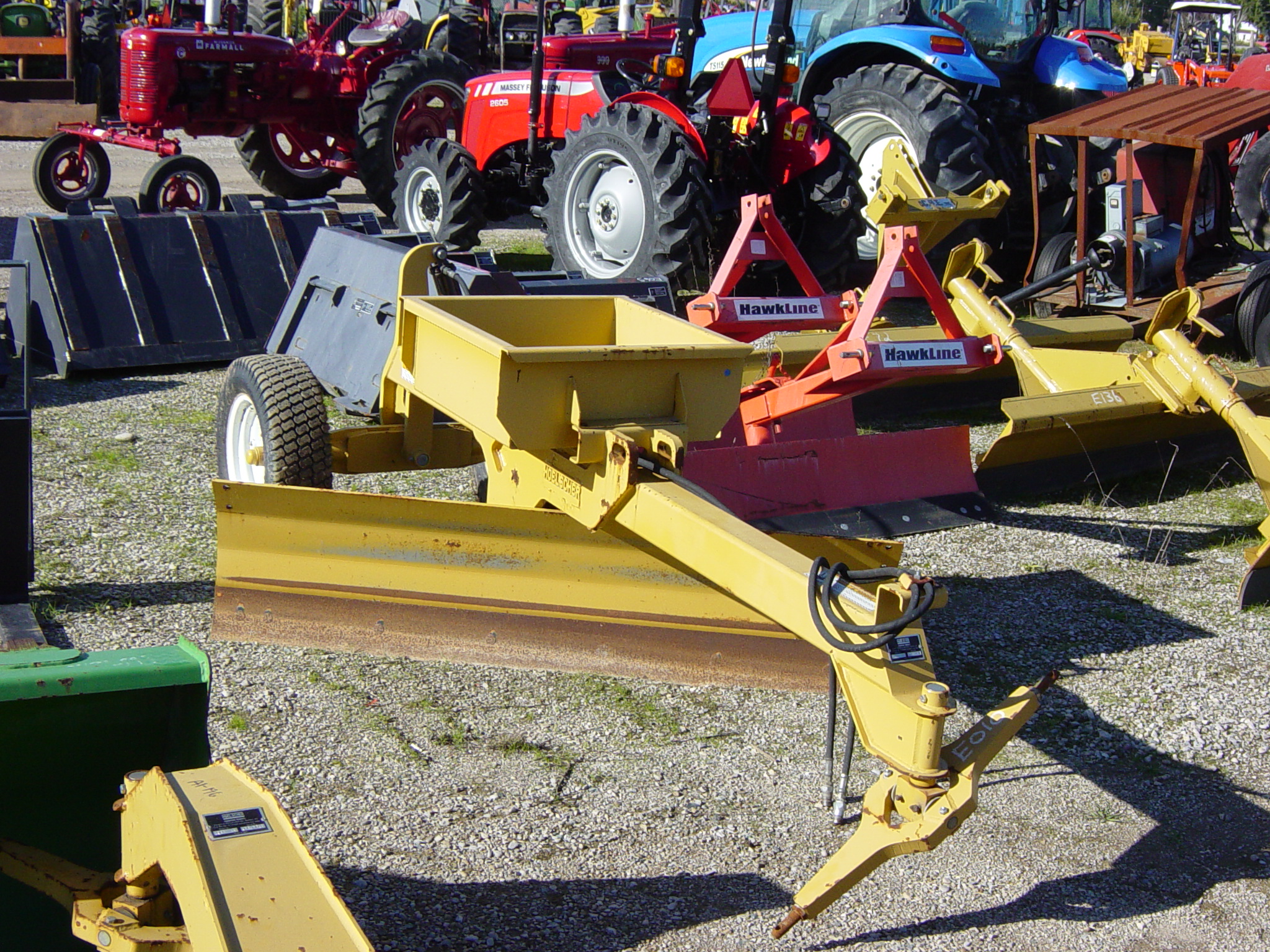

I think ovszd has it right. My theory is that you would be building an elongated trailer (implement caddy) with a elevated hump in the middle to accommodate a 3pt implement. Ahead of the implement, you have a "remote" set of 3pt arms and a top link. It would move your rear blade (or box blade, landscape rake, etc.) in the same manner as when hooked up to your tractor 3pt linkage.
You would adjust the angle of the blade / (left to right) by removing the pin on the back of the blade and swiveling to the desired angle.
You would adjust the tilt of the blade ~ ("ditching or crown") by lengthening or shortening the 3pt lift arm. (your rear blade may also have its own tilt feature)
You would adjust the "caster" (blade leaning forward or backwards) to a limited degree by lengthening or shortening the top link. My experience is that this isn't so critical for our purposes.
You would put a horizontal drawbar across your tractor 3pt arms, and that is how you control the height or aggressiveness of the cut of the blade.
In other words all the blade adjustments except height are replicated with the 3pt arms built into the implement caddy.
If you don't like manual adjustments, you could replace a lift arm and top link with hydraulic cylinders. I find when I have the angle and tilt set on my pony grader, I seldom have to change them. Having the blade in the middle of a longer wheelbase is where the magic happens.
If I were building, I'd use the 3pt as you suggested to raise/lower the tongue. I'd also hydraulically raise/lower the rear wheels. This would give me much greater height variations of the blade.
I'd also build a side to side tilt cylinder into the system and that's how I would raise/lower either end of the blade to get "cut" where I wanted it. This also allows me to "level" the blade side to side.
I'd stretch the wheelbase as far as I logically could. As you say, that's where the magic happens.

The main reason I was thinking of the pull grader rather than using anything 3pt was the increased length of it reducing the up-down effects of the tractor that is exaggerated with a 3pt mounted implement. I've got other grading/leveling tasks where it would be beneficial also...Much more so than another LPGS.
With having looked at some of the pics and links you guys posted, I'm heavily leaning to option #2, a knock-off of the HyGrade or similar. The 3pt carrier will be more work than I'm interested in. I've got 3 remotes to work with so presumably with wheel lift, blade angle and wheel tilt I should have all the adjustment I would need right? I'm not concerned with steerable wheels to offset it. As far as blade angle is concerned, they all seem to go 45 deg. Is there any advantage to going further than that, say 60 deg each way?

With my pony grader I generally have the angle set at between 35 and 45 degrees. Any more than that, and it throws the rear wheels sideways. Besides, you want it to drag the dirt forwards as much as sideways.
I think your design will come to you when you start laying it out. You might want to make a rough mock up out of wood before you start cutting and welding steel. BTW a set of old loader arms would make a good frame. As a frame of reference, my Pony grader measures 9 feet from the front hitch to the rear axle. The blade is smack dab in the middle.

When I stop to think about it, that makes some sense on the angles. I guess it depends on how much weight you have over the rear wheels if it's going to push or not. An old loader frame is not a bad idea, especially if I can find one that still has a couple cyl on it.
Got a pic of that grader or is it the one you previously posted on the first page? 9' is a good reference for length. I was thinking 10' - 12' without having done any measurements. If I used my existing 7' RB as a starting point, I figured I'd need to be at least that long to get it further back than it is now.
/ Pull type Grader? #31
The previously posted pic is my pony grader. I can post more pics or give you more specifications if/when you like. I have a rear blade, a box blade, a road drag (like a lpgs) and the pony grader. The pony grader is the best tool for sculpting. The road drag is the easiest tool for maintaining (video below).
I think if you could find a cheap set of loader arms, your work is half done. A solid rear axle from a FWD car could be your axle and wheels. Then it's just a matter of figuring out how to attach your rear blade (If you didn't want to fab up a full 3pt linkage, you could just weld a couple of ears [] on a cross piece and slide pins through that and your implement hole). Figure out wre and how to mount your hydraulic cylinders and you have version 1.0 done!
