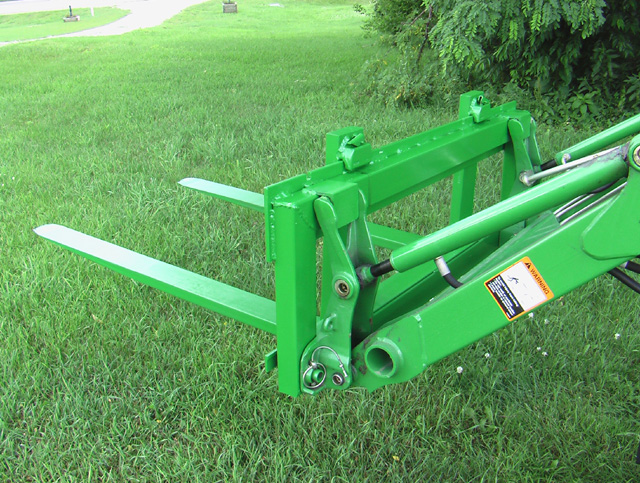

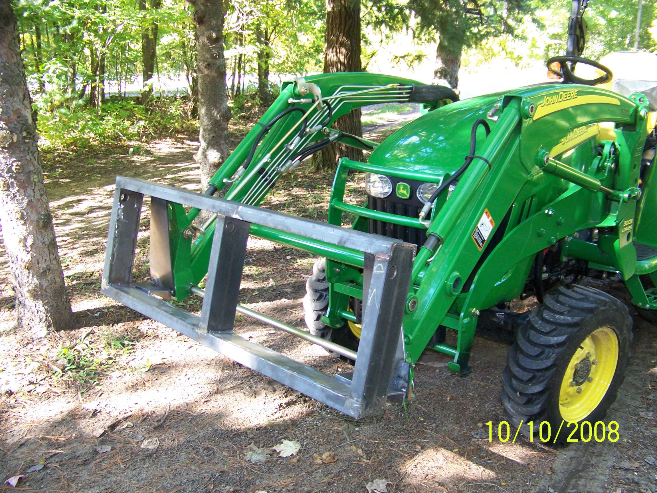

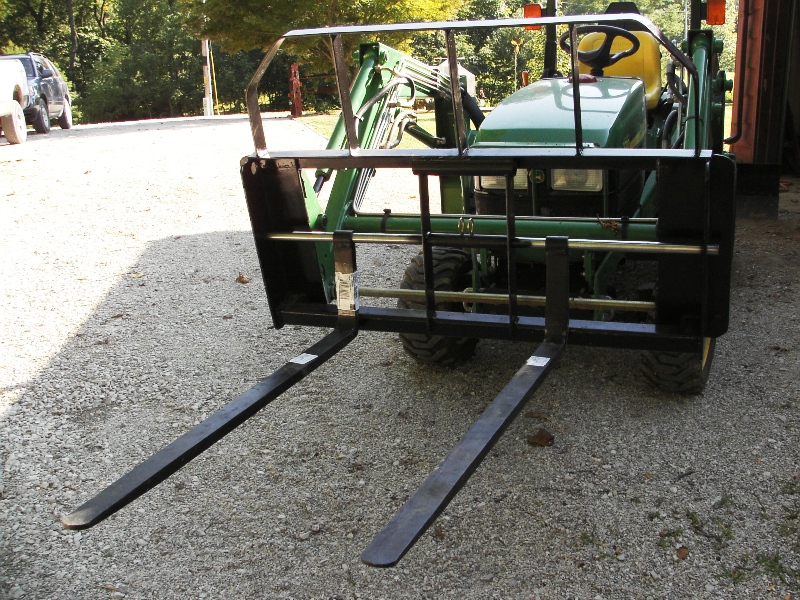

my dilemma is that I don't know if I should go with 36" forks or 42" ones. I am going to buy the fork tines new on line from some dealer, (any suggestions)
Dale,
I also have a 2320 and decided that forks would be a nice addition so here's the setup I built a couple months ago. They are close to 48", I may cut them down but I like the fact they are long. As far as where to purchase, I can only suggest trying what I did. I went to a Lift Truck repair facility and asked if they had replaced any forks recently, they showed me their scrap steel hopper which had 3 or 4 sets. I picked out a set and asked how much, to my great surprise :eek: they said just take them, which I did!:)
Rick

   / tractor Forks help #26

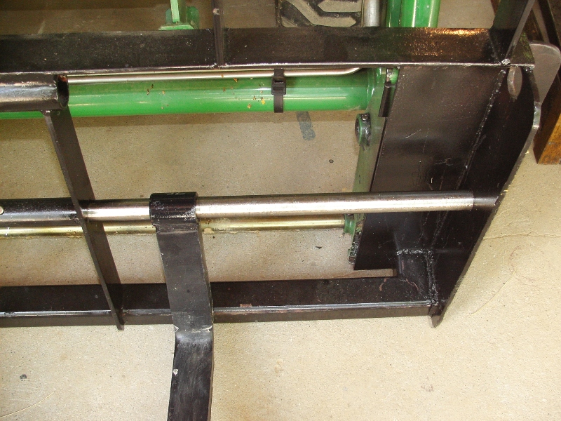

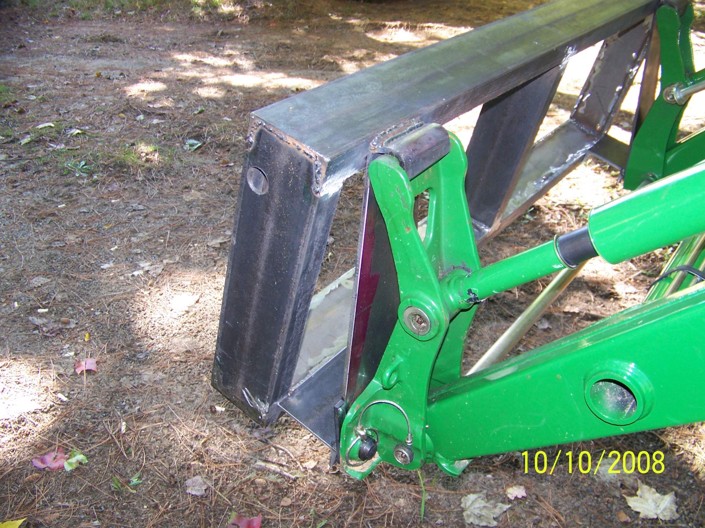

Hear are the forks i built for my 3320 .I used 4" channel&3&1/2" x3/16 crs for filler per Sherweld,s drawing .I have lifted over 800 lbs sofar with no problems. all done with a lincoln 3200hd 110 volt mig welder

   / tractor Forks help #27
Very nice Shadow! You have some nice features on that- I really like the way you did the QA plates, and the joints on the channel look superb!
   / tractor Forks help #28

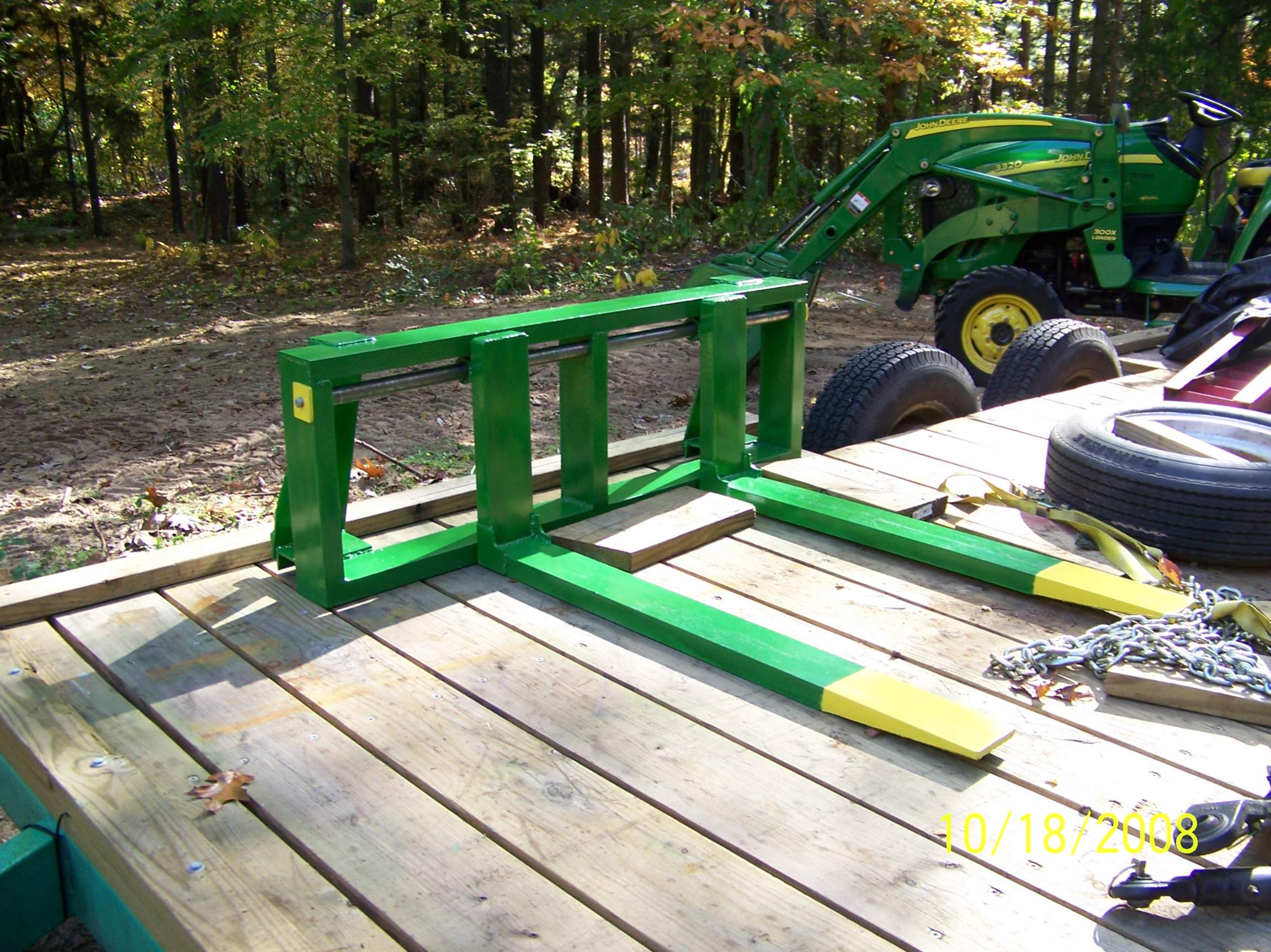

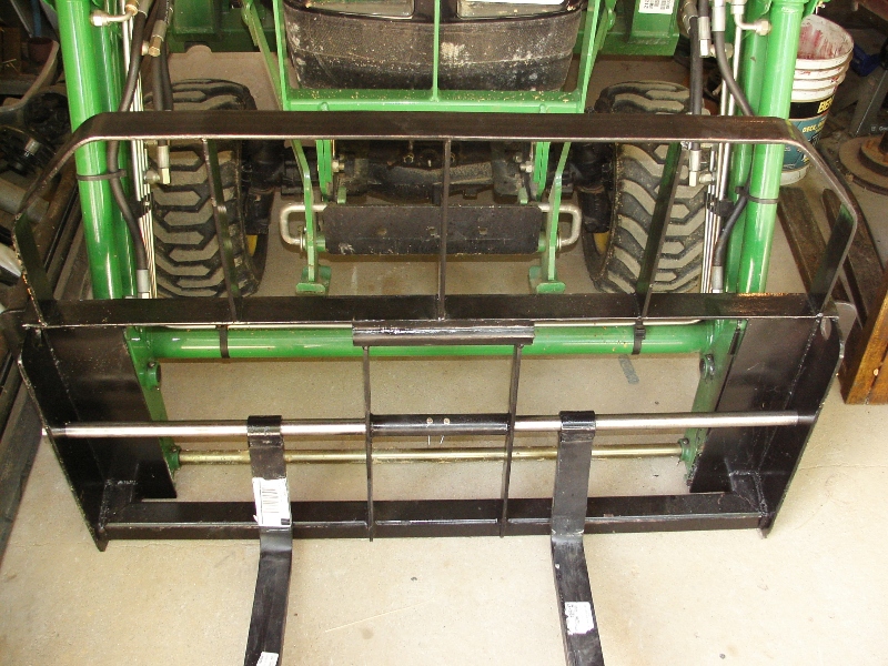

I made this set with the same 42" forks from Budget. I agree with buying the top QA's (I fabbed mine) and using CAT2 pins for the bottoms.
Mine come in at 143 lbs total.I haven't had trouble with strength and I've used them pretty hard.
Good Luck, You'll love having forks!

Got to love yellow fork tips!:D
