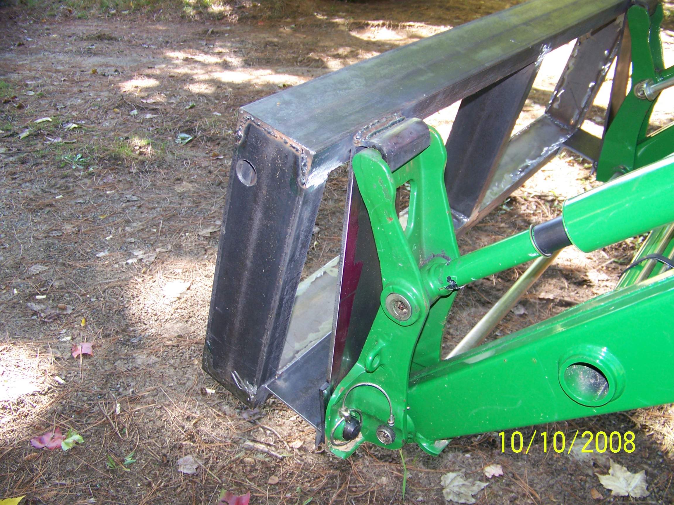

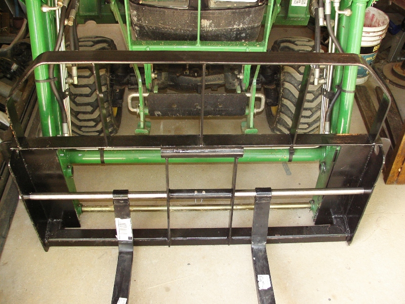

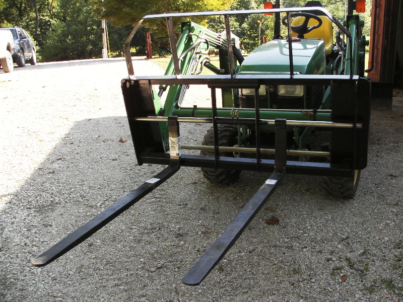

/ tractor Forks help #26
Hear are the forks i built for my 3320 .I used 4" channel&3&1/2" x3/16 crs for filler per Sherweld,s drawing .I have lifted over 800 lbs sofar with no problems. all done with a lincoln 3200hd 110 volt mig welder

/ tractor Forks help #27
Very nice Shadow! You have some nice features on that- I really like the way you did the QA plates, and the joints on the channel look superb!

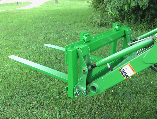

/ tractor Forks help #28
I made this set with the same 42" forks from Budget. I agree with buying the top QA's (I fabbed mine) and using CAT2 pins for the bottoms.
Mine come in at 143 lbs total.I haven't had trouble with strength and I've used them pretty hard.
Good Luck, You'll love having forks!
