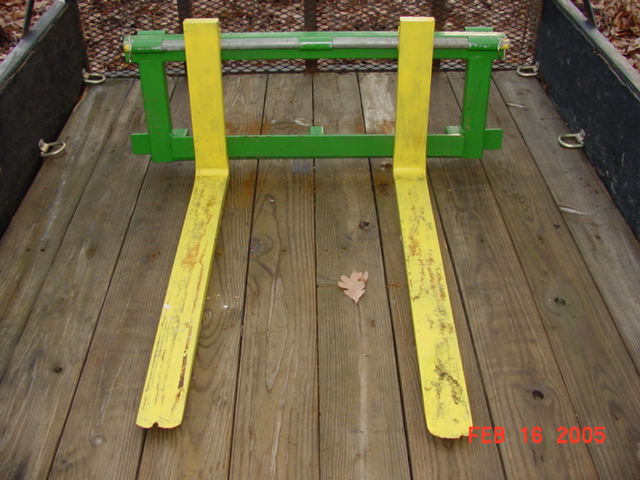

I bought a JD 2320 this summer with a 200cx loader, and am now also wishing that a set of forks for this machine might come in handy for odd jobs around the house, my dilemma is that I don't know if I should go with 36" forks or 42" ones. I am going to buy the fork tines new on line from some dealer, (any suggestions) My John deere dealer wants about $850 dollars for a complete set up that will be a quick change with my loader bucket. I figure that I can build it for a lot cheaper and exactly what I am looking for. Since I am a Shop teacher and teach welding....I have the place to build this this winter. I only want to be able to pick up pallets with fire wood, or wood pellets. I am also thinking of build a new building to house my tractor and all it attachement and the forks would come in handy for lifting materials when I am building. I realize that the capacity of the loader is around 1000 pounds, therefore I don't need huge fork tines. I want to keep the fork assembly as light as possible so I can lift more things. Any ideals suggestions or pictures would be greatly appreciated.....I live in Caribou Maine and We just got 6" of snow this morning.....!!!

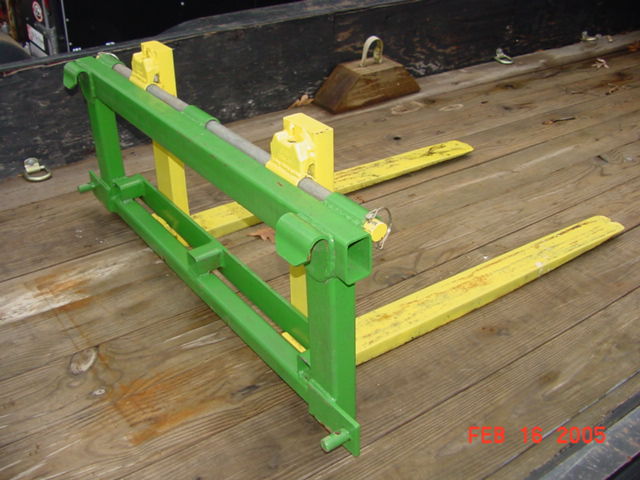

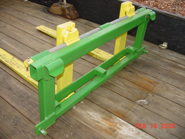

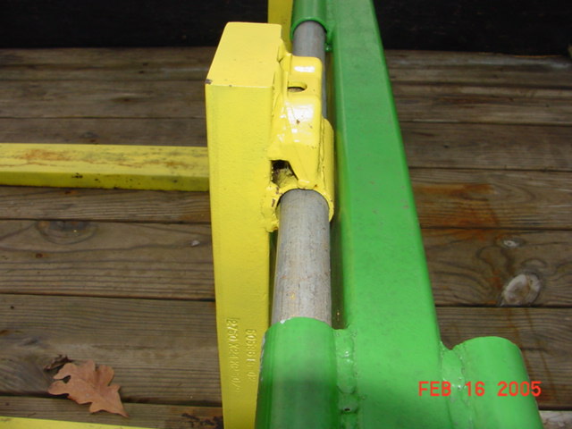

I built mine from 2x3 box and some 1" round bar. I got the forks(42") from a local forklift company for $100, they where "out of spec" for forklift use. The hooks and pins for the JD QA system are available from JDParts for about $35.00.

I would go for the longer ones as they come in handy for bulky stuff like brush handleing etc. or larger but lighter pallets.
Kenny did a great job on his, those one piece forks would be the perfect size to start with for a custom build.

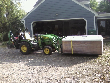

I got a set of Frontier forks for my 2320. Dealer only had he 48" forks in stock so that's what I got. I am not sure how much lighter the shorter forks are but the longer forks have come in very handy.

For the bottom pins I used catagory #2, 3 point pins that have the threaded stud. The shank is about 2 1/2" long is already tapered on the end and is drilled for a snap pin. I drilled a 1 1/8 hole and welded it in from the back side of the mounting plate then cut off what was left over. These were about $3.00 each at Farm & Fleet. I wish I had looked for the top hooks in parts instead of forming my own.

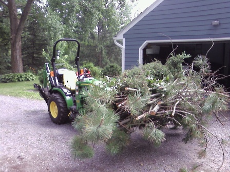

I just built a set of bucket forks for my Kioti CK35. I think my next project after my brush rake will be a regular set of forks.
After a trip to the scrap yard I came home with 300lbs of rectangle and square tubing, some flat stock, some channel and a long piece of 1 1/2 steel rod. Scrap prices are down, (25 cents per lb) so I paid $80 for everything.
My forks probably weigh about 200lbs, which is a little more than I had planned on, but this also includes where I reinforced the bucket. The tines are 2x3 tube, 1/4" wall. The verticals that attach to the tines are 2x4 tube, 3/16 or 1/4 wall (I cannot remember at the moment.) These attach to the steel rod, and that attaches to the reciever hitches mounted on my bucket.
I hadn't planned on using so much 1/4 inch metal, but I found two pieces that were perfect in size.
I still have enough metal to almost finish the brush rake, so the real price for just the forks would be about $60, including the reciever tubes i bought for the bucket. Took about four hours to build.
My camera is busted right now, but I'm hoping to get photos soon.
