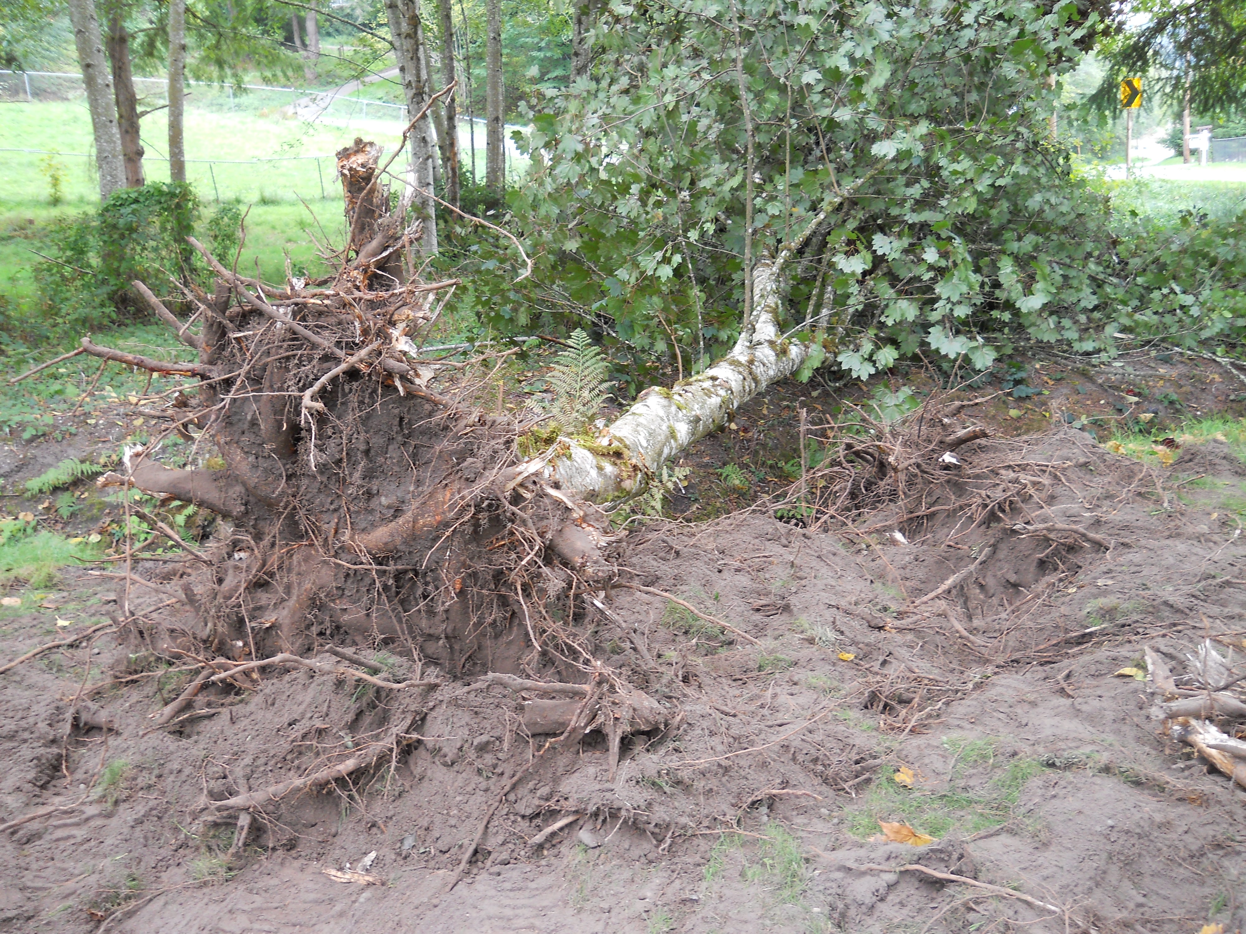

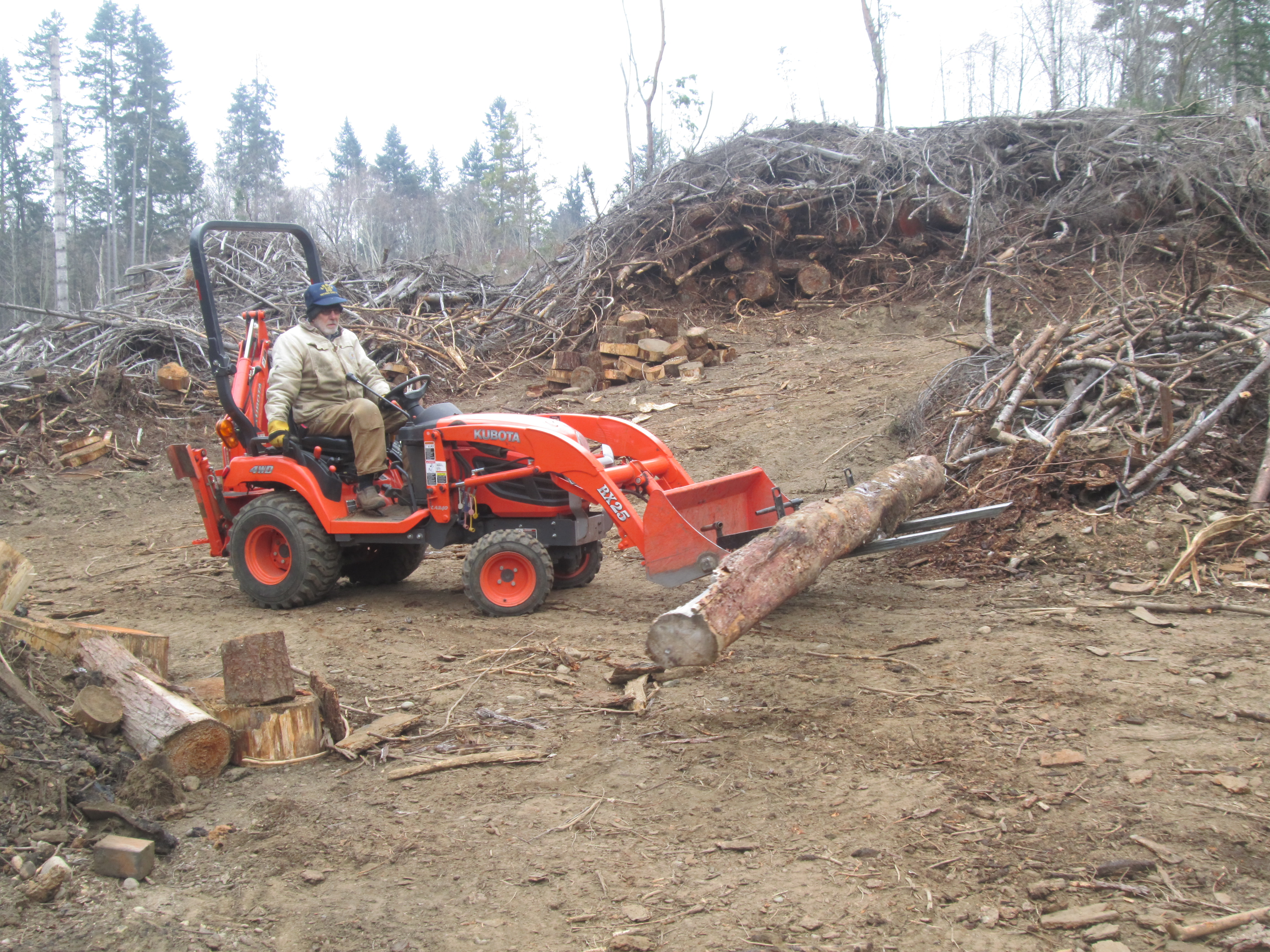

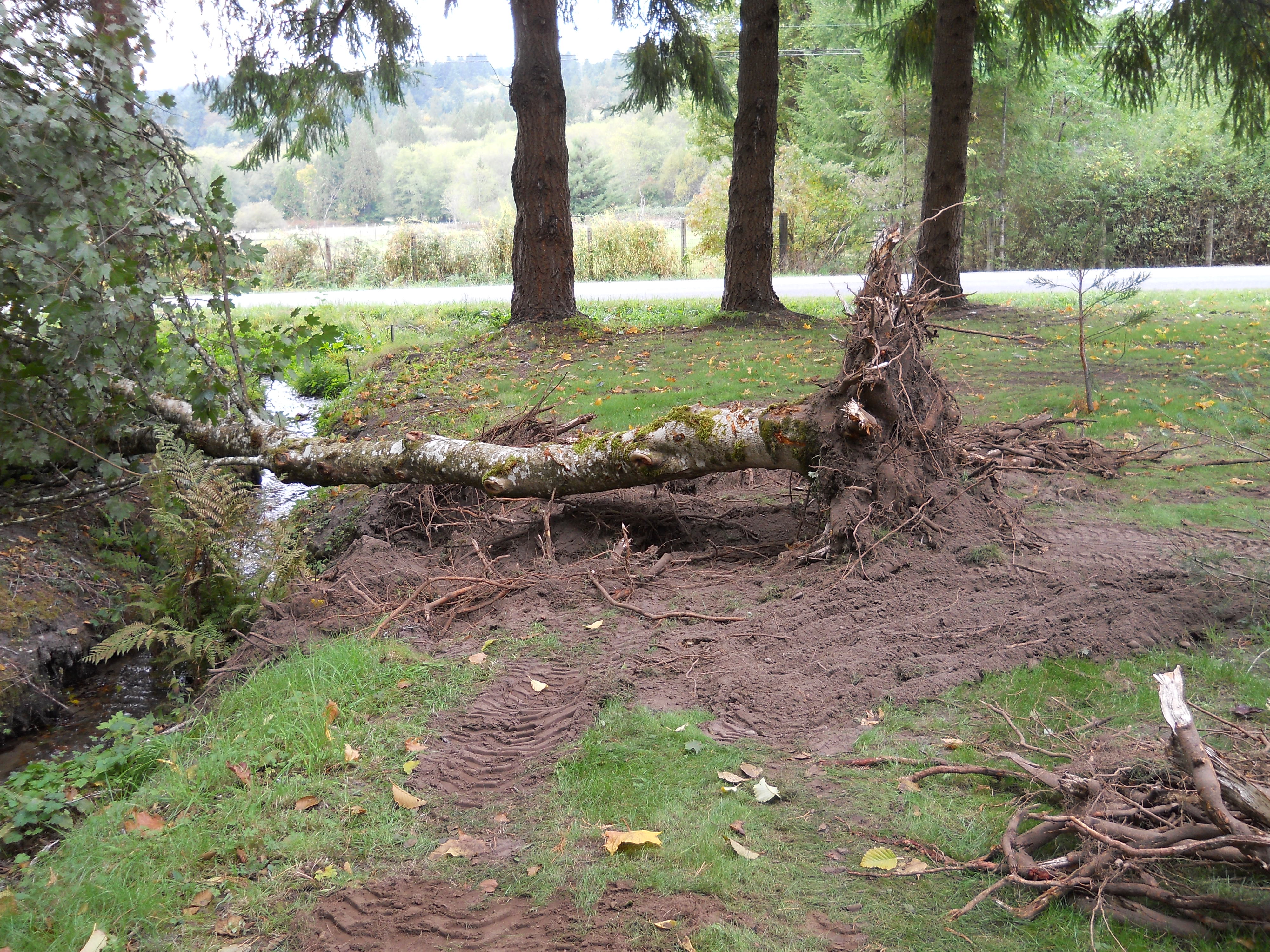

Doc, a BX23S is also a great machine for working in tight places, close second choice along with the B26. I have a BX25 and real pleased with the 1500 hours I have put on it since 2011. Here are some pictures of my BX at work with tree stuff. I moved that Madrona log over 100' mostly sloped ground to the cut up area. It was part of a 15 Ac logging slash pile on a side slope we gleaned 30 cords of wood out of summer/fall a year ago. The tree is a 10" trunk maple. They have massive root system, moved the whole tree across a creek with the BX. The new BX 23S has an option for a skid steer type FEL assembly that has a forklift attachment and a light weight grapple that will not consume all your lifting power. Worth looking into closely and price compare with the B26. Those options are also available for the 26.
DSCN1211.JPGDSCN1210.JPGIMG_0404.JPGIMG_0409.JPGIMG_0418.JPGIMG_0404.JPGIMG_0409.JPGIMG_0418.JPGIMG_0404.JPGIMG_0409.JPGIMG_0418.JPG
Ron

I have loaded many dump trailers with my BX25 FEL. For the high sided ones I just put down some blocks to get another 6-8" and cleared them fine.
Ron
