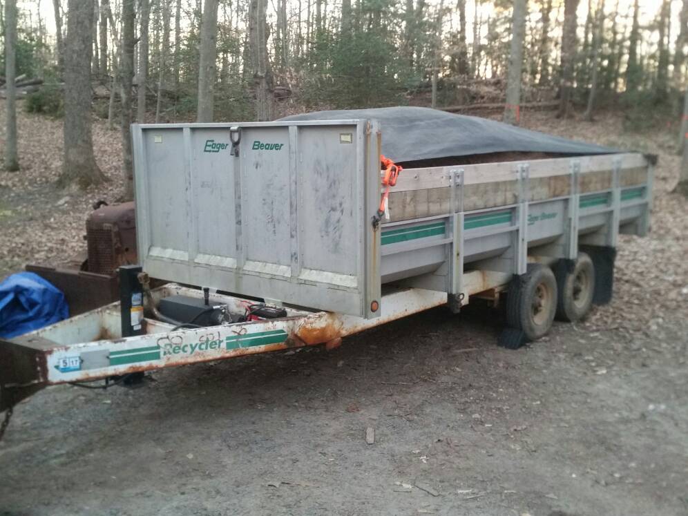

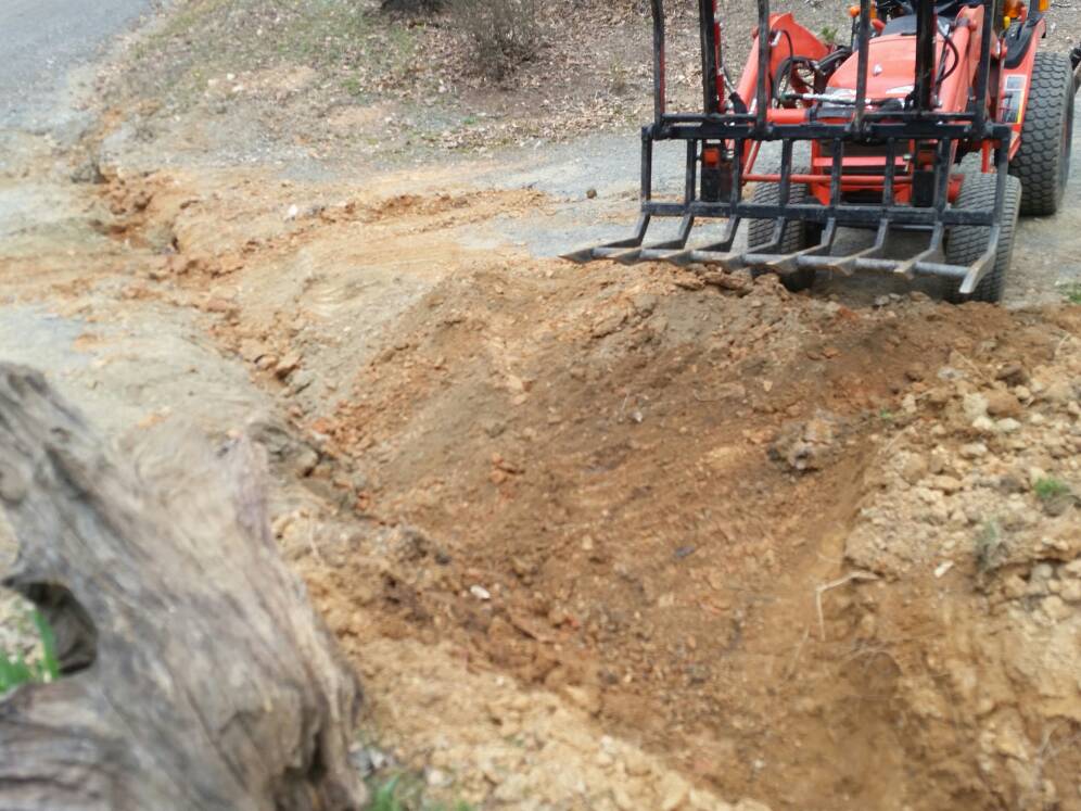

I have a B2620 (predecessor to the B2601) and do similar to what you described in your post. I have a 50in root grapple that stays on most of the time and use it to clear/clean up a few properties and do selective clearing in the woods (one customer calls it German forestry). I keep thinking I want a bigger tractor but in the woods and on residential properties it's nice to have a smaller tractor that can maneuver through the trees with a 4ft bush hog.
I wouldn't get too hung up on the listed specs for the loader on the Kubota, I do have my hydrulic relief turned up about 200psi over stock but I also have a pin style quick attach that pushes the grapple out further and have never really had a problem lifting even 3 5ft x 12in oak logs at a time. I think kubota is one of the more conservative on their lift numbers.
Lift height to me is more important as I have a deckover dump trailer and loading brush can be a pain when it's heaped.
I run turfs with slightly wider tires then stock on the front to help with flotation on softer lawns.
I think the B2601 would be a good fit for what you described unless I missunderstood and you need to lift large mill length logs or huge rounds constantly.
The only tractor I think I would trade for right now would be a B26 for the added lift height and capacity (position control would be nice too, the B2601 has that also) but the cost is more then I can justify, the B2650 might be a good option as it has about 6in more lift height and I couple hundred more lbs loader capacity with a slightly larger wheelbase and engine.
I'm sure any of the tractors you listed would be fine, I just mention Kubota because I know more about their specs an have first hand knowledge, I've looked at other tractors but always came back to Kubota.
Here's my grapple/tires setup 20160325_100045.jpg
And the dump trailer, I can load it but can't dump the grapple all the way over the side, I really want a clam shell grapple for loading brush as it should solve some of the loader height problem.

Here's my grapple/tires setupView attachment 520171
