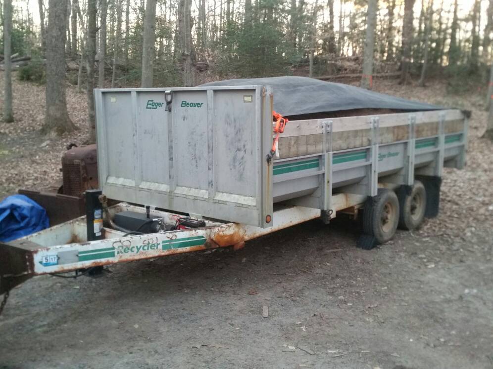

I looked for a good bit and most 6ft wide dump trailers stopped at 10' and the majority of 12' long were 7' wide but I did find a couple 6' x 12' to grab some rough numbers on and the trailer Tare Weight was ~2500 lbs and up.
So now you're looking at 5084 lbs without any implement weight (i.e. whatever mower you pick). You also have to factor in the weight of ALL your other gear, tools, saws, fuel, etc into mix.
You have 6400 lbs towing and 11360 lbs Max Combined with a truck that comes in at 4400 lbs and change depending on model & cab config.
To translate all that technical mumbo jumbo to simple English - you're pushing the limits of your trucks abilities and, safety issues of that aside, you're going to cause it to wear out components faster.

Also dump trailers are really heavy for their size and it will eat up your towing capacity. I have a 12k, 12' and it goes 3200lbs empty. Love the trailer but it is not light but if you want them to last they need some steel in them.

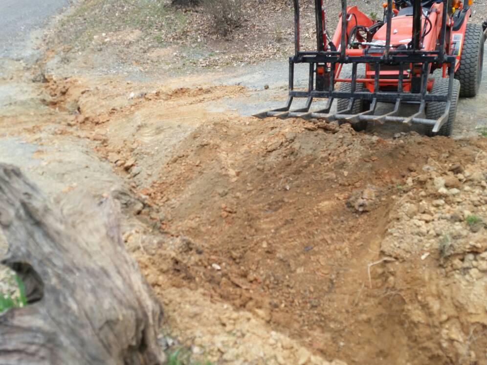

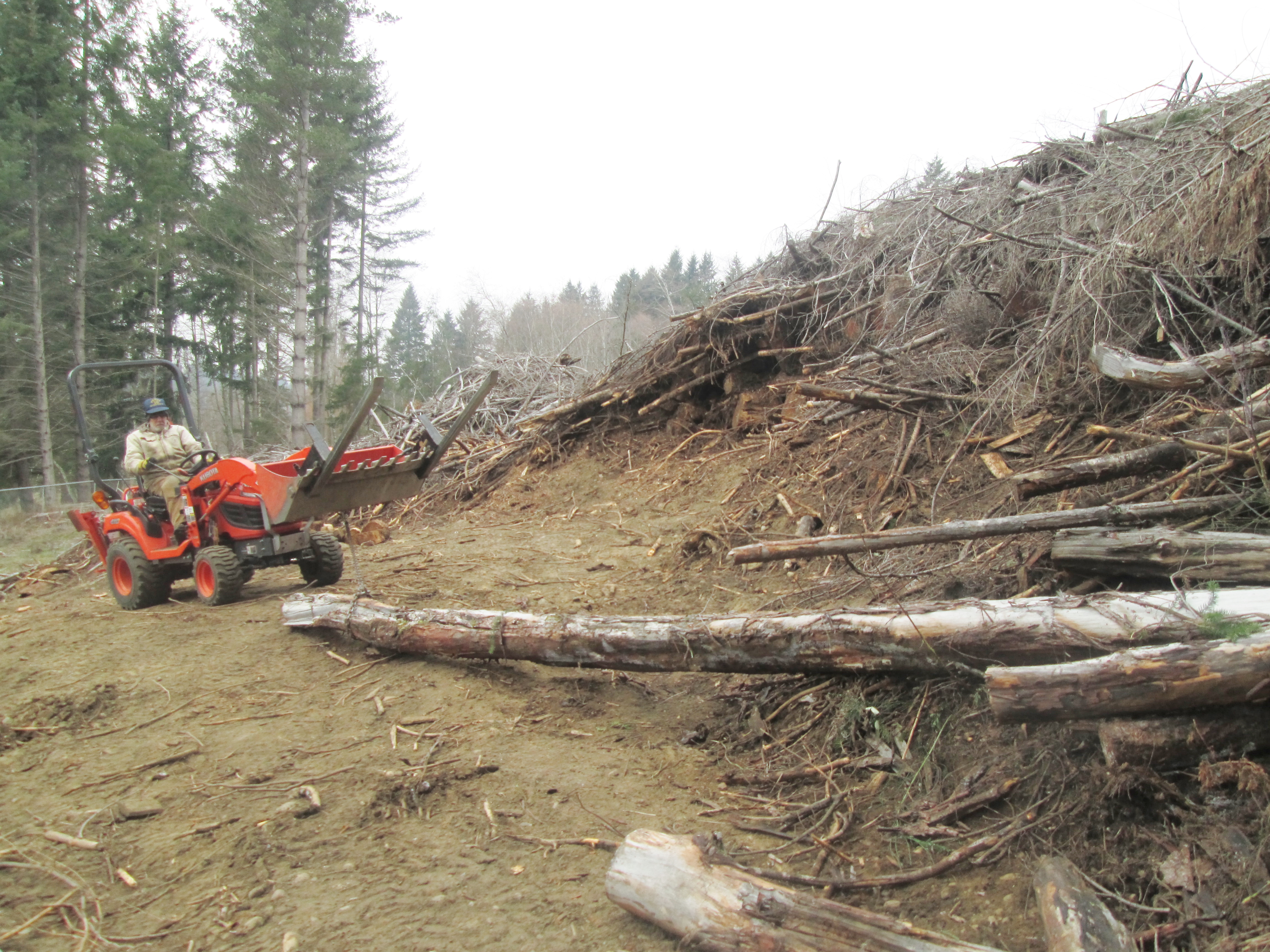

Doc, a BX23S is also a great machine for working in tight places, close second choice along with the B26. I have a BX25 and real pleased with the 1500 hours I have put on it since 2011. Here are some pictures of my BX at work with tree stuff. I moved that Madrona log over 100' mostly sloped ground to the cut up area. It was part of a 15 Ac logging slash pile on a side slope we gleaned 30 cords of wood out of summer/fall a year ago. The tree is a 10" trunk maple. They have massive root system, moved the whole tree across a creek with the BX. The new BX 23S has an option for a skid steer type FEL assembly that has a forklift attachment and a light weight grapple that will not consume all your lifting power. Worth looking into closely and price compare with the B26. Those options are also available for the 26.
DSCN1211.JPGDSCN1210.JPGIMG_0404.JPGIMG_0409.JPGIMG_0418.JPGIMG_0404.JPGIMG_0409.JPGIMG_0418.JPGIMG_0404.JPGIMG_0409.JPGIMG_0418.JPG
Ron
/ Tractor For Tree Work #37
Ron
Just to clarify I was talking about the B26 tlb, price and performance aren't even close to the BX, the B2601 without backhoe is fairly close in price to a BX tlb.
I like the BX but it'll be a struggle to get over the side of a dump trailer and has less lift capacity, I wouldn't want to go less then the B for your application.

I have loaded many dump trailers with my BX25 FEL. For the high sided ones I just put down some blocks to get another 6-8" and cleared them fine.
Ron
Yes it will load them but but will limit what can be loaded and how much, I load brush and to make a worthwhile load it has to be stacked which is a struggle for the height with the B and the grapple. Rounds etc. are not as much an issue but when you're doing it as a business I would want to go as big as possible and still be able to meet the needs requirements of fitting in tighter places, weight etc.
When I bought my B i was thinking of getting the BX25 as I wanted a backhoe but reality was for about the same money I needed the added loader capacity/height and features of the B more then the backhoe.
When it's a business time is money, and larger tractors will move more faster as long as they aren't too big for the job.
I like the BX but I'm thinking it might be at its limits too often.
Some days working I wish I had a L and some days I wish I had a BX, but since I can't afford both I have a happy medium in the B.
