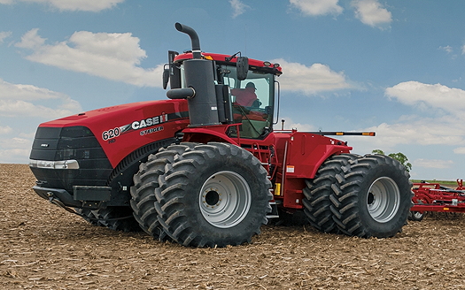

If that were true, you'd never see tractors like this in farm fields...
I was in the Palouse of Washington state last week and saw several of these 20,000 pound tractors pulling heavy Disc Harrows. But, really, how often are Big Ag tractors discussed in this site?
Seldom are tractors with anything but a Category I or Category II Three Point Hitch discussed here. The tractor in the photo you attached has a Category IV or Category V Three Point Hitch, if it has any form of Three Point Hitch whatsoever.

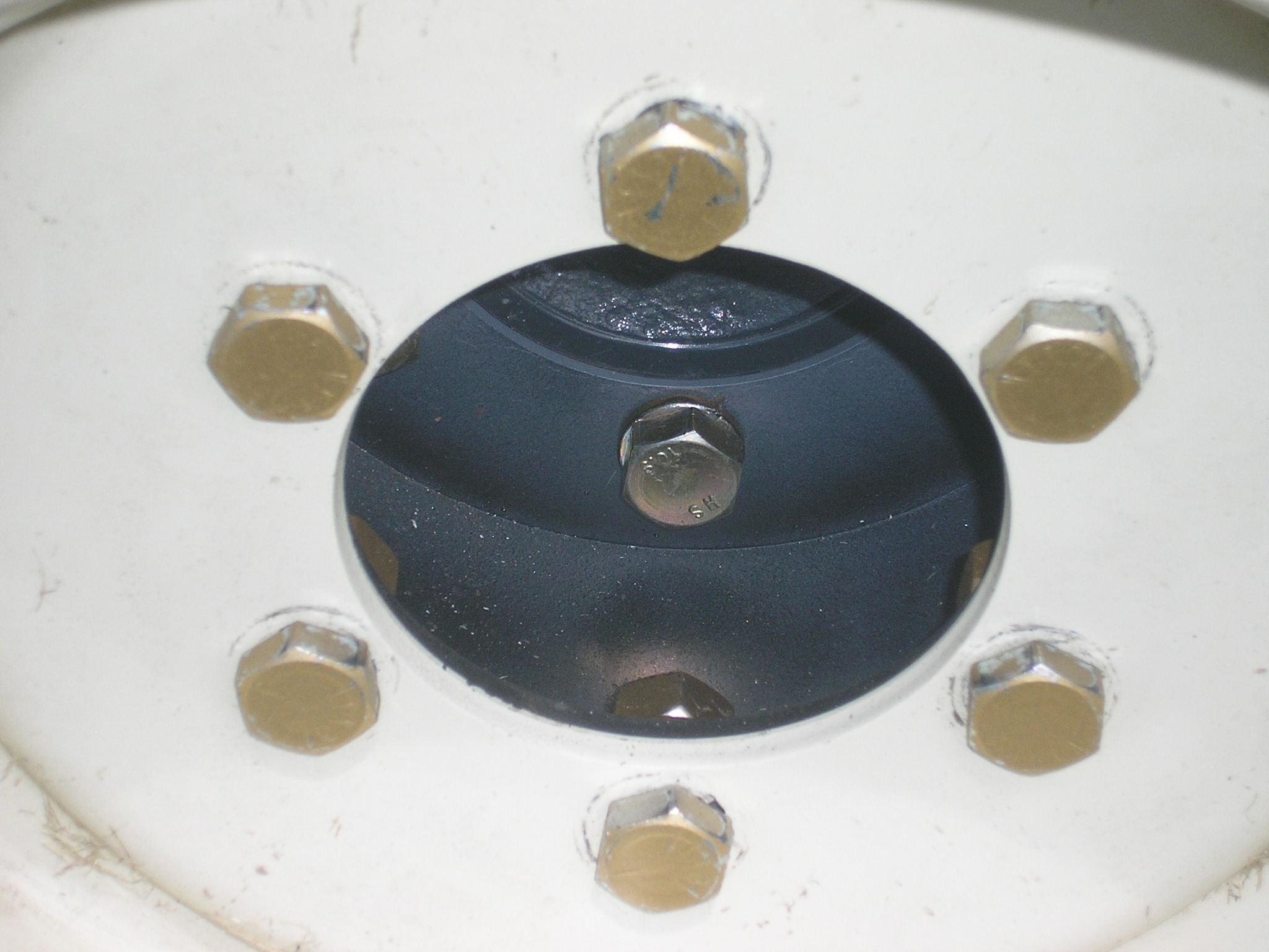

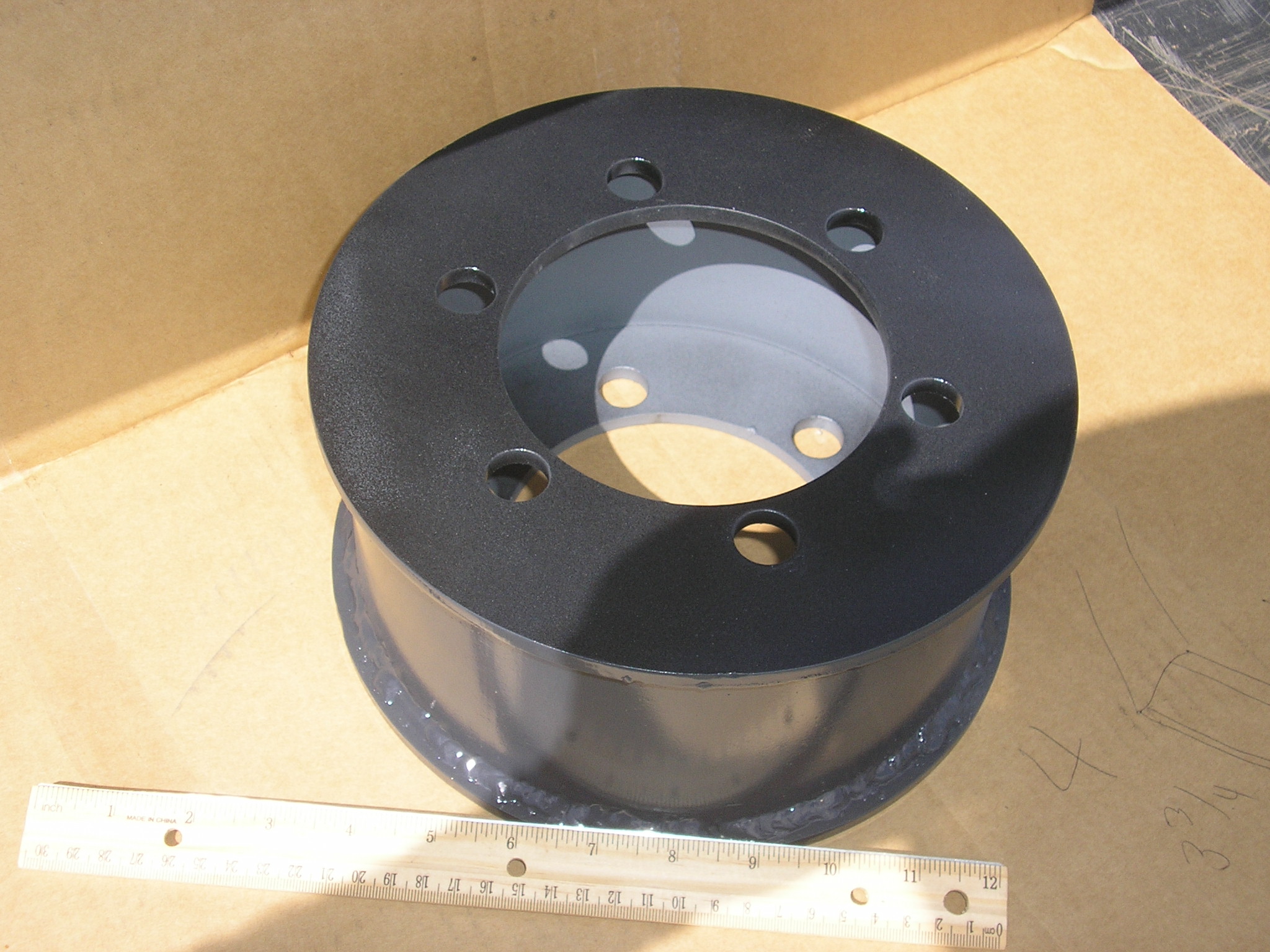

I don't like my tractors hydros but for your application I too will go for that as the better alternative. Other thing is make or buy spacers for the rears to assist in lateral stability. Here's what I made for my 2400 and the length was determined by my tires fitting inside the cutting dimension of my 5' rotary mower. The spacer is a piece of 8" steel pipe, the flanges are one quarter inch plate steel. I did the drawing and had a machine shop do the machine work on the plate and I did the rest. Cost was about 100 bucks.
