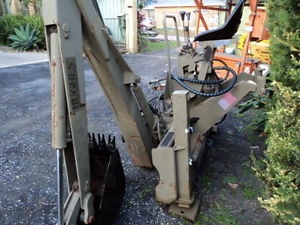

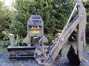

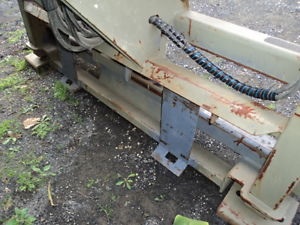

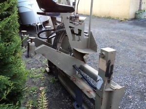

Hi BFreaky,
I hope you feel great when you are using your backhoe. Inspirational project, thanks for sharing.
I have just bought a backhoe attachment, ex-Australian army, never used and stored inside in a machinery warehouse for 10 years. But it's configured for mounting on a skid steer and I need to fit it to the rear of my 65hp tractor. So I have to fabricate a subframe for a rigid connection to my chassis.
If I am reading your earliest posts correctly, you made your subframe from 15mm mild steel with M16 high tensile bolts? Is that correct? Was this adequate? If you were starting over, knowing what you know now - how would you do it?
i've added some pics below, any advice you can offer is greatly appreciated,
Thanks, Gus

The chasis strenght depends on the weight of the BH. My backhoe weighs about 1.2 T . I've done some extreme testing pulling out concrete slabs, tree stumps etc and it is still flawless, so yes, for me 15 mm steel plates and M16 bolts do a good job. Try to find out the weight of your BH. It is also very important to make a frame that connects the front and back end of yout tractor. You most certainly don't wat to break you tractor in half...
