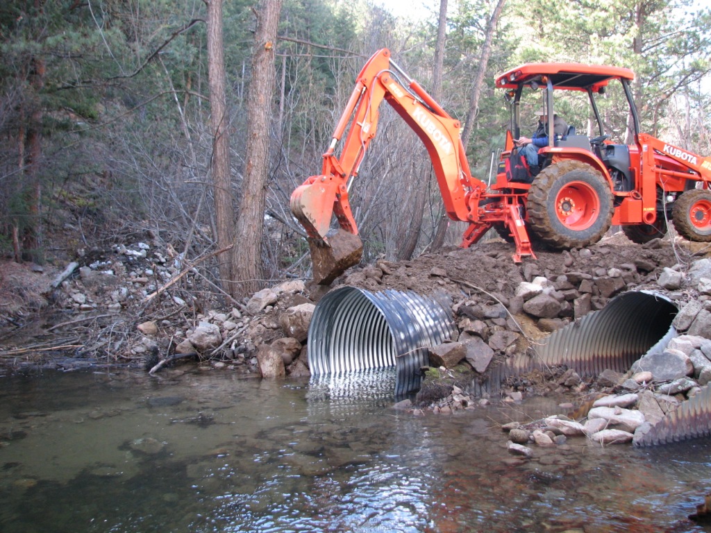

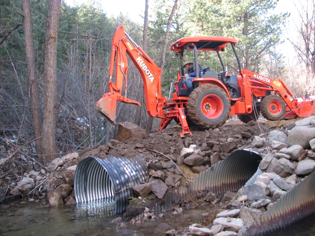

Yes, I think you are right. Possibly a piece of crud was caught in the control valve or bypass valve and dislodged by the backflow of fluid when gravity acting on the heavy assembly forcibly moved the cylinder.
No, no video and we are still under a foot or so of snow. Here's some pictures from a warmer time.

It looks very good, I'm sure it works good too. Can't wait to see some vids in action
