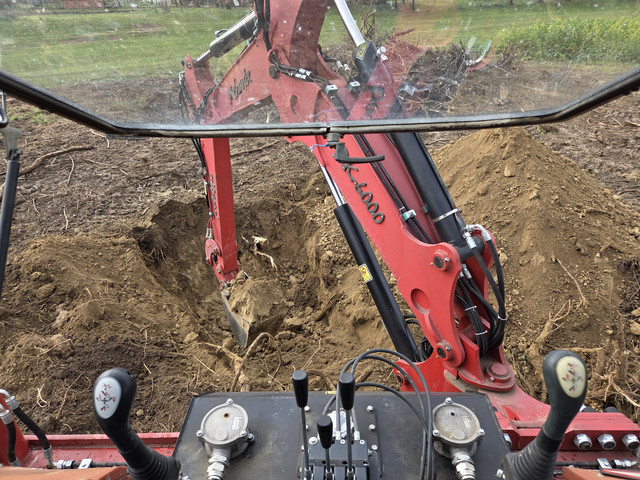

Made some upgrades; joysticks got direct link to distributors because cable control is waay to jumpy for this kind of machine. Also, hydraulic pumps are no longer mounted directly to the PTO shaft, that made coupling a nightmare because both pumps and gearbox weigh 36 kg so I had to lie down and mount it overhead...that's why I changed pump rotation, bpught different type of gearbox and turned it 180 to get some distance to use short cardan shaft.
upload pic
upload pic
Also added block valves to secure outriggers
upload pic
Cab view
upload pic
upload pic

#1,668
Yes, all the time. Triple boom is the best decision ever. You can extend it to reach far, and curl it to get as close as possible. Also if you lift something too heavy for your boom cy, 2nd cylinder will help
Close, max power
Reaching into the pit
Operator view

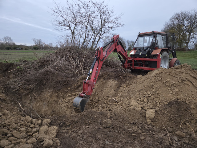

#1,669
Digging a hole to put all those roots and stumps inside. I have to make a bigger bucket to dig it faster. This is only 400 mm wide(narrow)

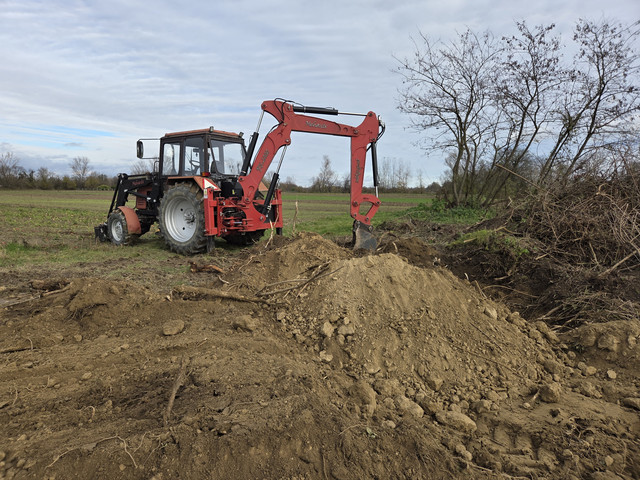

#1,672
And finally the last one, probably the biggest...took me half hour and another 15 min to dig a hole big enough to bury it at reasonable depth. The machine passed stress test, if this job didn't break it, nothing will. So now we have some 120 m2 of new clean land.
/ Tractor backhoe - homemade
#1,674
It's my brothers land, he plans to grow potatoes here because they like this kind of soil
