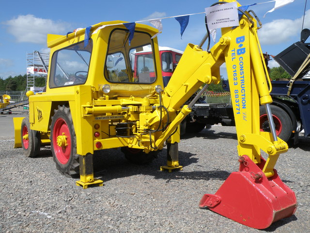

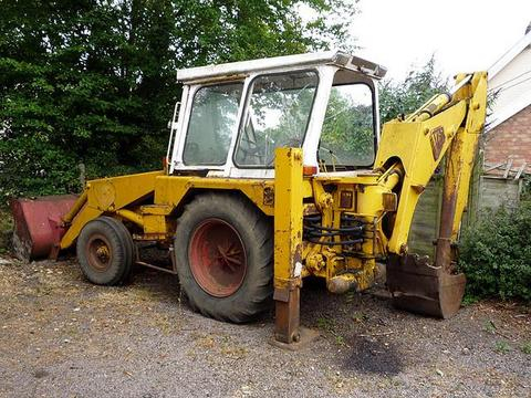

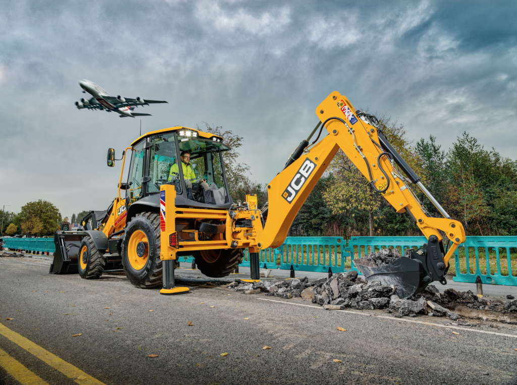

Your outboard stablisers mimics the design of the original JCB backhoe loader that is by far the most popular here in the UK.
I've not seen many other stabiliser designs on machines we get over here.
JCB series 1
Series 2D
and still used in recent models
