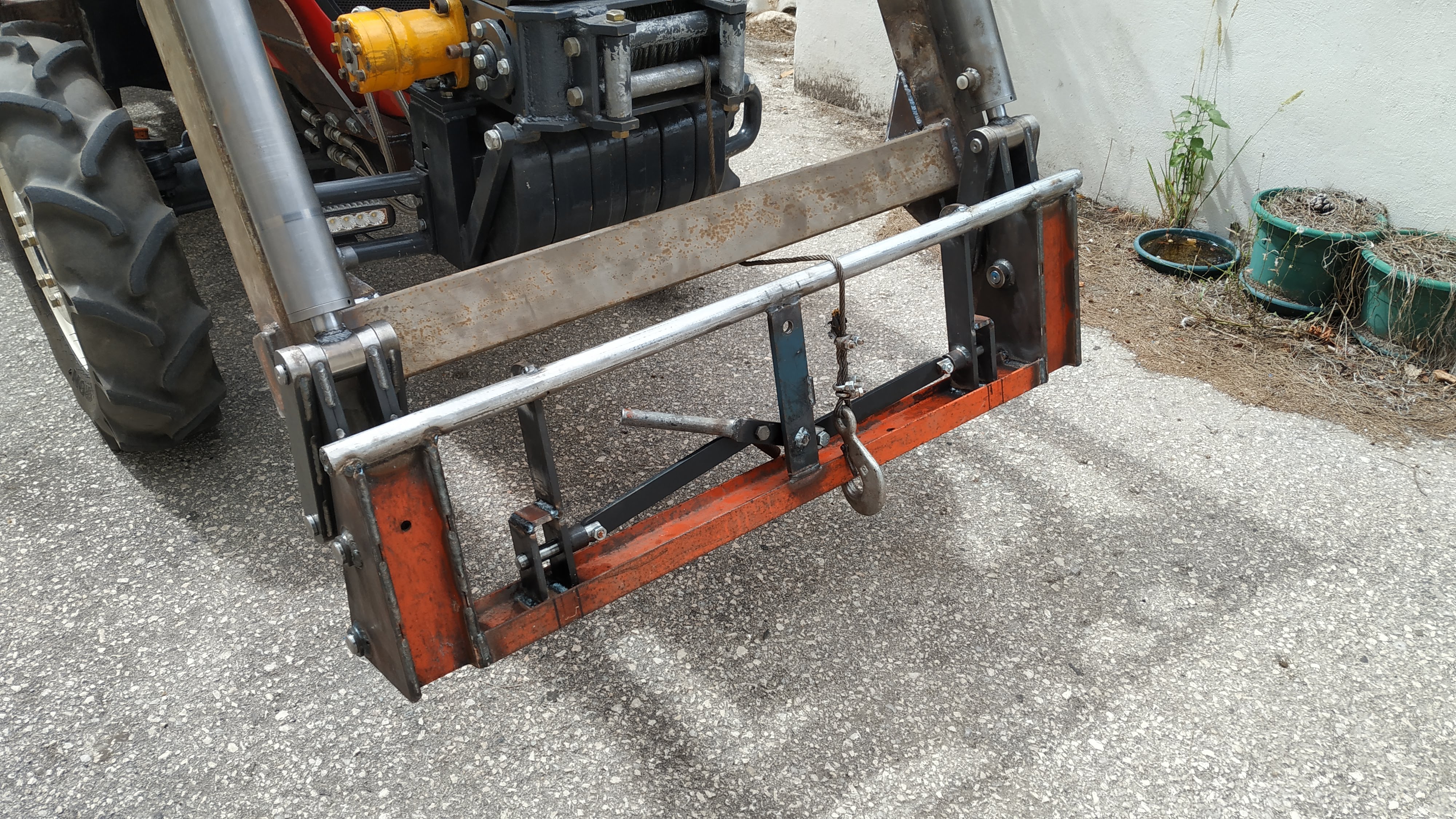

Made some upgrades; joysticks got direct link to distributors because cable control is waay to jumpy for this kind of machine. Also, hydraulic pumps are no longer mounted directly to the PTO shaft, that made coupling a nightmare because both pumps and gearbox weigh 36 kg so I had to lie down and mount it overhead...that's why I changed pump rotation, bpught different type of gearbox and turned it 180 to get some distance to use short cardan shaft.
upload pic
upload pic
Also added block valves to secure outriggers
upload pic
