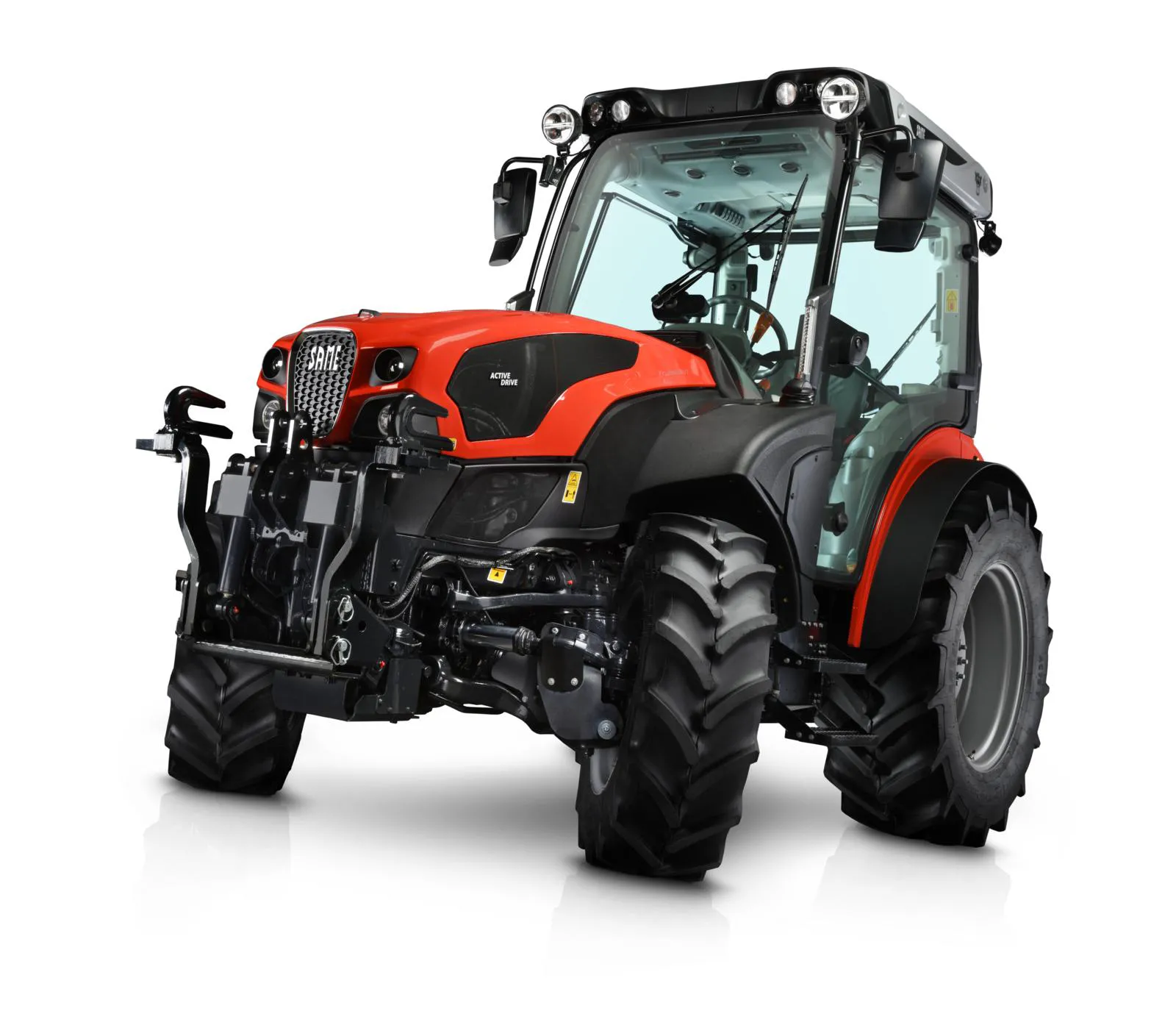

That tractor has brakes on all 4 wheels plus, any road legal trailer in Europe will have brakes above 1500 lbs gross weight.
In the case of the video, it will either have hydraulic brakes or air brakes just like a truck. Tractor is fitted with a complete air system for brakes and also the special brake valve in case of hydraulic brakes.
As far as rear suspension, there are some tractors with it but mostly rely on cab suspension and the bigger rear tires to absorb the shock. Front suspension is a lot more common, even on smaller tractors these days.
A bit hard to see but this one in the picture below comes with independent front suspension.
/ Tractor and Equipment Frames and Suspension #11
Can the suspension be locked out? Like if using heavy front attachments.
