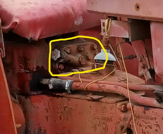

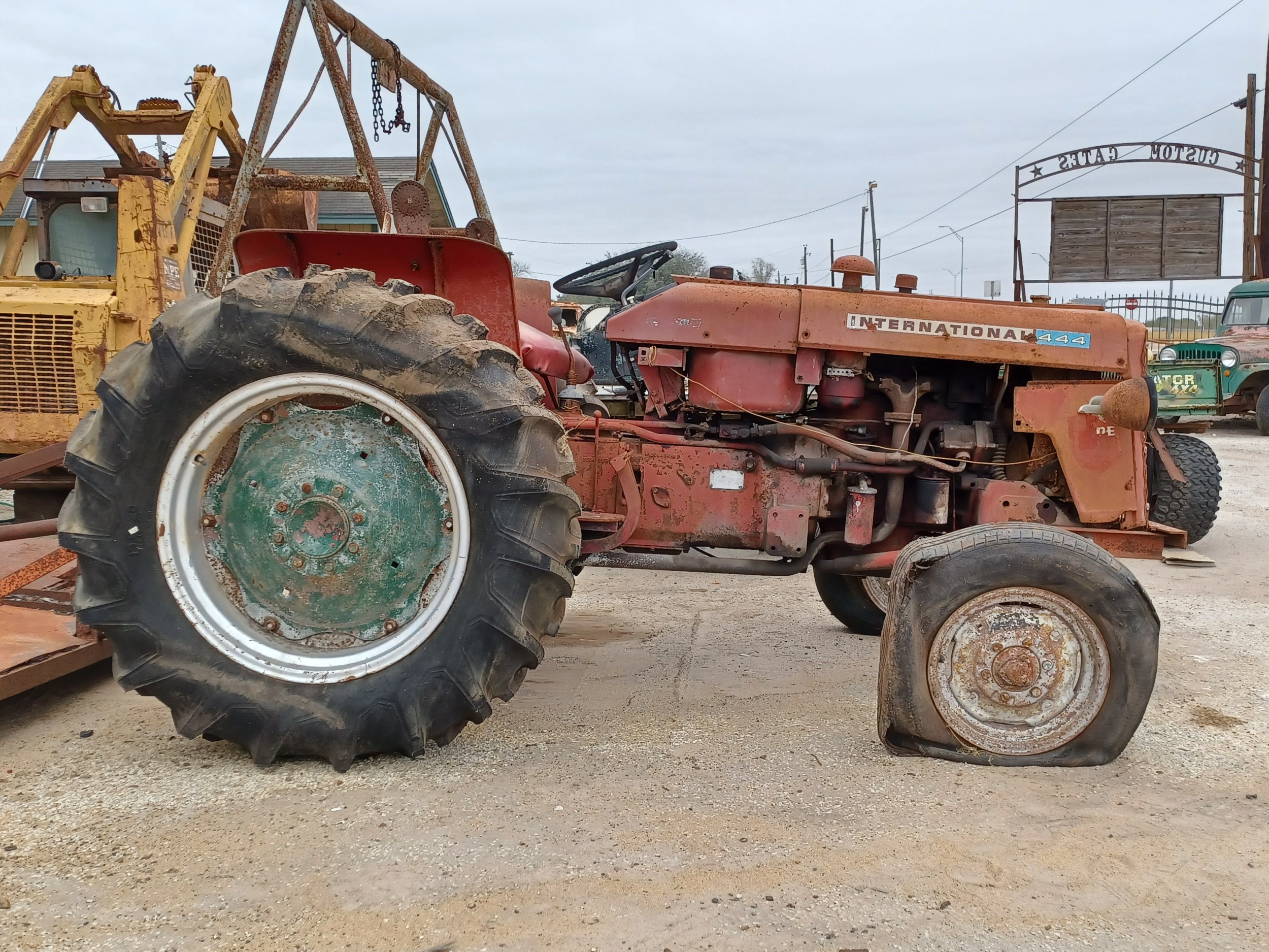

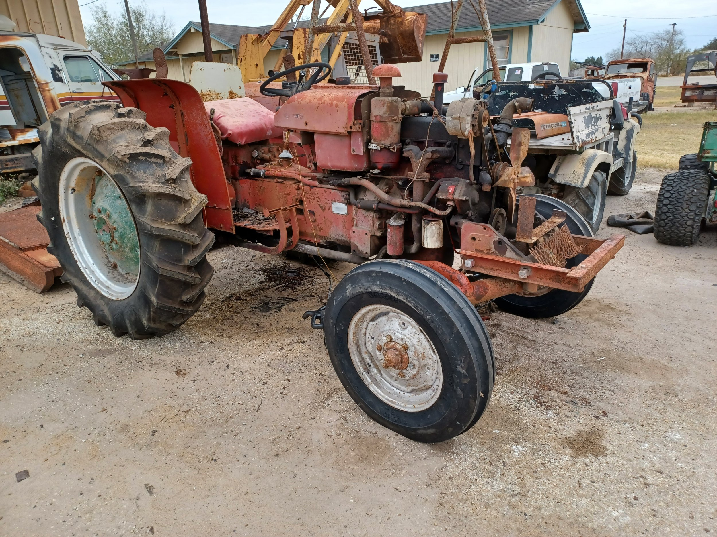

Moving right along. Got rid of the square tires and put some new round ones on. Been tied up on a Model T and a little shop lean to I'm building at the shop. I had found the motor was frozen from sitting and pulled the starter and injectors, filled up the cylinders with hydraulic fluid and diesel. After a while, I was able to break the rust ring and got it to roll. Let it sit a few days before going further.
Was a nice day today, so I got back on the tractor. Today I tried to start it and did. Topped off the hydraulics and my steering and 3 point lift is working. So, motor runs, steers, and lifts. Now if I can make the transmission shift, I can move on.
Looks like I will need to remove the hydraulic cut off valve housing to get to the back bolts on the transmission cover. (see picture with the yellow circle). Anyone know if there are anything to be carful with when pulling the hydraulic housing or the transmission cover. By the way, I bought it for $500. Thanks, for your help. Joe.

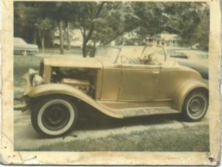

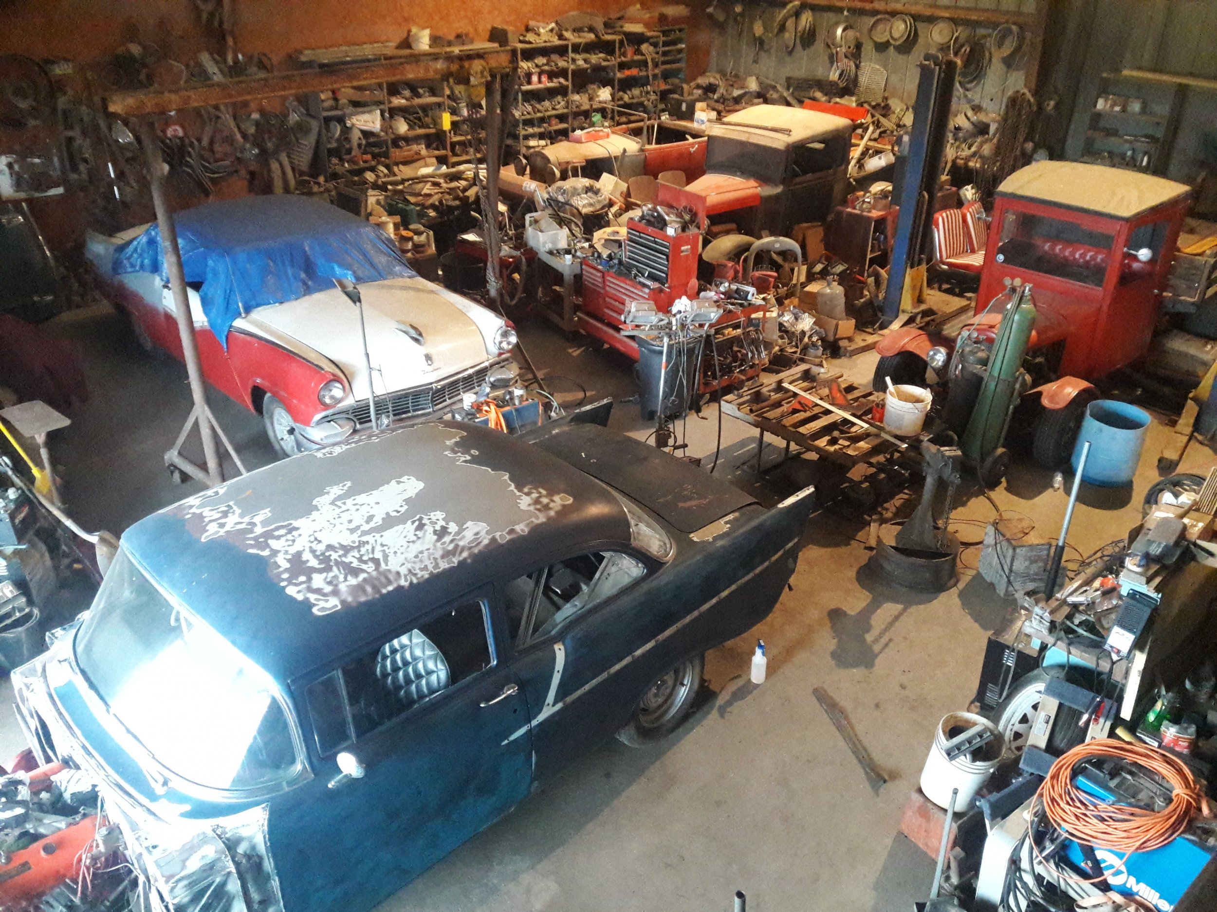

The '31 red chevy is a project to replace my High School Gold '31 I sold when I enlisted back in'67. Had a '56 Olds and 3 speed top loader. Got $250. for it. This red one is getting a 3 deuce 324 1954 Olds and 3 sp ford trans.
The other roadster is a '27 body sitting on a modified AA frame. S-10 rear end, '29 fenders, SBC just laying in there. Hopefully I'll come up with a flathead to install in there. This is also being built to replace my black flathead '27 roadster built in 2003 which I sold a couple of years ago.
