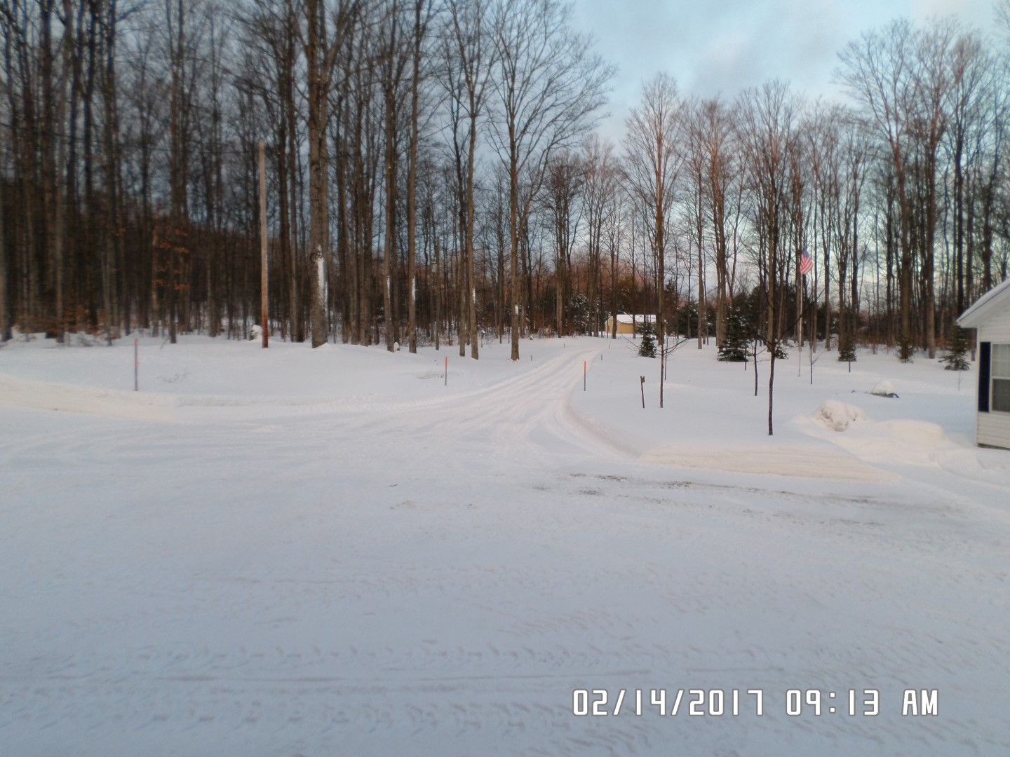

If you have a woodstove, and burn wood without nails in it, you can spread the ashes across the drive every X feet [ depending on how big your ash supply is ]. The ashes aid a little in traction, and work with the sun to melt bands of snow off the drive some days in the spring. I leave an inch or two of the same hard packed snow you have on my drive and live with it most of the winter to protect my Afton stone driveway. The ashes get dispersed off the drive and add nutrients to your land.... Should not hurt your paved section, either... Here is a picture of mine just freshly cleared off yesterday.... layers of ashes underneath with more to be added about Wednesday after our next snow....

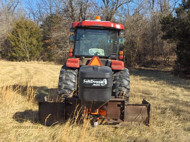

snow weapon 009.jpg Willy,I think you could use a small stone (buckshot) in one of these. They are for rock salt and melting chemicals, I have only used a product called "snowplow" in this one. That product works great in it and on ice. You could try dry sand, but you would need to close off the opening some.
