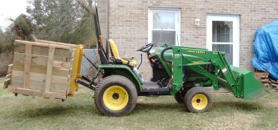

Loaded tires are great for traction but don't counter balance the fel.for that you need the weight hanging behind the rear axle. I had the tires on mine filled with windshield washer fluid before I bought it,it's best to have the dealer fill them,they have a pump.
As for ballast my manual calls for at least 725 lbs so I made a concrete weight of about 800 lbs. My tiller weighs about 500 lbs. and I can really see the difference when the concrete weight is on.Without anything on the back and the bucket full I hardly have any power steering.

Here is a picture of it,I should paint it green.
