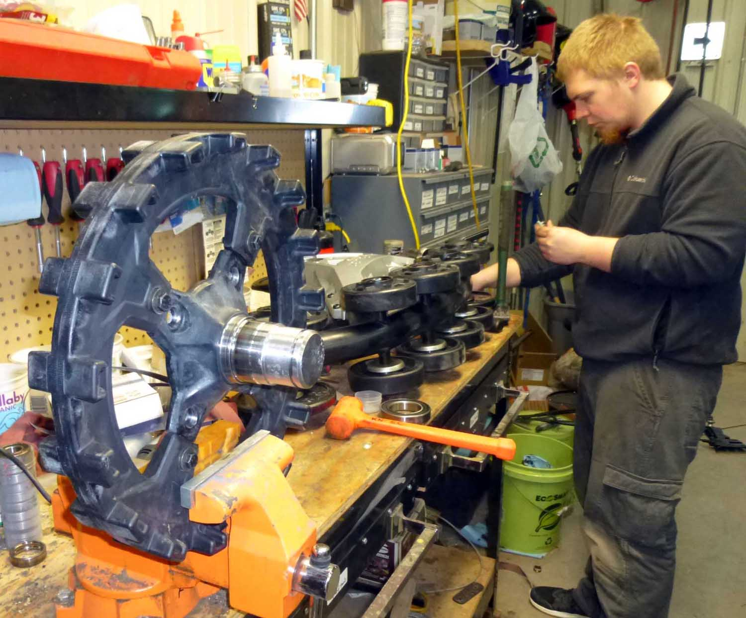

What's the part in the vise? Drive wheel? Is the shaft ruined?
/ Tracks on a UTV #23
I think I would use my needle greaser and inject the bearings with marine grease.....just me thinking.

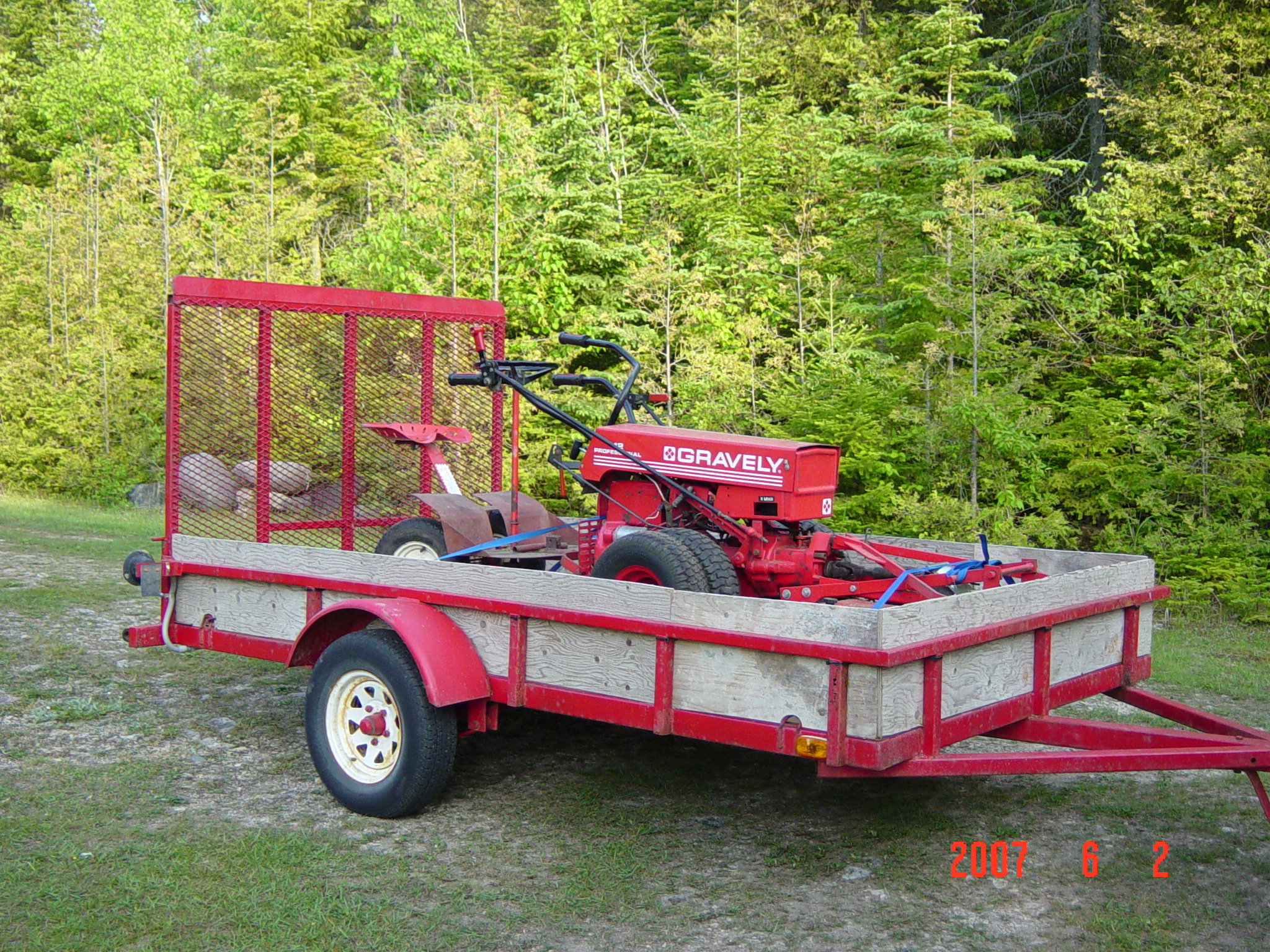

I can relate, I've spent countless hours between the handles of a walk behind Gravley as a kid.
/ Tracks on a UTV #30
That's what I thought of. Had a Gravely PRO 12 with steering sulky. Given uneven terrain, those three handles would come down as much as two feet or so, in a fraction of a second and you better not have any part of your body in the way.
