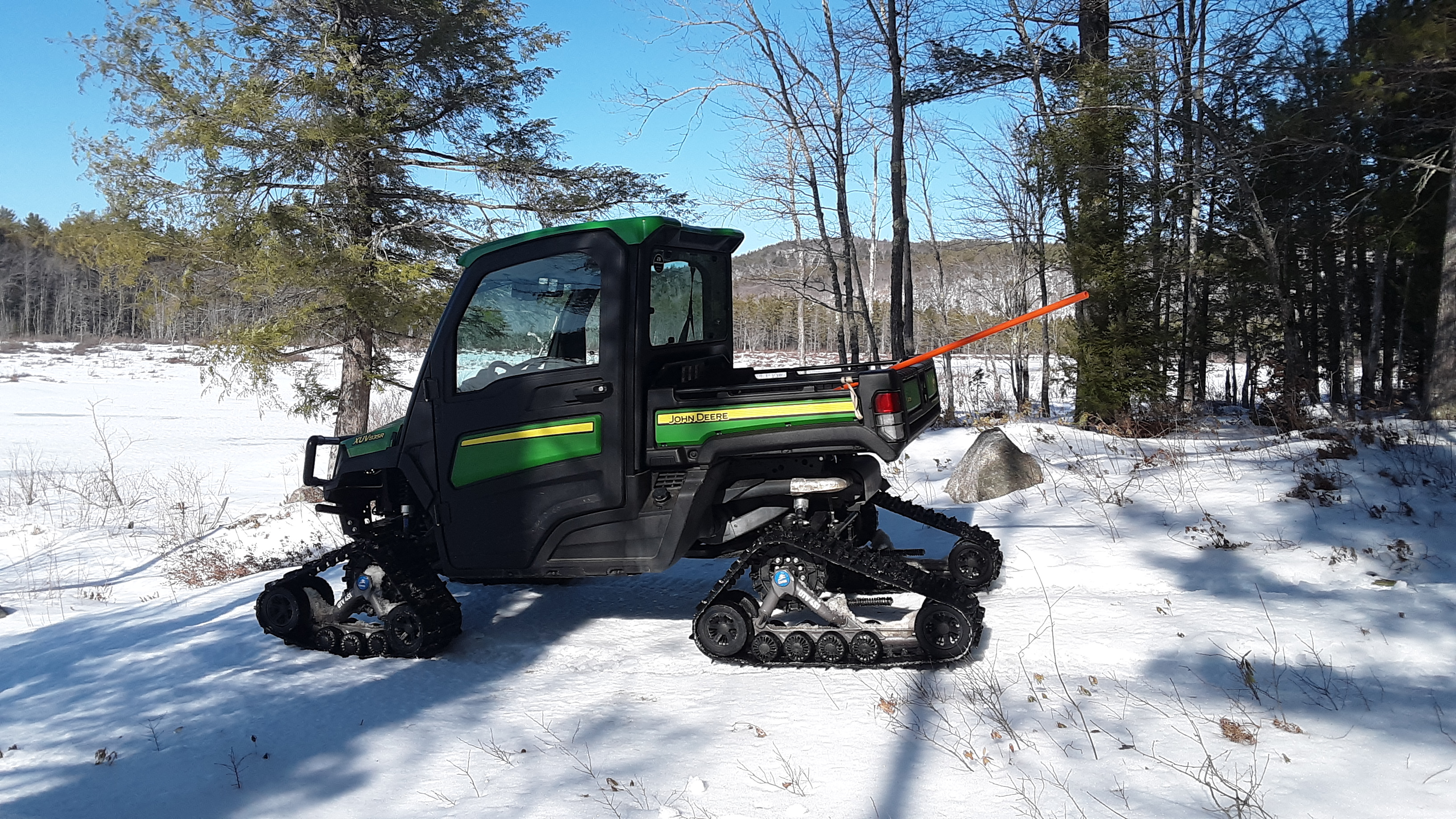

I'm kicking around buying tracks for my Gator 855D. I have heard, but no personal experience, that using tracks is tough on the running gear.
For you guys who have had tracks on your UTV for a while (couple years, at least), are they tough on the driveline?

Roy the only thing it could possibly be hard on would be to belt and that's up to the operator.
Your gear ratio is effectively lowered as the drive wheel powering the tracks is only about 14" and that's like driving on 14" tall tires.

Yes you could, but changing the pods out is a hassle. Will you be the person switching them out?? I assume you'll remove them for summer use and I can't recommend there use in the non snow season.

I could have got a used sled for the 5500 our pods cost but we didn't. There is far, far more utility in our 6x6 than a sled can offer. Sleds are great for going fast, poor at many other jobs. Kind of depends on what the user wants to do.

I sure enjoy motoring around our land in the utv, seeing and monitoring it in the beautiful winter setting all winter long at an enjoyable 4-5 mph versus ripping through the woods too fast to see anything on a sled, not to mention with my wife and dog. If one was patient, I'd bet you could get into a set of used tracks for $3000. The particular mounting parts can be purchased as the tracks themselves are 1 of 2 sizes.

Having idler bearings flailed on our machines, I'd be leery of used pods. If they are Soucy built, then they are very much more serviceable and used might be OK.
The Camso (used to be Camoplast) are serviceable including updated bearings and wheels, well at least according to a big dealer with a bunch of videos on their YouTube "channel".
atvtracks.com or maybe .net?
Pretty informative about use, installation and adjustments.

Did you see the price of the idlers?? They are costly have poor bearings molded into them. I do have experience in this business. Soucy has snap rings holding there bearings in. (y)

My usage is pretty light (we go slow) and can be out for an hour or so and maybe travel 3-4 miles, hard to say as the speedometer is not geared for the tracks. My used machine came with the tracks and was "adult owned". Hopefully it will be a few years before I need it get into it.

As part of my work, we used atv's and utv's equipped with pods for use in snow for many years. Suppose I have 4000 hours operating and servicing them. Using both camso and soucy products. If anyone here has questions concerning there use, feel free to ask any questions.
