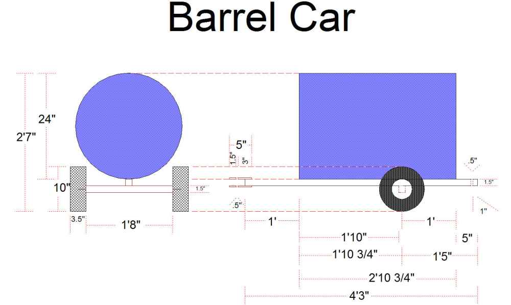

Jun 22, 2014 / Trackless Train #4 B BHD Veteran Member Joined Feb 13, 2007 Messages 1,764 Location easten Colorado Tractor JD 4020 John Deere Tractor Train - Children's Creative Creations Theme Parties Barrel Train Plans Barrel Tractor Ride - YouTube I have seen these little barrel trains make very tight circles, and little side tracking in there corners, Attachments barrelcar.jpg 27.4 KB · Views: 745 Last edited: Jun 22, 2014
