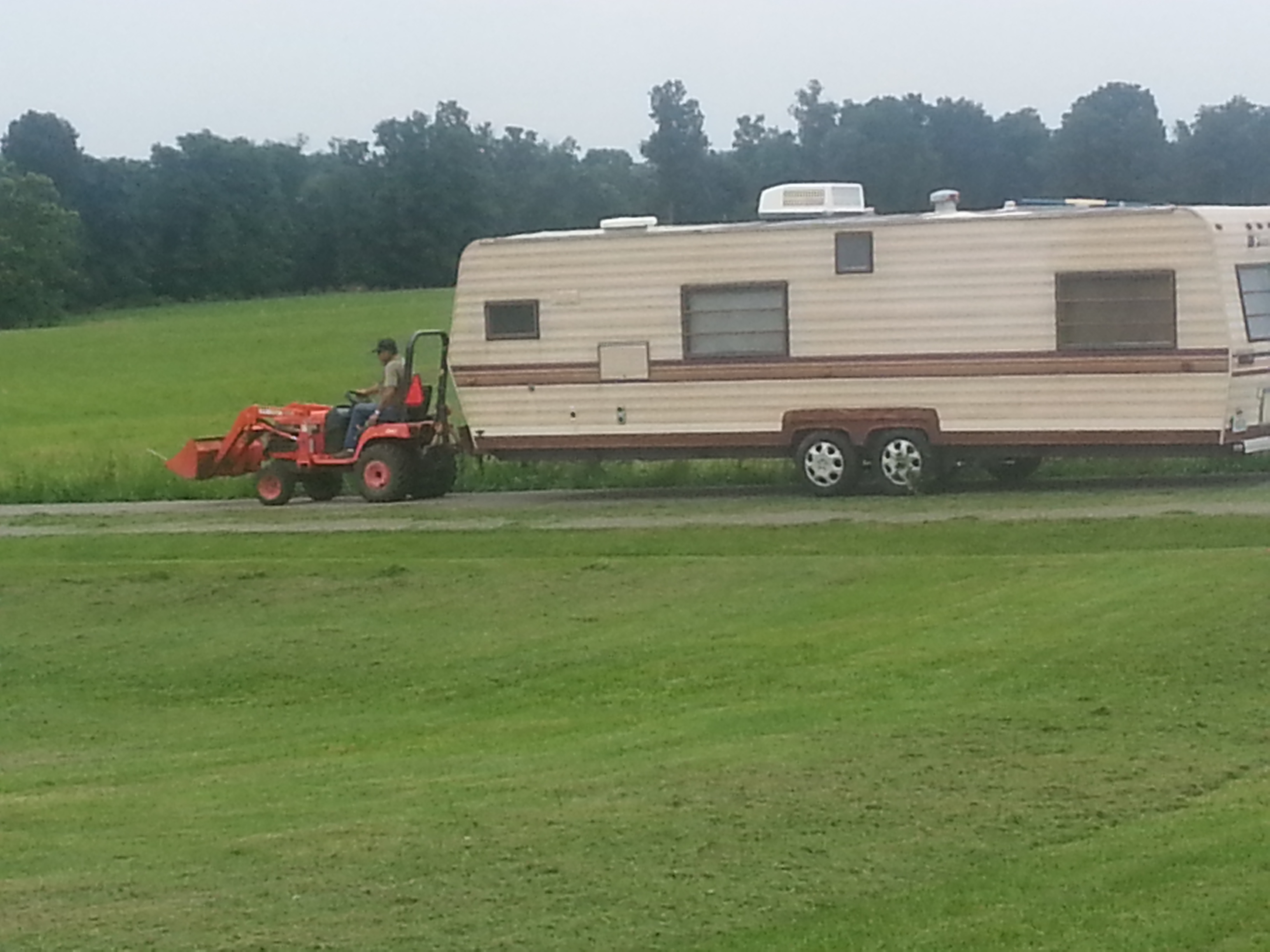

One thing I have found is it is extremely difficult to back up as i don’t have mirrors on the tractor that reach passed the trailer and you are sitting centered on the trailer.
I have the same problem. That's when I go very slow and have a reliable spotter, my wife. :)
And I always try to have the trailer straight and centered with the door way before backing it into our trailer shed. ;)

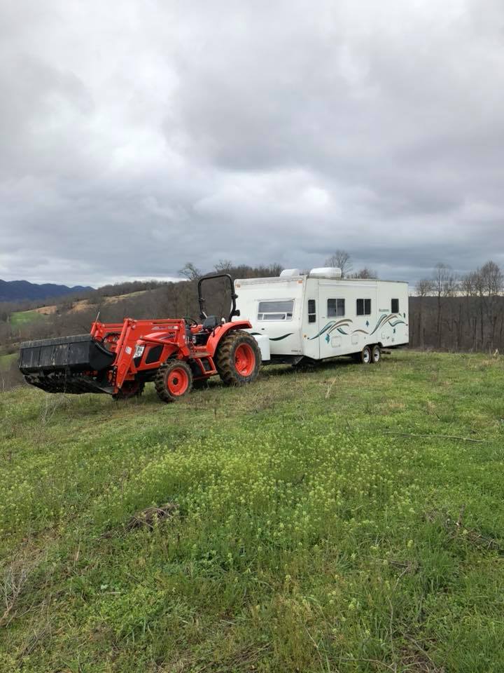

I pulled my 8300 pound trailer up a steep hill to get it to the better views using a 3pt receiver attachment. Tongue weight is your friend for traction...i carried my loader bucket in the grapple as well to give me some extra weight as i was worried about the incline, but on flat ground that shouldn't be as big of an issue. Oh and dry ground helps :)
