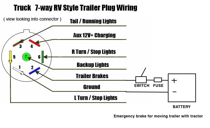

There should already be a breakaway cable at the hitch. Just fasten it to the tractor.
Bruce
I doubt it would breakaway. It would just push the tractor if it gets rolling.
