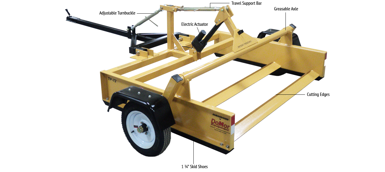

I have a 1/4 mile driveway to maintain. Right now I have a 3 point blade and have been planning on building a land plane. But, I was driving around the neighborhood last night and noticing how bad all the driveways looked. I have many Amish neighbors, and those narrow buggy wheels really cut up driveways. It occurred to me there might be an opportunity to provide a service and maybe pay for the equipment at least.
I started searching on Land Planes and ran across a couple that can be towed behind a truck. That would sure cut down on road time versus running my 7000 Allis around.
The two I found were from Domar and Eco Grader. The one from Eco Grader looked interesting in that the rear blade is adjustable to build up a crown.
Does anyone have experience with these or others like them? Anyone do custom driveway grading like this, and if so what are you charging?
Here's a couple pics:
TP Series Grader - Domor
6FT Grader | Chicago Road Graders, Towable Graders and Road Grader Sales

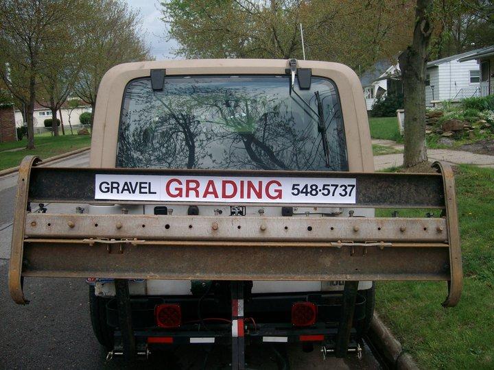

I've seen photos of a driveway grader mounted on the rear of a small dump truck and on a Jeep.

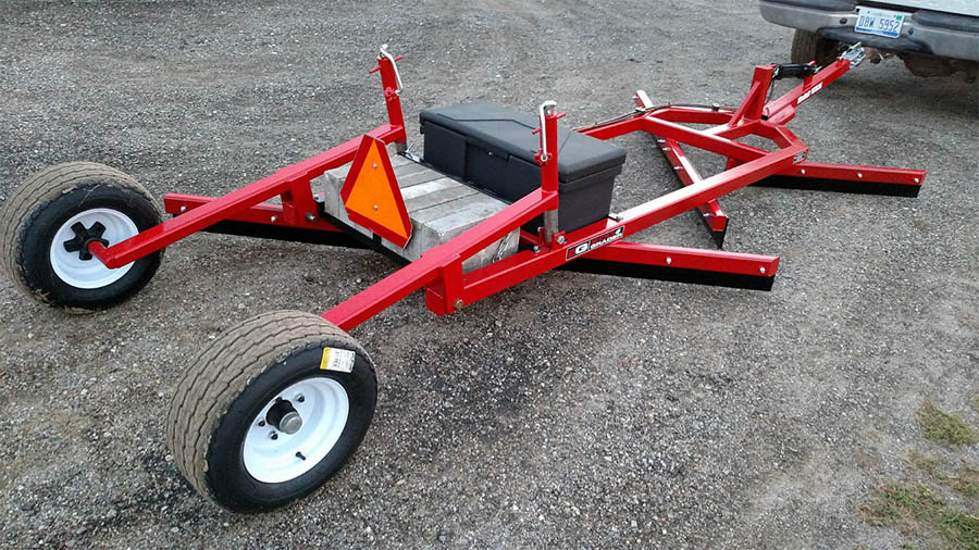

How about a low-profile land plane hung under a second-hand boat trailer?
Bruce
/ Towable driveway graders
Bruce
Thank you, that's a great idea! A boat trailer is real similar to that eco grader. They wanted almost $6k for that, out of my price range.
/ Towable driveway graders #5
I picked up a free boat trailer last year. I have considered putting my 5' grader blade on it but haven't gone beyond thinking. My grader is hung with a 1" stud so it would be fairly simple to bore a hole in the trailer tongue and weld in a 1" bushing and plate. I would still use my tractor and control height with the 3pt.

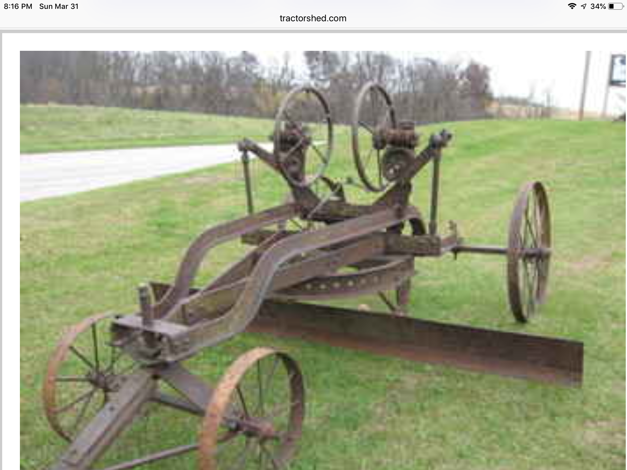

I always thought this was a nice design, nut don't see anything current about it.

Thanks for the ideas guys. That Hoelscher is heavy duty! The video of the road maintainer is very interesting. I'm going to check out the price on the Dolmar.
#18
Thanks for the responses everyone.
Domar wants ~$4400 including shipping.
It looks like I"ll be cobbling something together.
