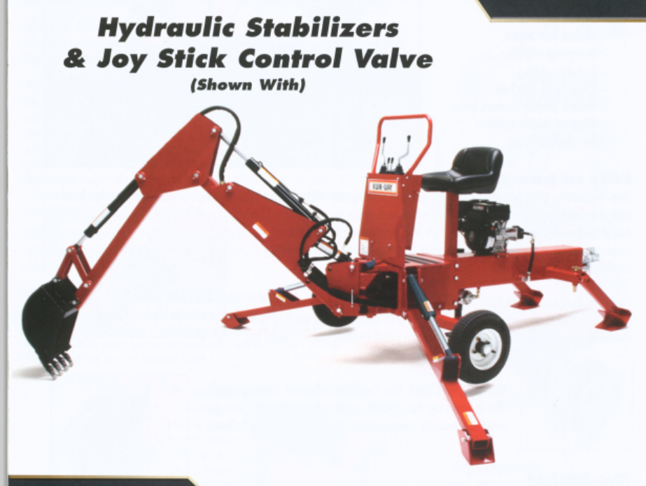

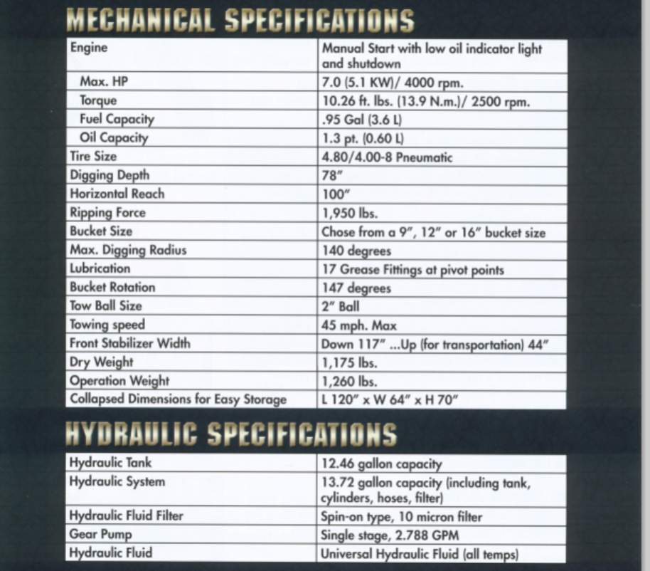

These are the specs on mine. They may be helpful to see if we are talking apples and apples.
View attachment 313706View attachment 313707
My pump is 2.788gpm and motor is 7hp at 4000rpm but it does not seem to increase digging power over 3/4 throttle.

I opted for the joysticks with the hydraulic operated front stabilizers. I could live without the joysticks but you would have to pry the hydraulic stablizers out of my cold dead hands.
I have a bx2200 that I use with it. I am in the process of adding a ball hitch to the back of my box blade so I can back the ball under the backhoe hitch and move it without getting off the tractor. Together the FEL boxblade and hoe are good combo.
I added an electronic hour meter to make it easier to keep track of when it needs to be greased. If one used it all day you could just grease it when you start and at lunch. But I use it an hour here and an hour there. It was too easy to go longer.
What pressure is your system setup to run? at 7hp with 2.78gpm you could push 4000PSI and he may of only had 2250psi
6.25 ton force on a 2" 4000psi cylinder, compared to a 2.5" 2250psi giving 5.5 ton. On top of that longer booms will require more force to do the work.
The Linkbelt i ran uses 4995psi reliefs (61300lb Excavator) but could only lift ~.75 - 1 yard at max reach and had a ~60' reach. With dual 6" or so rams
The Kubota i ran uses 3988psi reliefs (18000lb Excavator) and can lift about the the same at ~19' reach with singe 5" or so ram
Reach measured from tip of track
