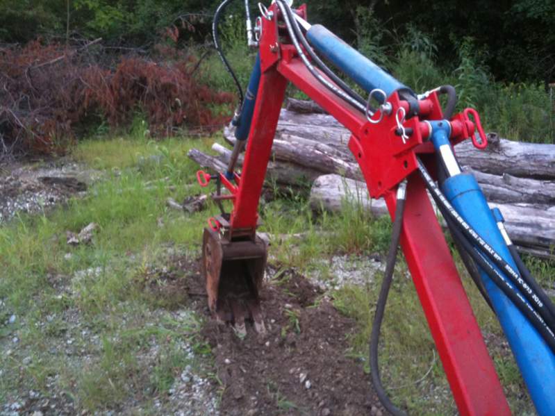

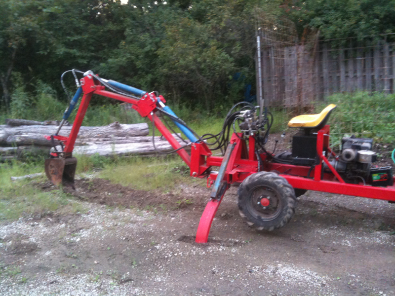

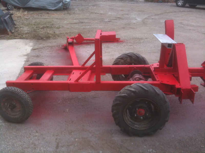

I built this backhoe last year but am having a few problems
Problem 1- don't have enough counter weight and don't know what else to do I have 8 retaining wall blocks that are about 45lbs each on the back
Problem 2- every thing works but the cylinder that lifts the arm bogs down the engine
If any one has any suggestions I would greatly appreciate it thank you

What is your control configuration to operate the extra cylinder? Any particular reason you built it that way? I do see they are made. Maybe a larger power source would solve both of your problems, old forklift engine perhaps.....and mount it more aft of the hoe.

I have spent many hours looking at towable backhoes and 2 years ago I bought a used 6 ' 6 " arps / JD and mounted it under a 26 HP Kubota. Most towable hoes have arms that extend well backward of the boom swing point. This is necessary because they do not have enough down weight ie BIG Chassic. Look on the net and you will find many makers of your style and copy what you think will work the best. The arms will get slightly in the way of your excavation but they will move your center of gravity well to the back.

I have an older Northern Hydraulic back hoe- Barnes 11 gpm 2 stage pump and an 8 hp tecumseh.
The bucket for the most part is actually digging between the two out rigger arms on either side. It uses them to pull up against for leverage - so the back of it is never light. The tires come off the and switch with the out rigger arms when it is time to tow it or dig.
You said you have lift problems. I notice that you have a lot of reach on your boom and cylinders, especially on the last one - to the bucket. With all that reach your motor and pump may not be big enough. I'd shorten up the bucket reach arm/cylinder. Beefing up the pump and motor might do the trick, but that is a lot of stress too. Are your welds going to hold up?
Good luck with this. You are doing what many of us wish we could do!

I think your rear drive wheels are too far forward and that they need to be moved back. I think if you skewed the legs to the back which means to move them as far possible to the rear and in that way the rear drive wheels can be pushed toward the rear. If I understand it now you need less tail weight and more tongue weight. So you move the pivot point ie the rear wheels.
Here is a non engineering idea to guess the forward balance points. Consider the rear wheels like a teeter tooters center point.We all know when the Husky kid got on the thinner kid was airborne. So if you can guess by loading the front and keeping your boom up tight that the machine is in balance, then you can estimate the foot pound distance each side of the machine has. So if 6' boom measured from the rear wheel pivot equals 7' front with blocks then both sides are balanced. if you in theory remove the blocks you are unbalanced by 400 lbs at 7'. If you estimate that the rear wheels were moved back by 1 foot then you would have 8' at 400 lbs and less weight on the boom side.
If the wheels went back 2 ' then there would be 5' on the pivot side and 9' x 400lbs on the front.

Could you move your rear stabilizers in a V to put more leverage on them instead of more counterweight? Also, before upgrading the hydros I'd check to see how the metal is taking the stress. Put a psi gauge on it and see if it's maxing out. Usually if the hydros aren't up to snuff it'll just run slow when extending and retracting, but your psi will max out at 2.5k or so. Make sure your cylinders and hoses, valves etc are up to any added psi. A blown hose or cylinder can puncture your skin and inflate you with hydro oil or cut a finger off.

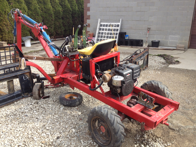

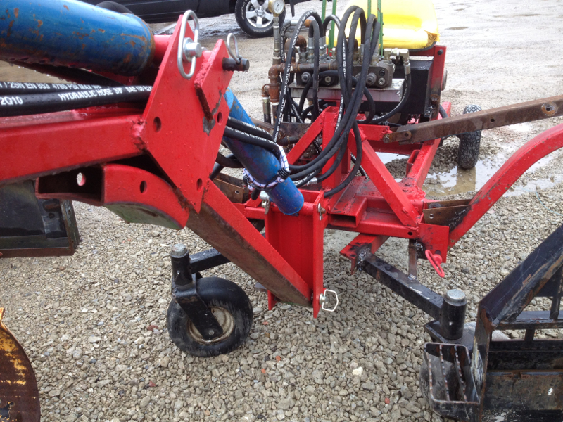

So I made some updates to my backhoe and it still isn't working right . I installed a bigger pump (11 gpm) I also put casters in the front and the axle in the back and that solved the tipping problem. It seems as if the pump or the motor isn't strong enough although with the new pump it doesn't bog down the engine anymore but with the bucket full it won't pick it up if anyone could help me I would greatly appreciate it thank you

Sounds like a pressure issue to me. What pressure is your system running at?

The pressure gauge is only reading around 1100 psi

Typical compact hydraulic systems run at about 2000 PSI. Your low pressure could be the problem, but I'd think that at 1100 PSI you should at least be able to lift a bucket full of dirt. I think the first step is to get your pressure up closer to the 2000 PSI range and then troubleshoot the rest of the system.
Check your relief valve. The spring may be getting weak.
If the relief valve checks out, it may be that your pump is weak. How old is the pump?

I'm wondering if your engine is strong enough to get the pressure that you need? What are the specks on your pump? What is it rated for, and what are your cylinders rated for?
Lifting the bucket with a load should be the easy part, digging is when you need all the power that you can get.

The pump seems to not be building enough pressure. My home made excavator started doing the same thing. It wouldn't lift the bucket when it was full. I would have to dump the dirt and bring the stick completely in to get it to raise up.
It started working though as soon as I replaced the pump. Though the one I have won't really work with my engine. lol It needs more hp. I'm gonna save it for another project.
So I still have to order another pump for mine that won't bog down my engine.
I'm wondering. Does it break through the dirt easily? Mine was breaking through the dirt like it should but just didn't have enough force to raise the bucket.
