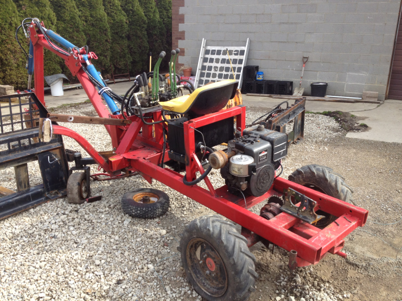

Thank you all for the advise these are the specs on the pump and it is run by 11hp Briggs
GPM: 11
Shaft: 1/2in.
Inlet: 3/4in.
Outlet: 1/2in. NPT
Dimensions: 5.5in.L x 3in.H x 4in.W
Minimum HP: 5
RPM Requirement: 3600
For use with open center hydraulic systems only
1st Stage: 11 GPM@650 PSI
2nd Stage: 2.9 GPM@2500 PSI
Maximum Pressure: 3000 PSI
Bolt Circle: 2.83in.
4 Bolt Holes Spaced 2in. on Center
Bolt Hole Diameter: .344in.
Rotation: Clockwise

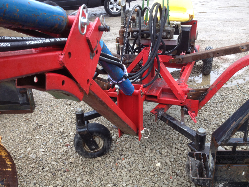

These are the control valves

12barber12,
I don't know if you know this, but hardly anyone uses a two stage pump on anything other than a log splitter.
Irregardless, with that HP and the pump turning at 3600 rpm, you should have the pressure when a load is placed on the cyl.
Get your self a single stage pump, and you will be glad you did.
Your 11 HP engine should turn a .4 cu in pump at 3600 rpm and produce about 5.5 GPM at 3000 psi.
Set the valve relief about 100 psi below the pumps max pressure.
Do you have PB on the one valve, and is it setup to run another valve.
Your flow should be something like this. Pump to IN port of first valve, PB out to IN port of second valve. The first valve will have priority.
Both tank ports should go a filter , then to tank.
I would also not recommend galvanized fitting.

I do have pb and it is piped exactly how you said this is similar to the pump I had on it but the 2 stage seemed a little better

First you need to figure out why you have only 1100 psi max pressure.
Then look at your design. You mounted the boom cylinder on top of the boom, which means its lift force is in the retract mode. A cylinder retracting has only a fraction of the force as extending.
Many backhoes and excavators are made this way to help protect the cylinder from damage of getting in the dirt or getting hit by the bucket if you crowd to close, but those have larger diameter cylinders with smaller rods to compensate for this reduced lift force.
Other backhoes mount the cylinder under the boom to take advantage of the extra force while using a smaller diameter cylinder.
Here is an example figuring a 3" cylinder barrel with a 1.5" rod @ 2000 psi:
The extending force (base end) is 7 tons. The retracting 1.77 ton. That means in the cylinder was under the boom it would have an additional 5.3 tons of force. You would be able to lift more with less pressure but the cycle time would be reduced.

So I made some updates to my backhoe and it still isn't working right . I installed a bigger pump (11 gpm) I also put casters in the front and the axle in the back and that solved the tipping problem. It seems as if the pump or the motor isn't strong enough although with the new pump it doesn't bog down the engine anymore but with the bucket full it won't pick it up if anyone could help me I would greatly appreciate it thank you
I think your problem is geometry of the cylinder versus the boom. It is almost parallel to the boom. In other words it acts on very short lever to lift the boom.
The cylinder has to have more obtuse angle relative to the boom.
I am of the same opinion.
Also lack of hydraulic pressure and/or cylinder dia being to small may be contributing factors but overall I would say what ever ram/pump is used the
ram angle needs to be addressed.

I am going to address the problem of the lift cylinder but it doesn't make sense because the cylinder that moves the dipper arm if that's what it's called seems very weak also and that cylinder is pushing but the bucket cylinder seems to have descent strength I know it's hard to understand but I don't know the correct terminology any advise is greatly appreciated
/ Towable backhoe #35
In my opinion the geometry on this is not to the best advantage of the cylinder, main pivot could be lower or underneath the boom.
Also feel the dipper arm could be to long.
What are the lengths of the boom arms you're using?

The dipper arm is 49" and boom is maybe 42" then angles around 30 degrees and is 30"
