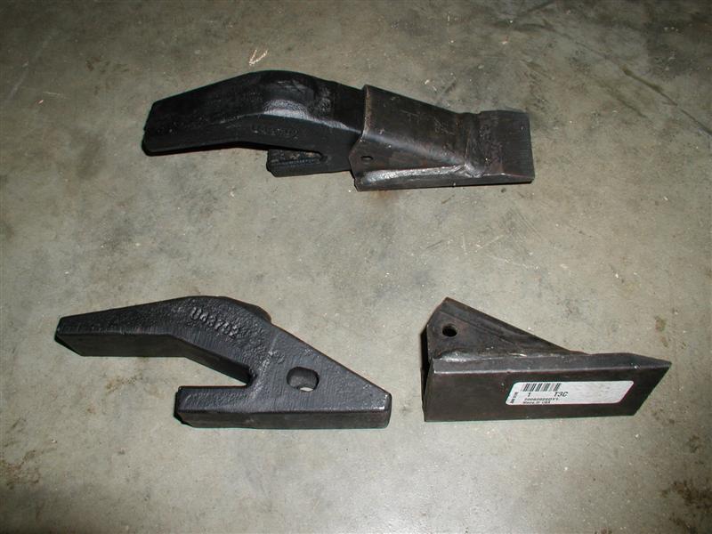

   / Tough little dirtbucket with teeth!
#2

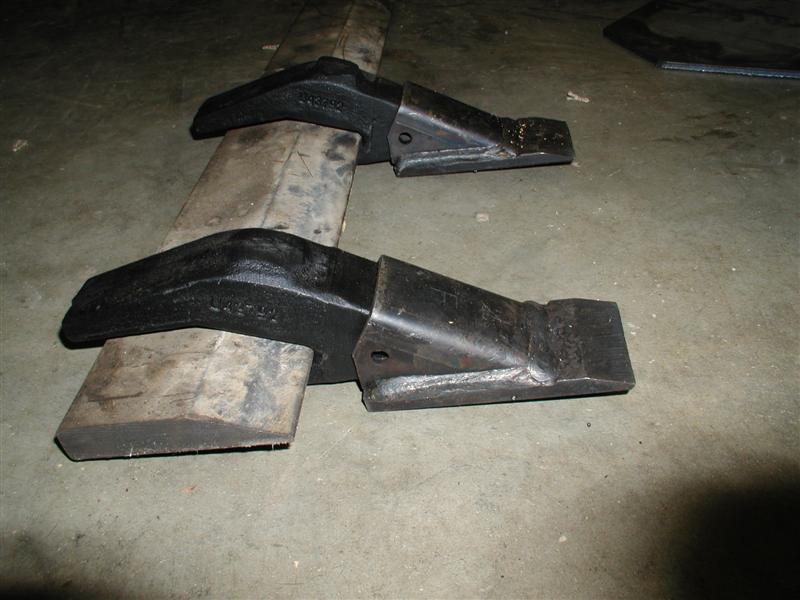

...And then bought the right cutter bar for the teeth, and got the stock for the bulk of the bucket too.

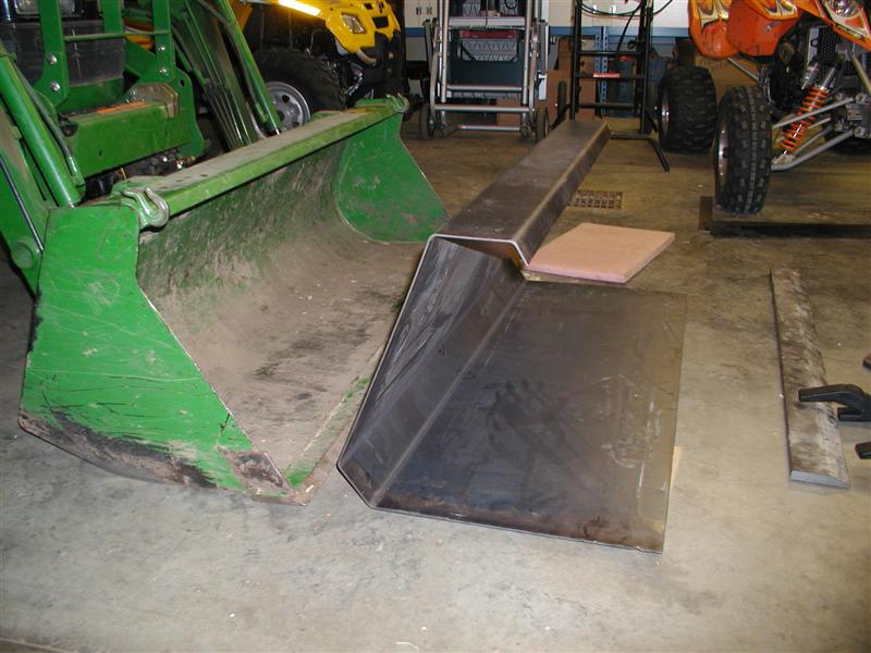

This stock was too much for my bending equipment, being 10 gauge (0.135"), so I took it to a local shop and had the bending done. Here you see the bent result, setting next to the stock bucket, which I am sort of copying.

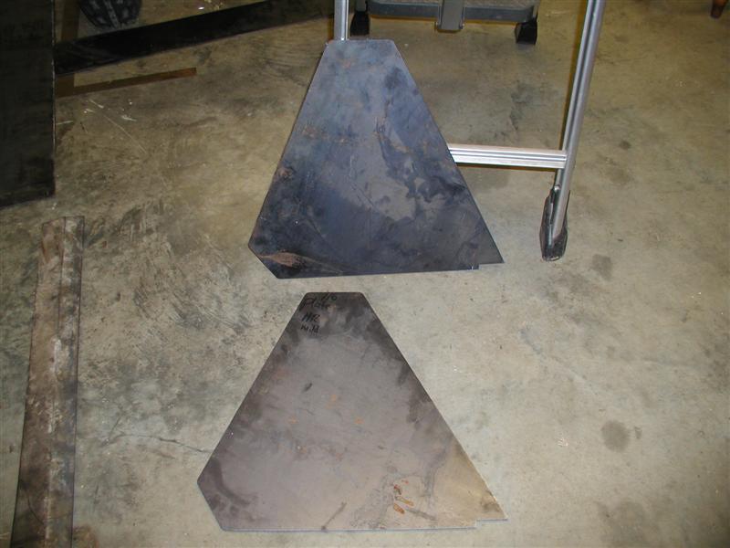

Then I layed out the side panels and cut them with the plasma cutter, of 3/16" steel.

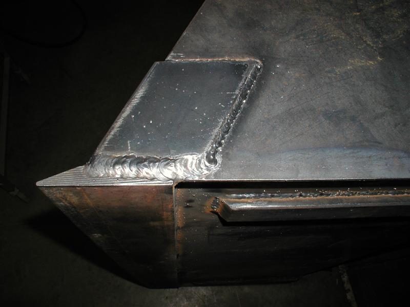

detail shot.

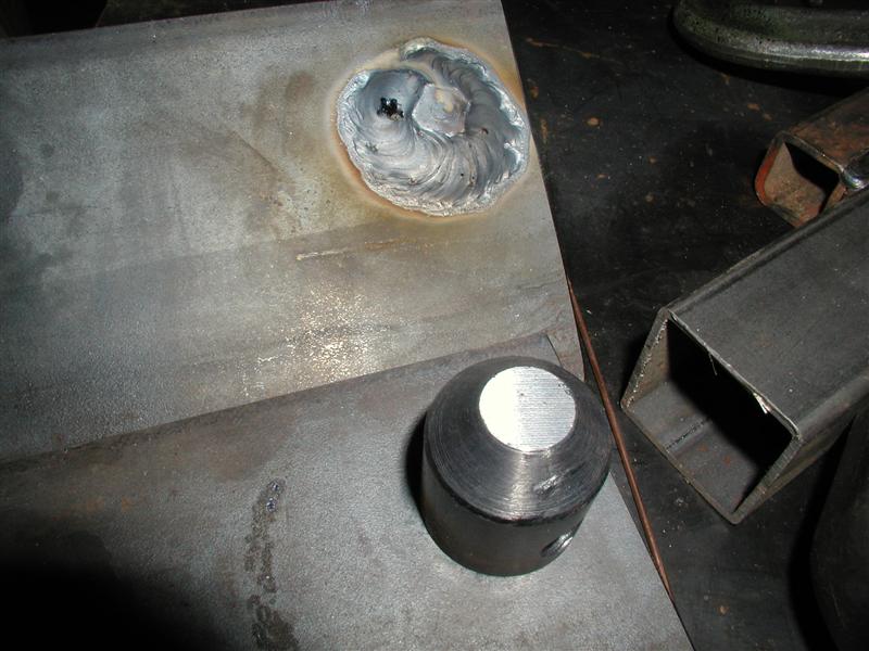

Lathe turned the pins for the quick-attach feature, and TIG welded them to some mounting plates.

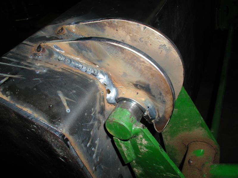

Then I fabricated the upper mounting bracketry. These gussets were also plasma cut.

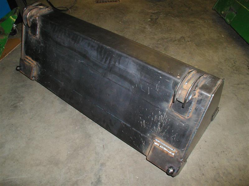

Rear side view, bucket basically completed. I still have to weld on the teeth, to do this weekend.
Not shown details include two seperate torsional-strength adding elements welded in. One in back lower corner, one in the inside top.
