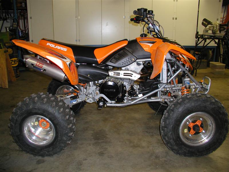

Now tell me about the machine that is attatched to the wheel in the background, looks to be the landing gear of an aircraft. Please post a picture of that too!

>Now tell me about the machine that is attatched to the wheel in the >background, looks to be the landing gear of an aircraft. Please post a >picture of that too!
That's a Polaris Predator ATV. Here's a pic.

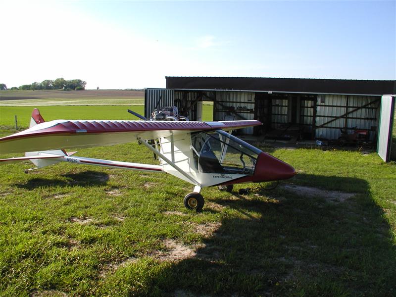

But if its an aircraft you want to see, here is a pic of my Kolb Twinstar Mkiii with BMW R100 engine. Enjoy.

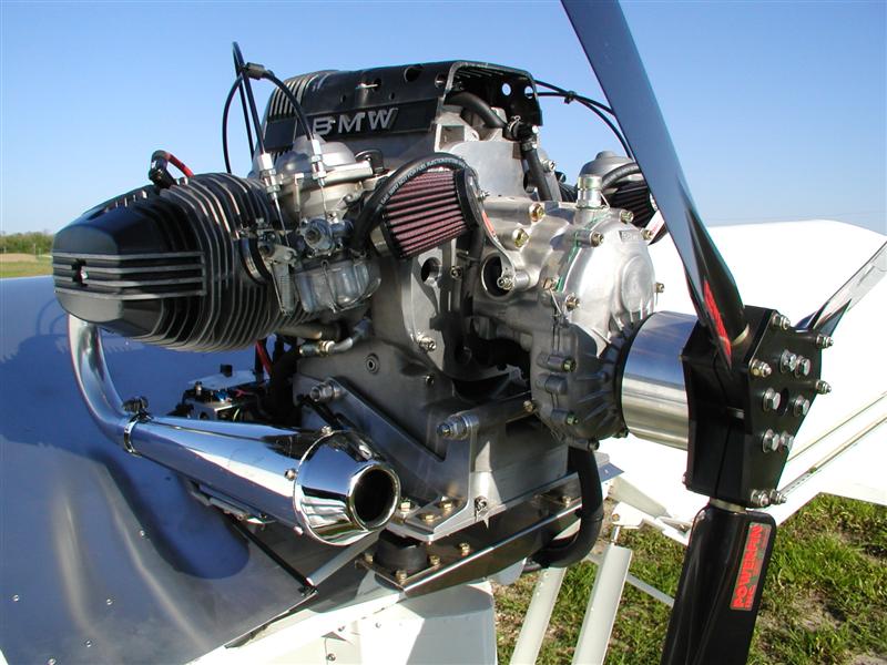

(Sorry to highjack my own thread)
And here's a closeup of the powerplant...a 1991 R100 (1000 cc) BMW.

Seems to be a somewhat different take on the old Outboard motor "thru the prop" exhaust system.....Is there some limit to HP on outfits such as yours?? BobG in VA
