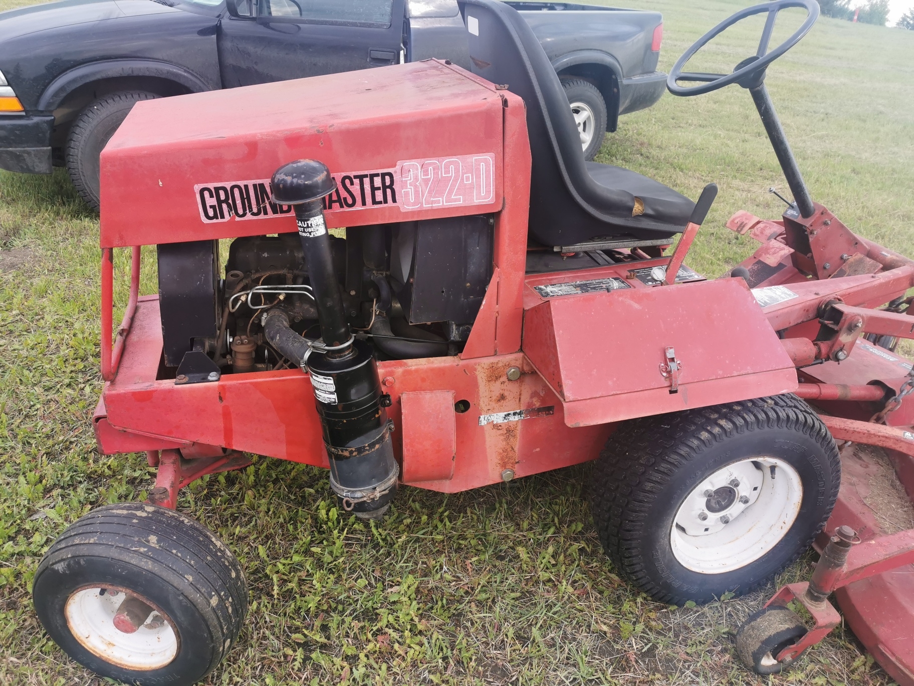

looking for ideas, last night my Toro 322D started spraying diesel on the injector side, Kubota 3 cylinder, tried tightening the nut but it was a small crack in the line injector end just at the ferule, looked at ordering they have to be made and looking like 5 plus weeks, my first thought was to braze the area and get me out of a bind,
any other thoughts or ideas, local shops say because its the high pressure line its not able to be made.
sucks but first breakdown for many years, one thing the clamps that should be on the 3 lines are missing, Im guessing its vibration that causes the crack would these clamps avoid the issue

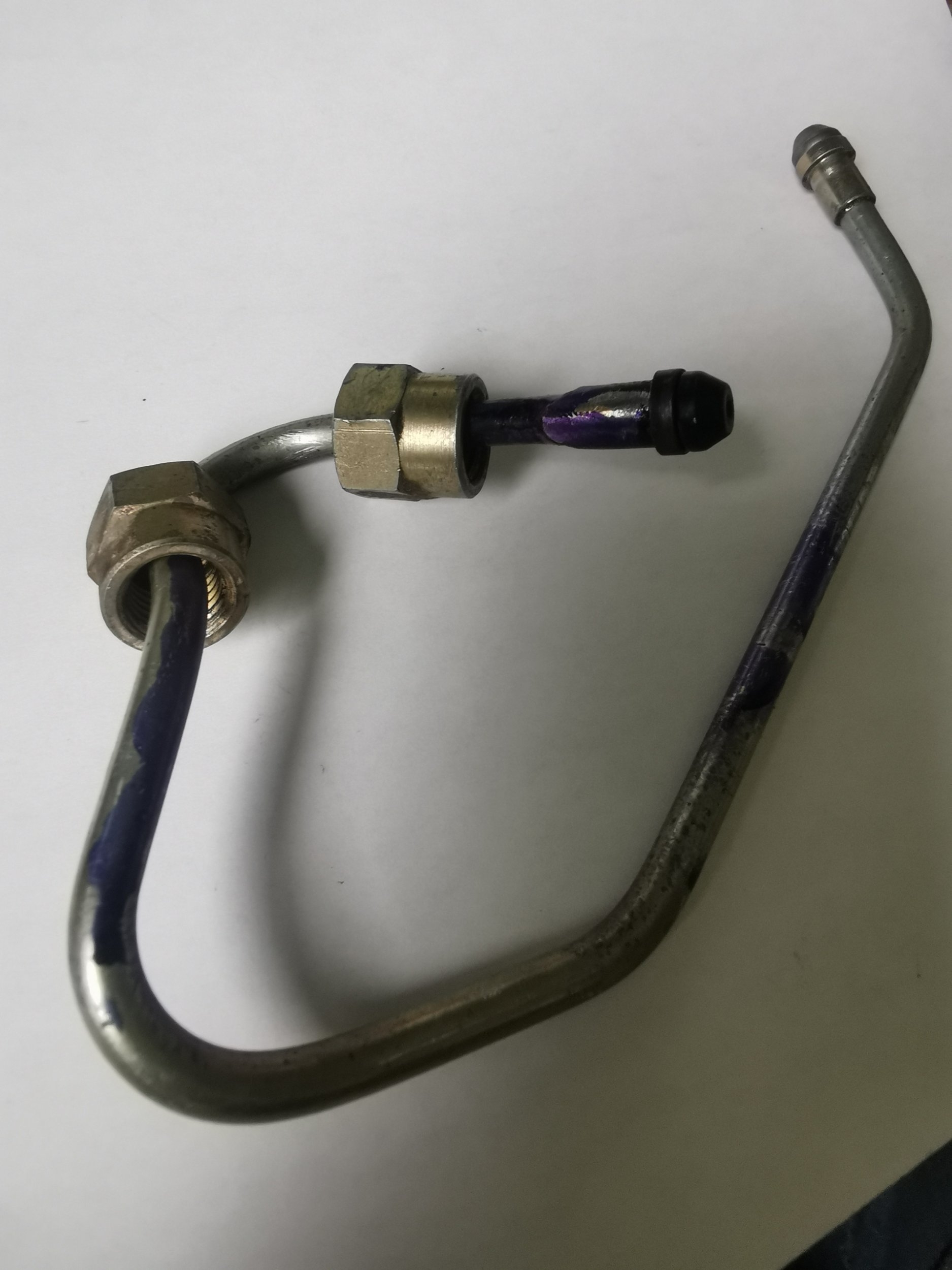

correct, dealer has to order it from Toro, not a stock part has to be made, part number 42-8140 pipe assembly fuel injector #2, tonight I roughed it with emery cloth, cleaned well and brazed the tube to the collar, after installing, bleeding its running but no idea how long it will last, will add a picture in the morning

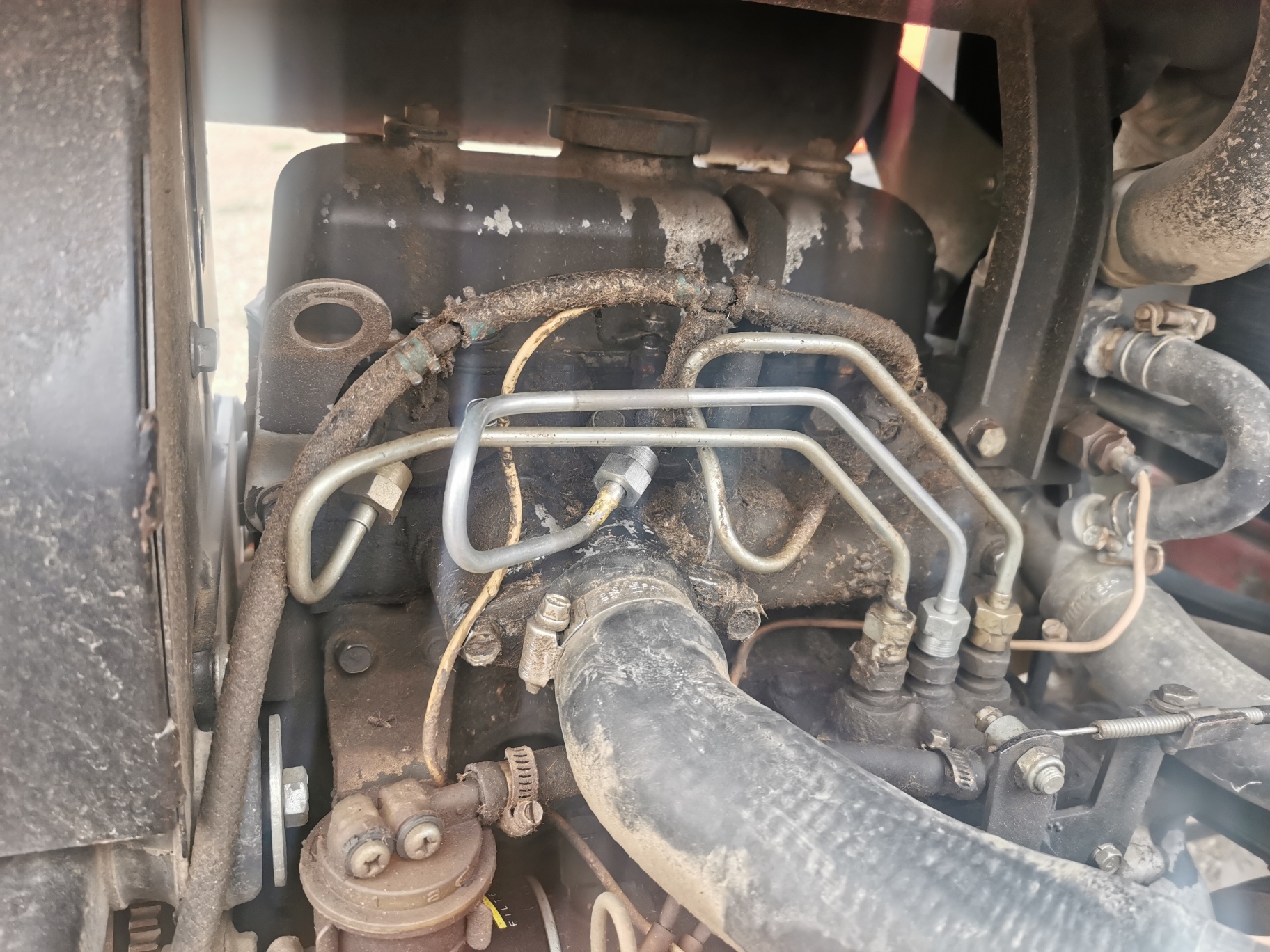

yes called the few shops in town, they say they only do low pressure this is high pressure to injectors, one would not do it due to the bends anyway one on order be in for next year, here is the temporary fix, used it for a couple hours last night and no leaks though I know its temporary and check it for the crack coming back
never figured it was a Mitsubishi the dealer said Kubota, now I have to take another look, it would explain why the Kubota dealer looked at the line and said he had nothing like that

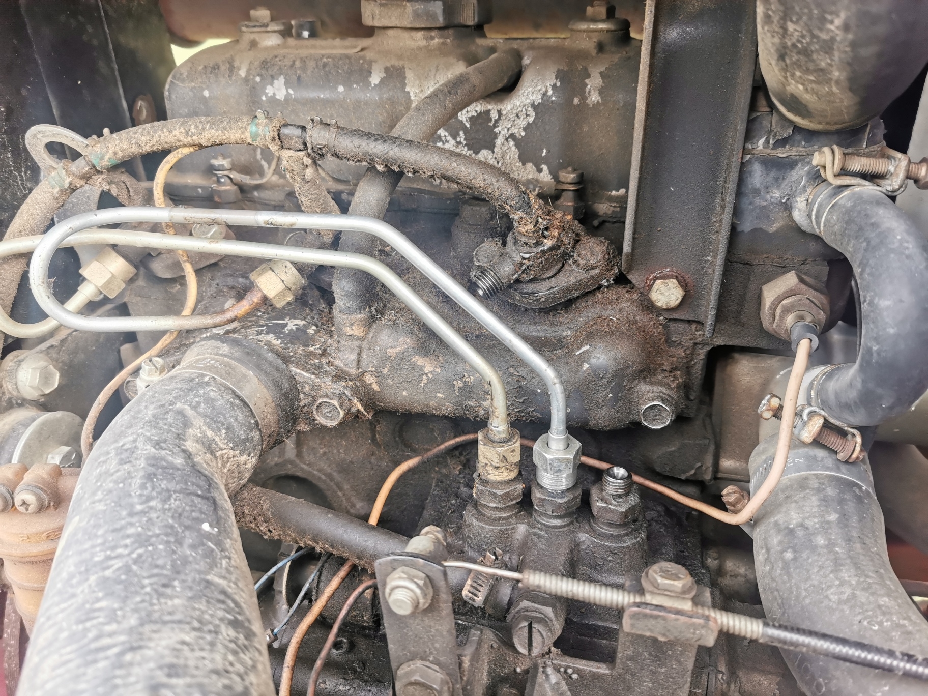

quick update, the brazed line is still working however last night the wife ran the mower and it died, took a look the right side of motor is covered in fuel, figured my patch job failed but closer looking its number 1 injector line this time, broke the end right off, I never knew these lines were so thick, its close to 1/4 diameter and the hole thro is only 1/32 diameter.
took the line off and cleaned it up, pulled out the brazing cart and using a jig was able to align the end up and brazed it, another temporary fix, ordered a new one from Toro, $185.00 not cheap but given this pipe is so thick its not like brake line material, be here in 3 weeks lets hope the brazing holds up.
my question is this common, this will be 2 injector lines that failed the same way a year apart, did the previous owner stress them at some time or is it from vibration when running just fatigued the material, the lines do not have the 2 clamps that hold them together so maybe this would and avoid the vibration fatigue.
any comments or ideas are appreciated

well now its screwed up, the temporary fix on the injector line is temporary, just got a call from the Toro dealer locally the replacement line is discontinued, they have no suggestions how to get one, anyone have any suggestions, local shops are no help and Im out of ideas
any and all help is appreciated
thanks
/ Toro Groundsmaster 322D fuel issue #17
First u have to figure out what size ends u need.. both inj pump AND injector..
Hint: take a METRIC wrench, use the box end and fit it over the connector.. it’s either gonna be a 12mm or 14mm..
Now plug that # in Google as written & look for the correct ends..(12-14mm)
Ex: 6x2x600 injection pump line
They make a flexible emergency line w different ends but I haven’t looked for it.. I’ll leave it up to u..
