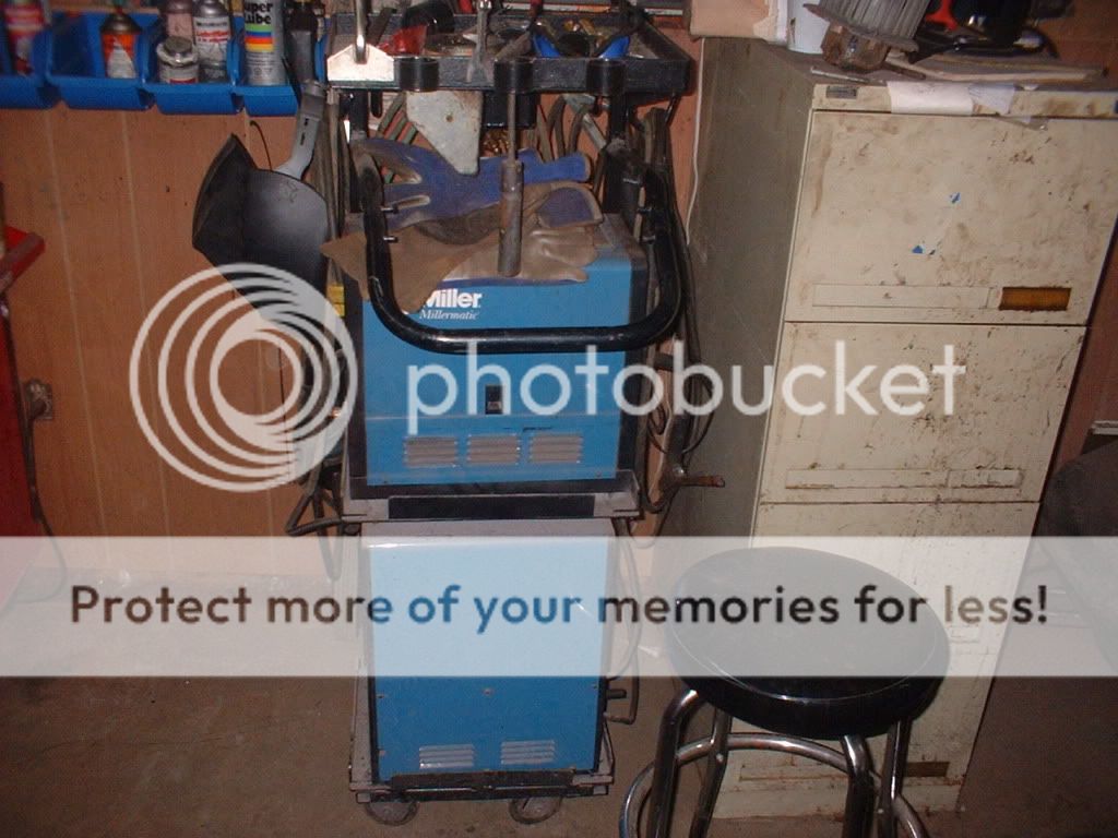

Rather than build a torch only model, i built one that will hold my mig and stick welders along with mig gas, and oxy ace. Its a copy of miller's "Torch Runner". I own all my bottles, but it was designed to work with "full sized" leased bottles too. It works well, and is pretty nimble, despite its ungainly appearance.

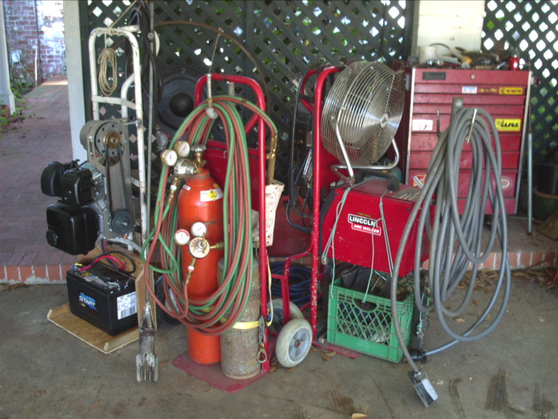

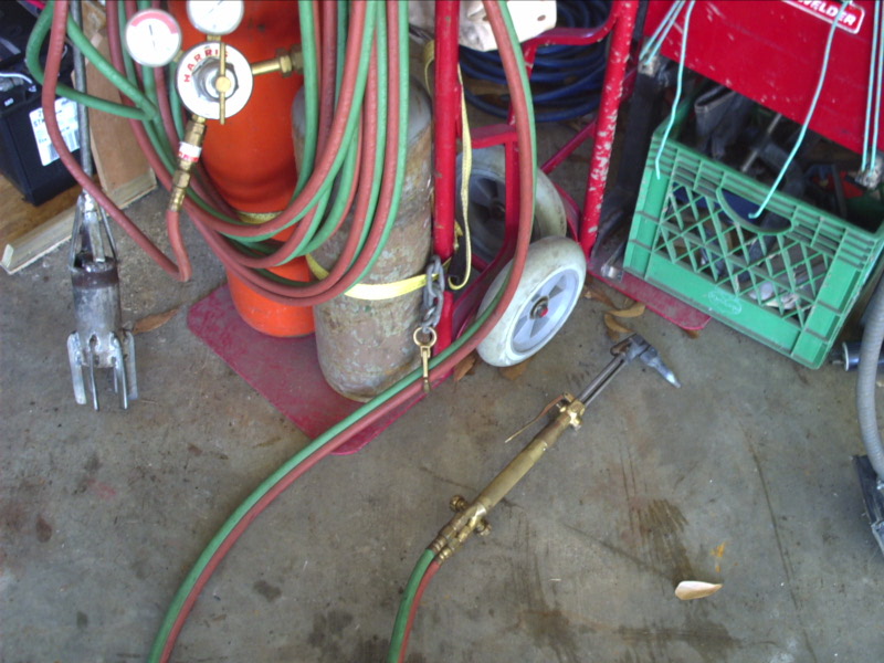

/ Torch Cart build #5
Bigger wheels and relocating the axle for them to fit might do the trick for you.
I to just use a Hand Truck, No-Flat wheels are recommended.
see Pic00001

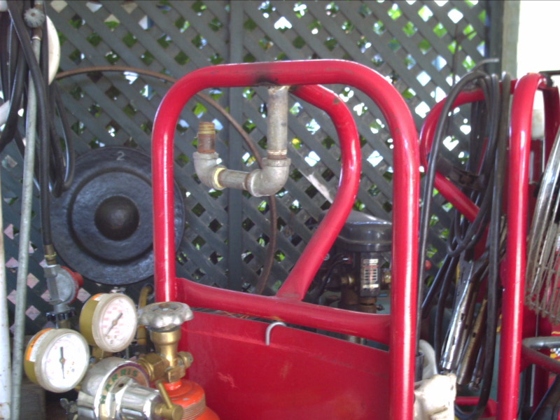

For the movable hose hangar, I welded on a pipe nipple recessed a little, then used some pipe nipples and fittings so it can still be used as a Hand Truck.
see Pic00002

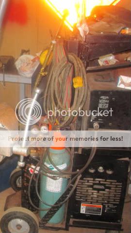

SAFETY TIP: Secure the hoses towards the bottom on any cart with such a small footprint. If you tug or trip on the hoses the chances of tipping the cart and bottles over is greatly reduced by doing so.
see Pic00003
I like Hand Truck's, :) so I made myself a bolt on bracket for my MIG, with slide in Milk crate for tools and a post for a Patio Umbrella and Extension Cords. Tool tray's could easily be added on the back not interfering with its use as a Hand Truck when needed.
The white Hand Truck is a Work In Progress portable Battery Charger/(Generator when a Dc->AC power inverter is used). Leaning against it is a Propane torch. A second Bracket is ordered for adding a second Alternator to it.
