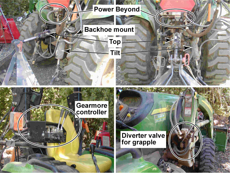

Hi JBA:
There are three Gearmore numbers on the Top & Tilt - #T3X8 18, 30WD08-125, 644749. I don't know what these numbers designate. It cost $1,700 (with the controller valve module) and I don't know what the cylinder size is, but the OD for both is 3.5". My dealer (Rainbow Ag in Ukiah, CA) sell a lot of Gearmore equipment. They told me that you get more for the cost. The Top & Tilt and 72" box blade are certainly very sturdy.
On my rig, I don't see how there could be a clearance problem with any reasonabe cylinder. If you have the 447 hoe you already have the Power Beyond kit (required for the hoe), but I don't know what the cost differential would be between the Gearmore valves and a set of diverters. I did not use diverters from the loader valves for the Top & Tilt because I already have one for a grapple attached to the loader bucket. I can see how using the loader control for adjusting the box blade (via diverter) could be very ergonomic, however the Gearmore valves are not bad. They are mounted on a tube that is, in turn, mounted to the ROPs on the right side. It is easy to adjust (up and down, tilt, and slide back out of the way) and remove. One thing to consider with diverters is dressing hoses so they are out of the way when the hoe is on. With my set up I just unplug from the Power Beyond, so there are no extra hoses on the tractor when the backhoe is on.
Steve
   / Top n Tilt with 447 Backhoe #12
Thanks guys, I am planning to install the diverter at the same time so the current joystick control will be used. It sounds as though I'll be OK, I was mainly concerned about any residual brackets that are part of the TNT.
With the JD diverter valve There wont be any brackets to get in the way. I'll attach a clickable picture of the back of my 3520 and you can see where the hoses will plug in. The dirverter SVC's are on the right side.
As Elroy4455 said any cylinder will hit the backhoe bracket if it is in the full raised position and swings to the right. Pretty easy to prevent that from happening.
I think given the amount of money one will spend to do this right, I would most certainly be sure to get cylinders with check valves so the settings will not change over time.
You would not want to find that after grading a while the right side of the blade or box blade had drifted down and was digging in more than you thought.
Do a search for check valves in the hydraulic forum or search for check valves with postings by MadReferee. He was very informative about all things hydraulic.

I appreciate all your responses and I know you are trying to help. After reading these comments though and talking to two different dealers I'm more confused than ever. My original concern was how difficult the TNT would be to remove versus what I do now to install my backhoe. But now I'm led to believe by one dealer that it will take me 1-2 hours to remove hoses and bracketry. I was assuming as some have already said here that I could just disconnect 4 hoses, pull pins and remove the cylinders.
Al, I appreciate the picture you attached but this is for a cab which has a different setup. Also, where on the JD web site can you "view" the TNT? the only place I can get any graphics is the exploded view in the parts catalog. Whan I do a "Build your own" and click on the TNT it doesn't show me a picture, just the part number. I would really like to see a picture of it. Preferably with power beyond and the subframe mounts for the backhoe, but I'll take what I can get.
I am amazed at the lack of knowledge the dealers have about what will work together. I have ordered the TNT kit and diverter from my dealer which assured me they would be fine with the backhoe. But when I called and questioned him about the clearance issues he wasn't quite so sure. That's when I called the other dealer and they called me back after they said they called JD and he's the one that is telling me 1-2 hours to make the change.

JBA:
The hydraulics should all have quick disconnect fittings so this doesn't take but a minute or so. The Top and Tilt cylinders just stand in for non hydraulic links, so they take about the same amount of time to install or uninstall as the mechanical ones. Here are pics from my rig. I will check and repost if they are too pixelated. My diverter for the grapple is mounted on the loader mast and just diverts the bucket tilt lines to the grapple at the press of a button.
Steve

Thanks Steve, that's what I'm thinking. It should be no big deal and relatively quick and painless. I also appreciate the picture and if I decide to go the non-JD route I will check out the Gearmore units. At the moment though I have the JD on order and would really like to see a picture of the JD setup.
