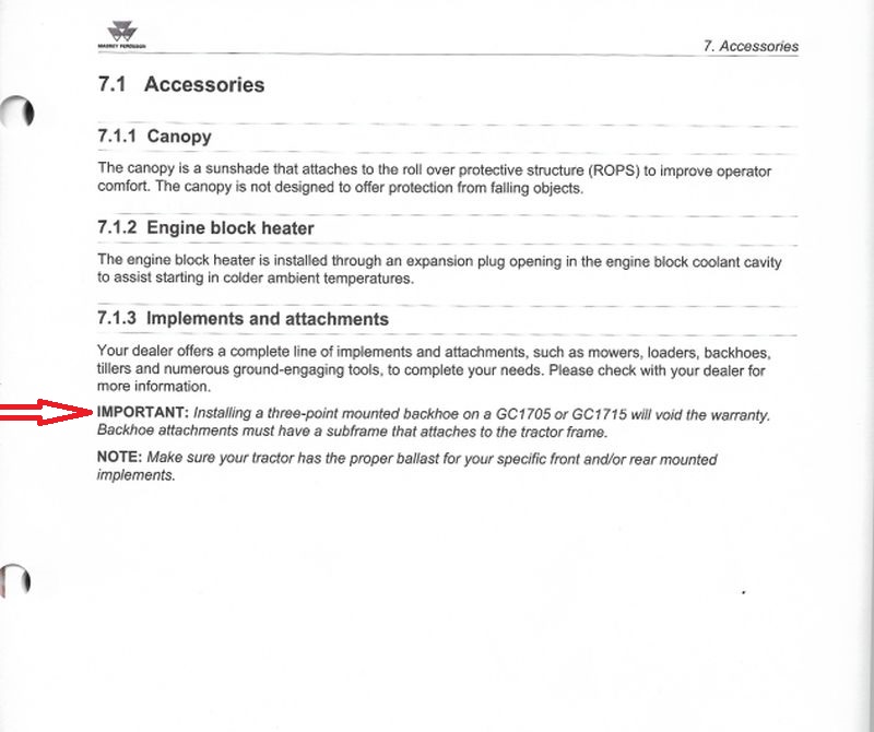

But I am wondering what the manual for the tractor states regarding attaching a backhoe to it. I know with my B2910, it requires a heavy duty top link bracket if a 3PH backhoe is attached. Been using my 3PH backhoe for 18 years without an issue, But that is just me.
No doubt that a sub frame mounted backhoe is a better setup.
Do the manuals for more recent tractors than mine, which was purchased in 2002, prohibit use of a 3PH backhoe?
Curious more than anything...
I just read through my manual quickly (covers the 3901 as well as my 3301) and didn't see a thing about backhoes. Perhaps they cover it in the book for that implement. Contrast that with the Massey warrantee; it specifically voids the warrantee if you use a 3 pth BH. The way that it's written, if I used my BH once and lost the engine a year later, they could refuse to pay if they wanted to be that way.
That was a deal breaker when I was tractor shopping 2 years ago.
I worry more about breaking it when transporting than when I am actually digging, as I run at idle and don't pull very hard with it. I have been intending to get a subframe but as I mentioned before my BH750 is too old to get a custom frame, so it will have to be modified to fit.

I feel for the OP. What a bad situation!
MY Massey Ferguson manual that covers the 1705 and 1710 (factory backhoe equipped) and the 1715 and the 1720 (factory backhoe equipped) states as graphic below...

FWIW, I just checked my Owner's Manual for my L4330 "Implement Limitations, page 12:
Backhoes:
Max digging depth, 90 inches.
Max weight: 990 lbs
Subframe: Necessary
This OM covers models L3130, L3430, L3830, L4330, L4630 and L5030.
By saying "subframe necessary", I'm guessing that that precludes the use of a 3ph backhoe.
