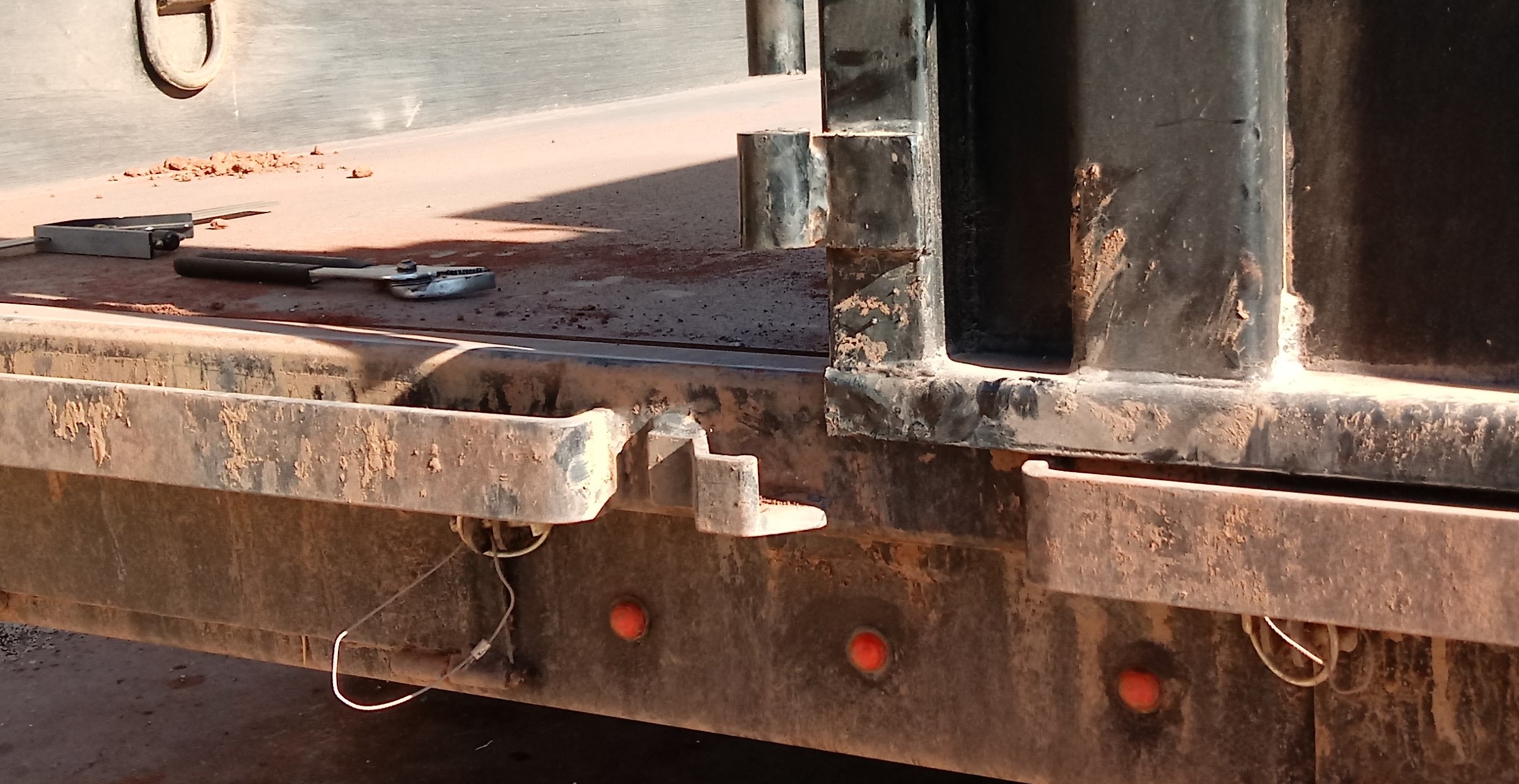

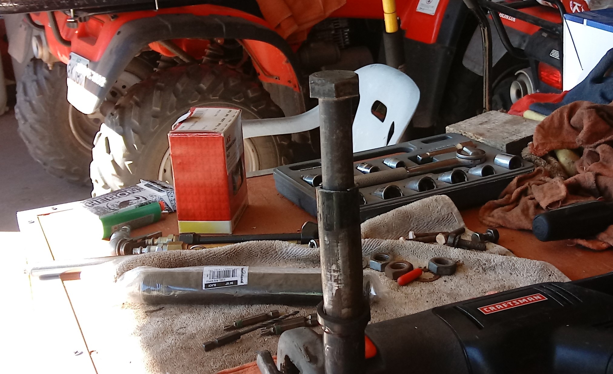

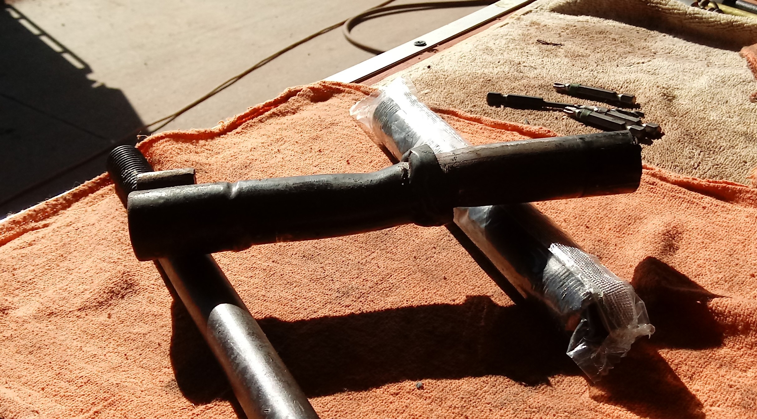

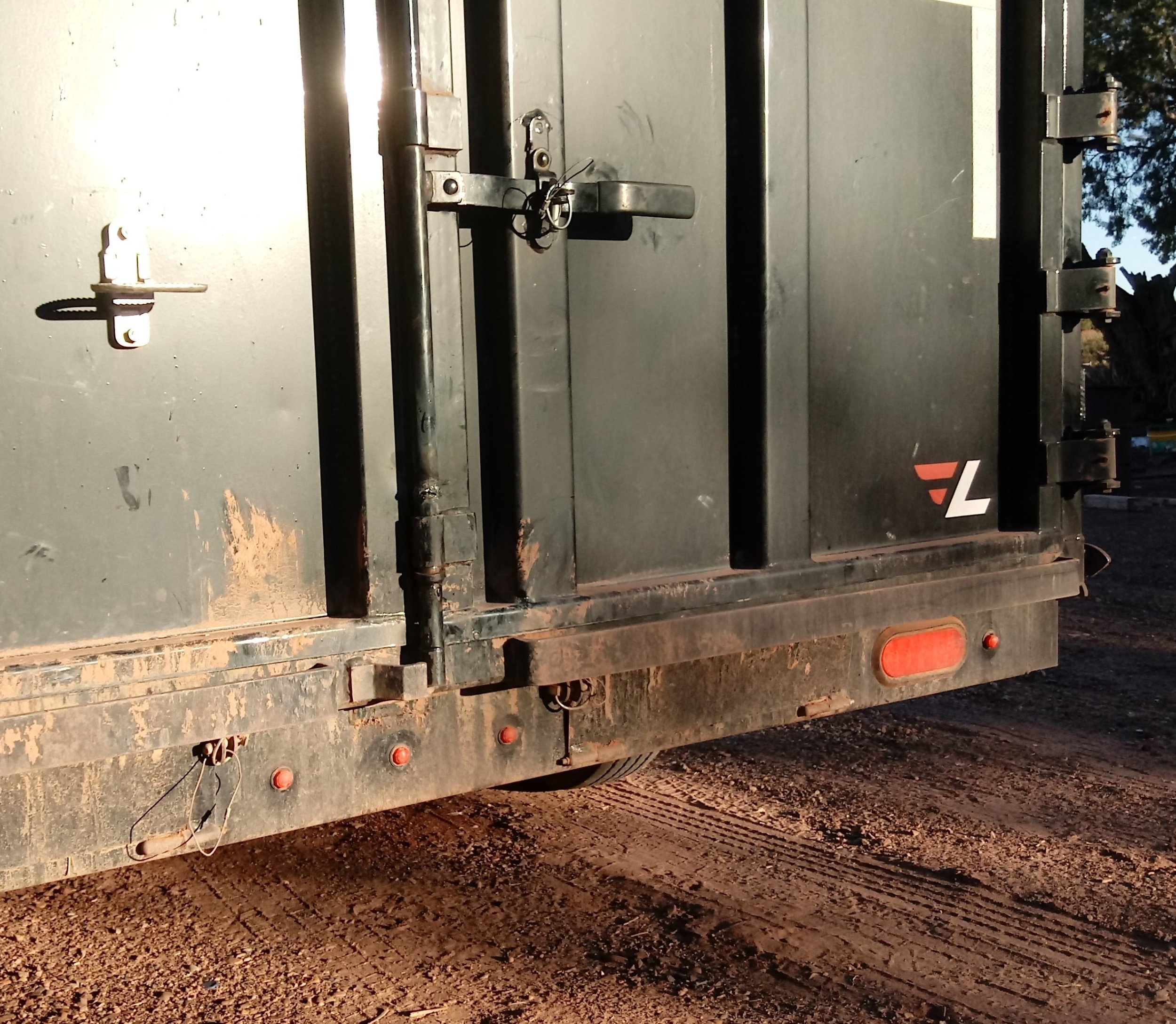

They all use the hollow tube. My Lamar and PJ both bent. They are both 36" walls. The actual doors are pretty stout. The Lamar is the best with 4 hinges per side with the PJ using 3.
On my Lamar, I cut the tube and inserted a 12" bolt with the head cut off, it don't bend anymore.
