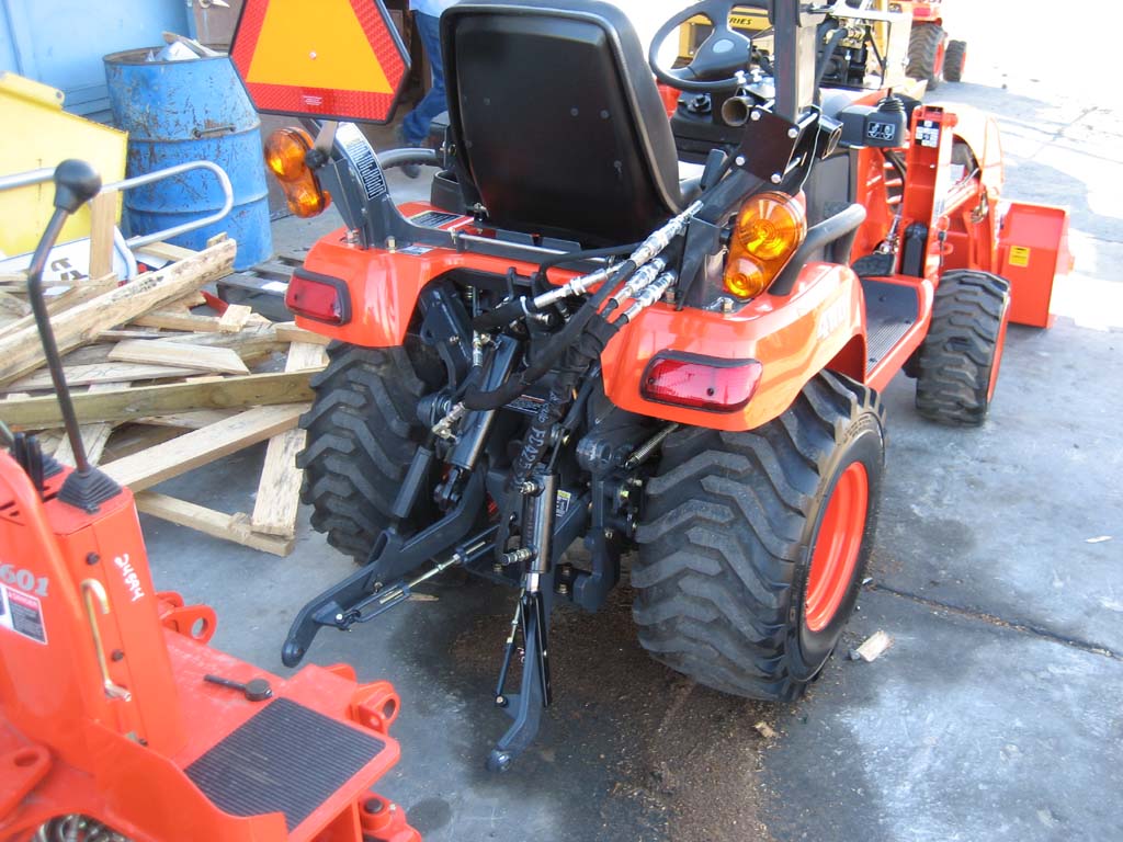

Top, and tilt will also let you adjust the forward, and rear angle of rear attachments like a box blade to control how they are digging / scraping. It can be done on a BX24, and here is a picture of one installation, but I think it can be pretty expensive.

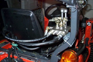

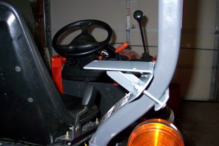

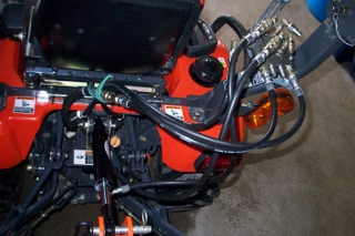

Here is the setup I fabricated for my BX24.
I purchased most of the parts from Surplus Supply and welded the mounting plate from scrap in my garage.
The unit is plumbed into the the backhoe hydraulics with quick connects so it is easily removeable.

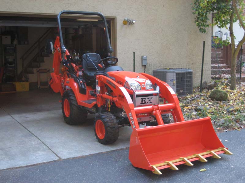

The picture that ChuckInNH posted is of our BX24 when we got it last November. The top and tilt kit on it is a Gearmore and is removable if you don't want the valves sitting there all the time (although I haven't taken ours off yet). It is plumbed so it connects to the backhoe source and return when the backhoe is off.
The kit was about $1250 installed when we purchased the tractor and it has been real useful when doing box blade work (like you, we have a lot of side-hill areas we're working on).
It also makes hitching up implements easier since you can make fine adjustment with a pull of the levers.
Overall, I can't imagine doing any significant amount of blade or rake work without it, but it depends on whether you want to spend the extra $$.

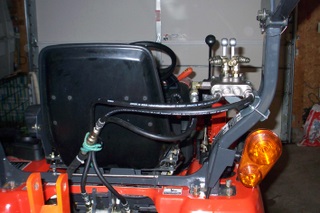

Tom H,
At this time I only have the hydraulic top link. I have about $400 in to this doing everything myself. This is the only other picture I have of the set-up as it is off the the tractor presently.
