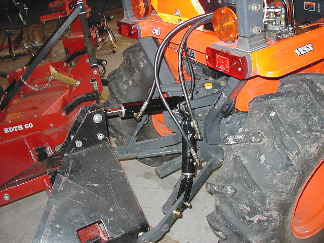

Aaah, I did find the other picture I was looking for.

I don't suppose you have a pic showing the max tilt do you? Anything you would do differently if you were starting from scratch? Thanks again for your help.

   / Top and Tilt for 4200 #24
Jim, I don't think I ever made any pictures of the maximum tilt. I know it was more than adequate. I first started off with implements level with the manually adjustable link on the left shortened all the way and the hydraulic link fully collapsed to allow me to lift implements to their maximum height, but of course, that meant I could only tilt the right side down. After trying that a few days, I re-adjusted so that implements were level with the hydraulic link at mid-stroke. I could still lift everything as high as I needed to and could tilt the box blade either direction as far as I ever needed to.

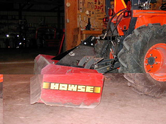

I do have a picture of the box blade tilted all the way forward, so I'll attach that.
Anything I'd do differently? Of course. I now know where I could have bought a valve and cylinders locally for less money. I'd try to find the linkage to use a joystick instead of the two levers. I'd use quick couplers instead of plumbing the cylinders directly to the valve. Don't guess I ever built anything without thinking later of something I could have done better./w3tcompact/icons/laugh.gif
