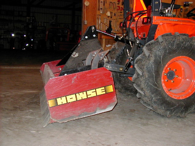

Move the adjustable side link from the right side to the left side and put the hydraulic cylinder on the right side? Yep, that's just what I did. I can't find all my old pictures like I thought I could; must have deleted some of them, but I think you can see the cylinders all right in the attached picture with the box blade tilted all the way back.
Joystick, instead of two levers, sounds like a better idea to me, although I used the two levers that came with the valve.
Flow adjustment? I thought mine worked too fast and inquired about putting flow restrictors in the lines; decided it was just too expensive, and after I got used to gently using the levers, decided I really didn't need the flow restrictors anyway.
And under different conditions, I did use the full stroke in both directions on the hydraulic cylinders sometimes. Other times, of course, you only want slight adjustments.
Hydraulic top 'n tilt would work great with quick attach systems, but I didn't have any quick attach. However, the hydraulics still were a considerable help in hooking up the old fashioned way, too.

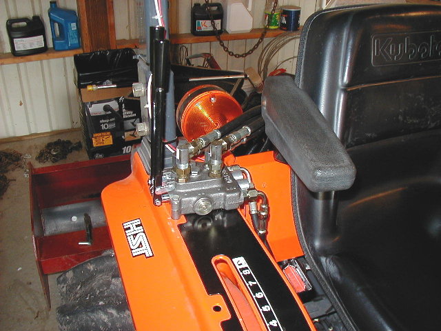

The attached picture is the two spool Tisco valve that I used, but the two levers shown were the wrong ones. The dealer had to order the right ones and I exchanged them after this picture was made.
