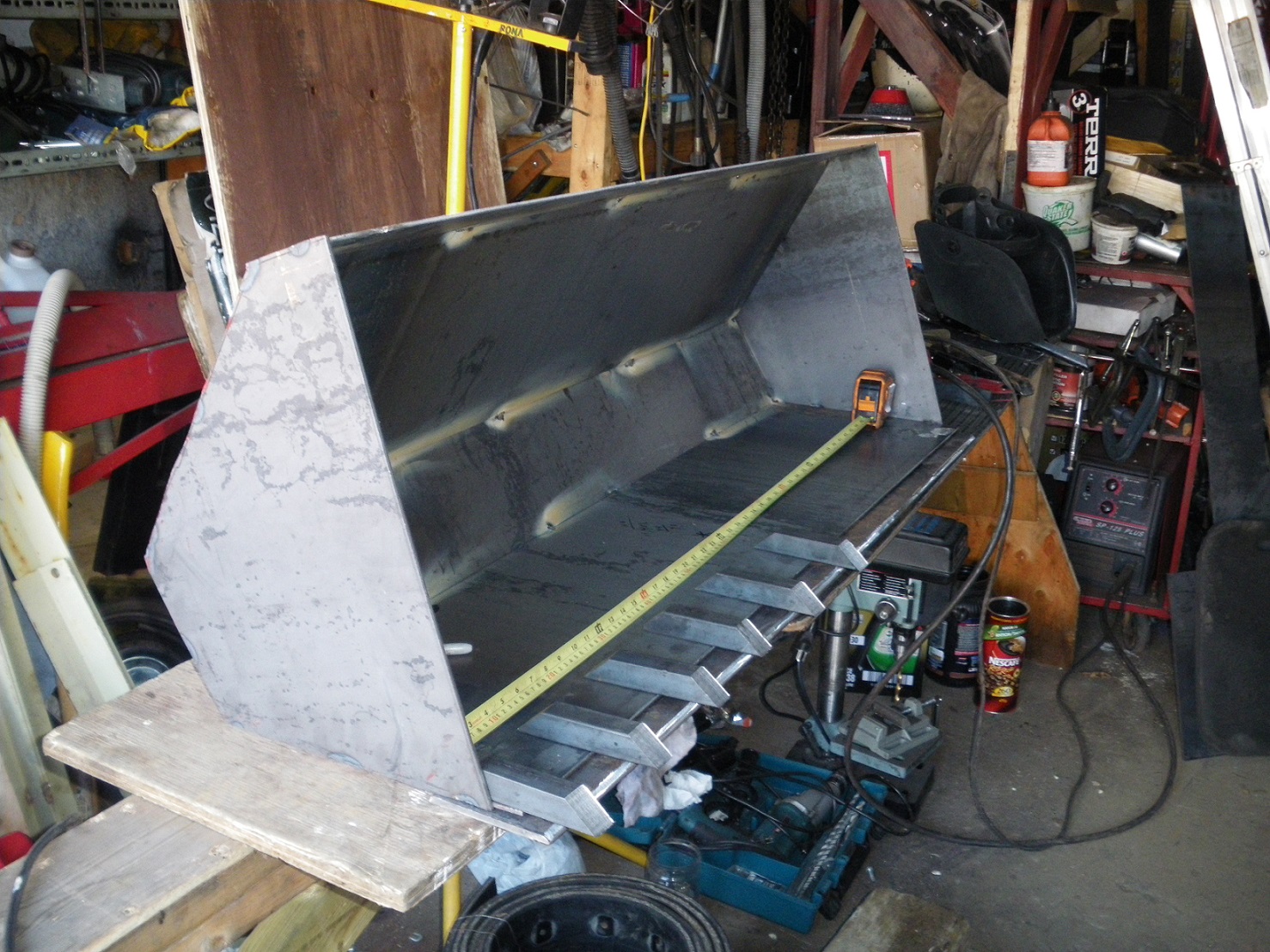

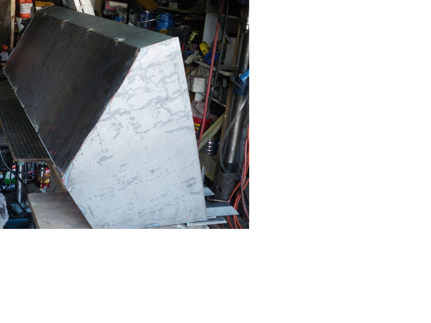

Since I have a 54 inch quick attach bucket on my B3200, I have been thinking about building a stronger toothed bucket. Last night I penned a drawing and this morning I dropped $300 bucks at the Steel shop. I have 3 hours into it and hope to be ready for primer tomorrow if I don't run out of welding wire.

Looks good! Are the teeth high carbon or mild steel.
/ Toothed Bucket Build #4
It looks nice. Was it cut with a plasma cutter?
The slightly narrower bucket should help it dig better.
You might consider longer teeth, or some reinforcements along the bottom. At least I thought the teeth in our old international bucket extended the length of the bucket (bolt on?), although I'm seeing many that appear to be shorter.
Perhaps a strip of sharpened half inch x 3" or 4" steel along the bottom. Grader Blade Edge?
If you're using mild steel, you could build high strength points on the teeth by extending along the bottom beyond your grader blade edge.
/ Toothed Bucket Build #5
Are you sure you dont want the bucket teeth to ride below the bucket edge a little ? You could also weld a piece of bucket edge under the teeth, to make them cut at the right hight, and as well make them sharper for easier penetration.. :)

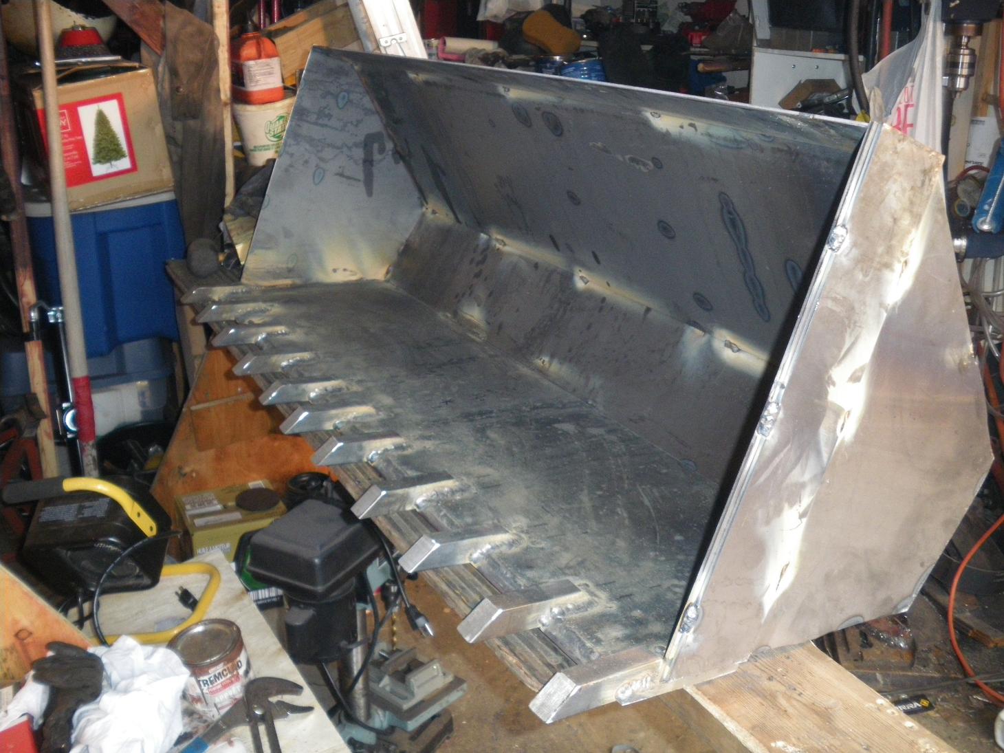

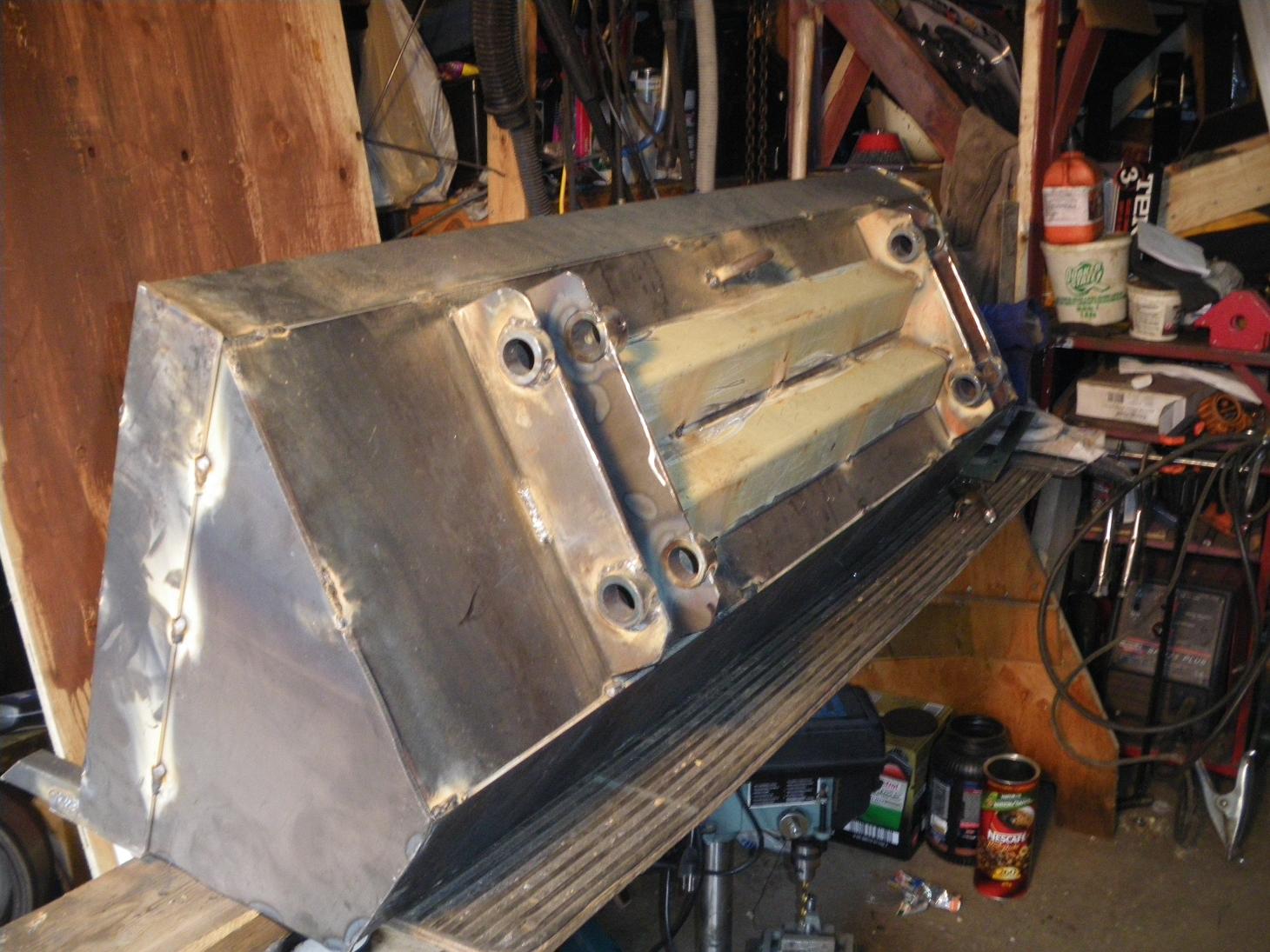

Actually the first picture was just with the teeth resting on top for a visual. The teeth are mild steel 1x1 solid bar. I have been looking at some interesting buckets on Youtube and like the idea of a bit longer teeth. Mine are 2.5 inches beyond the bucket. The bottom edge of the bucket is just over 1/2 inch thick. I have left to add metal to the top of the bucket and a few odd pieces to stiffen up the bucket and then about 40 feet of welding.

Basically I was not sure of the exact sizes I needed so I bought a 4'x8' sheet of 3/16th and had the steel shop cut all the pieces on the 4 ft side. IE 3 pieces at 12" x 4' of which I used two. 2 pieces at 6" x 4' of which I ended up using one, 2 pieces at 3"x 4ft which I used most of. I also have left one Piece of 10" x 4ft and 14" x 4ft as I was not sure until I mocked it up what sizes I would need. One piece of 3/8 thick x 4.5"x4ft, and 4 ft of 1"x1" solid bar. I have had good luck with using mild steel teeth on my backhoe (1.25 square) so will try it again here. Not like I use it more then a couple dozen hours a year. The remainer of the 4'x8' sheet was sheared into 1.5 inch wide pieces for some track plates for another project.
