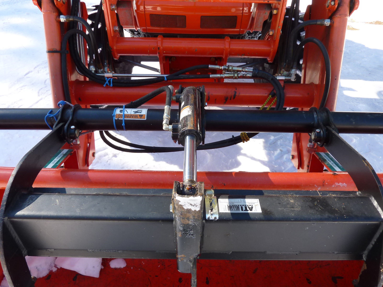

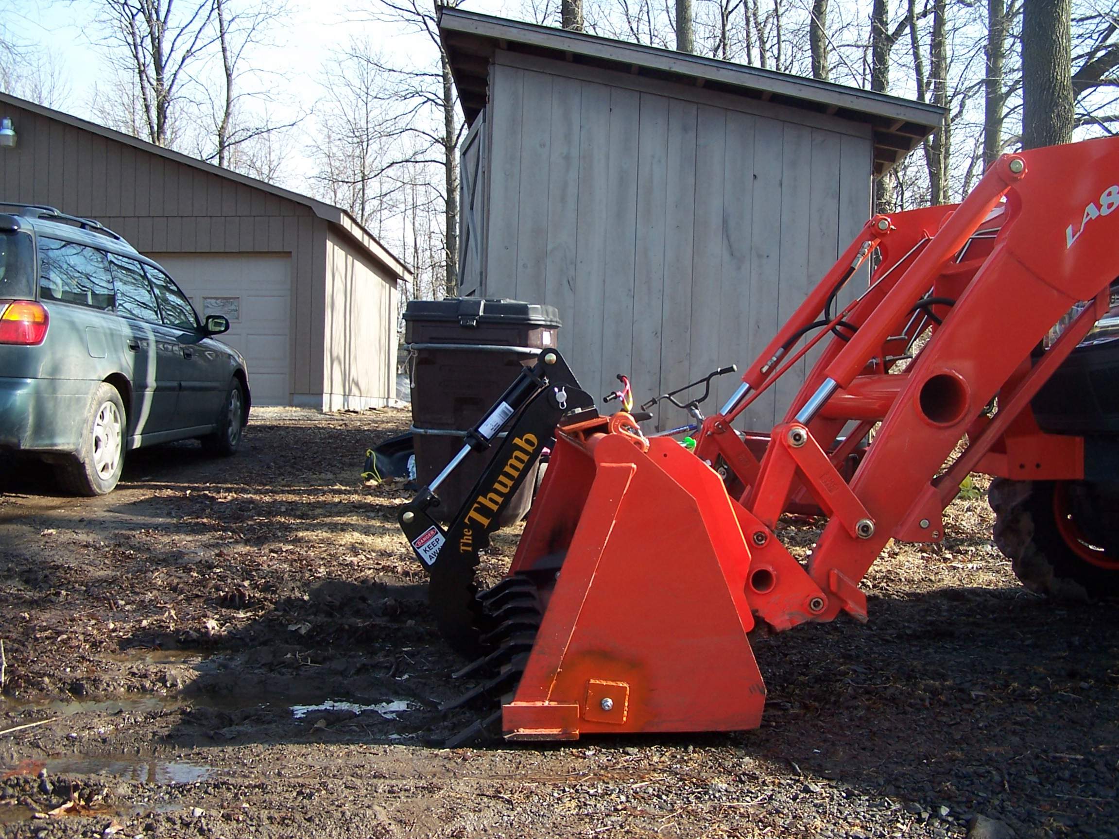

I have the same set-up;works great.

Birdman, I actually used the picture of your set up to install mine. My bucket is rounded on the top like yours, so I looked at how you mounted angle for the thumb mount. I also used flat stock for gusseting like you. Referred to your picture a few times while I was figuring out how to mount the thumb.

Great;I really like my set-up.I welded the nuts to the bottom of the angle and can remove the thumb easily if needed.The only limit with this set-up(compared to a full grapple) is the "open" size.
