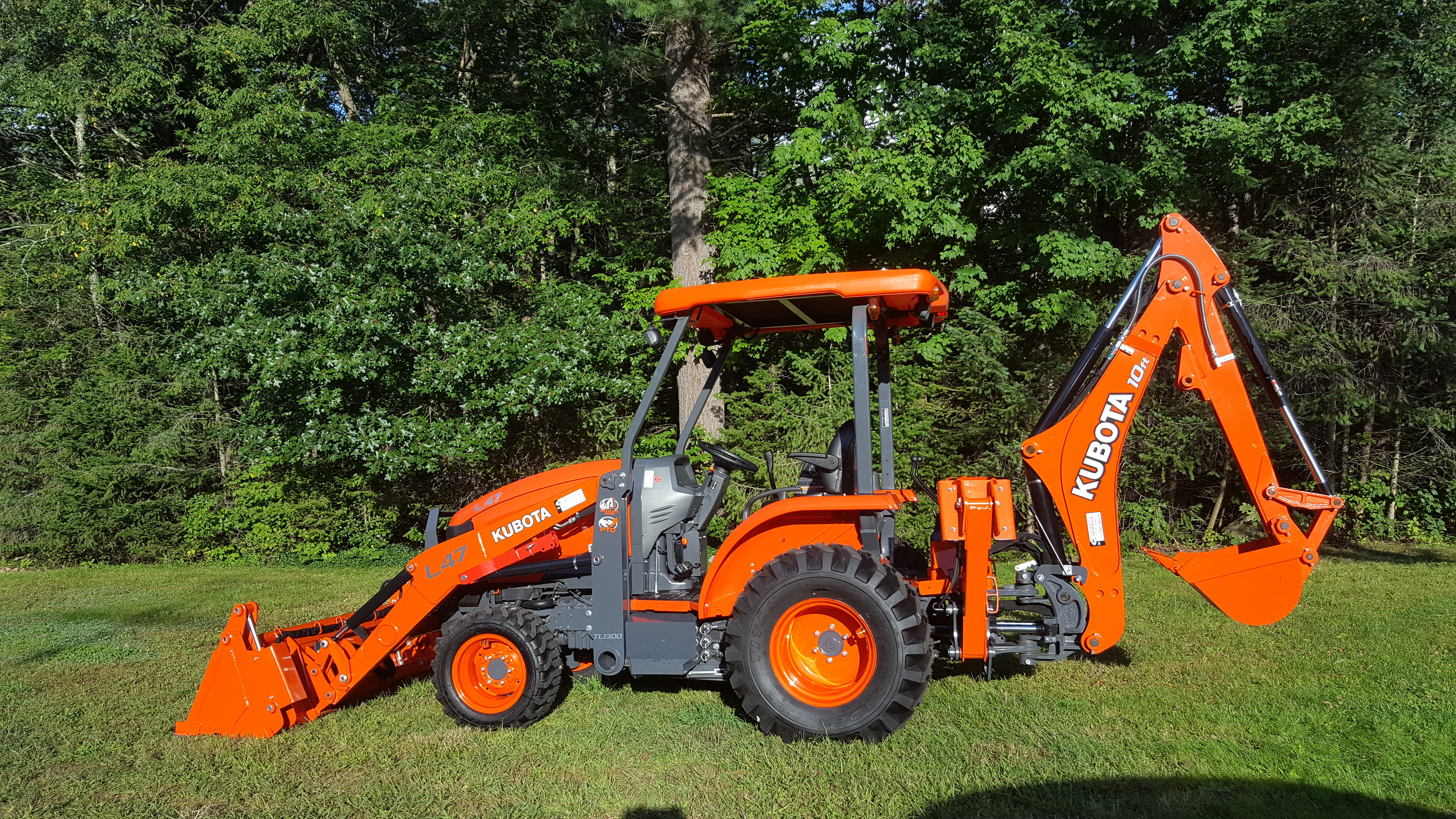

I dont want to pull this tread to far off topic but why does everything have to "pay for itself" or "get its money worth". Why cant it just be for the added value to your life? All my purchases now are based on how much value is it adding to my life because the true cost of anything is how much of your life you are willing to trade for it. ****, seems most people have no problem paying $50-100k+ for a boat or RV....
Most people will justify buying tools based on how much it cost someone else to do the job or how much it cost to rent said tool or how much they will use it. I used to think this same way, but a few years back I met a guy who had cut his finger off while using a borrowed table saw because he didn't want to buy a new one at the time. It completely changed his life, his line of work, etc... and this could have all been avoided by spending the extra buck (which he had) on a saw stop which he said he had previously contemplated buying. His medical bills cost more then the saw would have cost him, but as many of us do, we buy or borrow a tool that "will do the job" and don't think about how the right tool could add value to our life.
Not long after becoming friends with the guy, my wife went bought a couple of large trees to plant around the yard. I wasn't going to go rent or buy a backhoe to plant a couple trees, so I dug the holes by hand in my concrete like ground with a digging bar, pick and shovel which was very hard work (I had a tractor and post hole auger at the time but it was useless on my ground). Every time I would plant a couple trees, I would tell my friend with the sawed off finger how hard it was and how sore I was. His response was pretty much always the same... "you should buy yourself one of those tractors with a backhoe, one of these days your going to wish you did". Well 4 years later I ended up planting more than 50 trees and shrubs by hand, one day I was digging a hole for another tree and something in my back popped, that was it, I was done. Took me all summer to recover and I still have back issues today. I wish I would have spent the money on the tractor I have now, 5 years ago instead of having to deal with a bad back. At this point I don't care how much I use my tractor/hoe, just knowing that its sitting in my garage, ready for when I need it is worth it to me.
I did the backhoe thing (used) when I was 46 years old.
I am 77, the 3400 Ford is now 48 years old. 2 years ago I completely refurbished it.
I use it less than ten hours each year.
I justify it by the fact that it is very handy to have around.
People often ask me why I have it. I tell them it is simple: I like it!
It actually paid for itself early on, when I installed my two new septic systems (on the sly), and reconstructed my entire front yard & driveway.
Post demise, my kids may choose to sell it, but I NEVER will!

I had an 80hp backhoe. Not a TLB, a backhoe. Was incredibly useful and so nice to be able to use for whatever, whenever. However, it was a JD500C - very old (early 80's) machine. Lots of maintenance issues. While I very much liked doing work with it, I very much disliked playing "backhoe mechanic" to keep it going. And even a used machine but in great shape - is still pretty expensive to buy and maintain. So I rent a backhoe from Hertz (Herc? what are they called now?) at least once per year. I let those projects wait and knock out as much as possible over a long weekend rental. Sucks waiting, hoping weather works out, and paying a lot for just 8-16 hrs machine time.
But, all I do is work it and add fuel. They worry about insuring it, maintaining it, fixing it, storing it, dealing with someone stealing it, having $ tied up in it, transporting it, etc.
Do I miss a 1.5 cu yd bucket, sky high dump clearance, virtually unlimited lift capacity, and pure brute strength? Absolutely! But when the head gasket went...after sorting a ton of electrical issues, after rebuilding bottom end for spun bearing, after replacing starter, after replacing the alternator, after replacing control valves, after fixing 16,034 hyd leaks, after having a cyl rebuilt, after......that was last straw and it had to go.
Didn't come out great out that deal by any means. And only had a budget of $X to work with for a tractor and any sort of BH was > $X. I'm just maintaining recreational land....sinking excess time & $ into that endeavor is just a hard choice to make. So for 99% of what i do with my little tractor and small assortment of attachments there is something out there better suited to the task. So I make do. Maybe not as fast or efficient or the best possible way, but surprising what I CAN do with my little machine. Just takes longer, more trips, smaller bites. So my one little machine has to be as versatile as possible since I'm going to ask it to a lot. If I can add a tooth bar or buy some $500 used attachment to add to it's capabilities - great! Will I forever be working around the machine's limitations - figuring out how to do projects with it within its capabilities? yep....but could probably be said for any piece of equipment - there's going to be something that could do it better...
I can mow and I can move it all by myself with my F150...2 things I couldn't say about the backhoe :)
