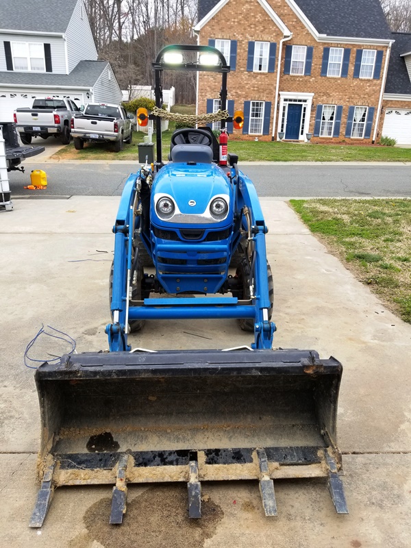

This is what I ended up with. Worked really well. As pointed out earlier, it was exceptional cutting into a small hill for digging. Once that was done and I was trying to dig down a little, was a lot more difficult. But some thick roots, decent size rocks, it handled it. Not nearly like what a big machine could do, but was able to do it. I think without the teeth I would have just been stuck taking an ax to roots or not digging down once I cut into the bank. Only 2 bolts to remove...haven't done that yet, but looks very simple on/off. Only disadvantage I noted was back dragging...left lines where the teeth are. From looking at pics of the Piranha one, it looks like it would back drag better with a level bucket.

Apparently you learned pretty quick, the pros and cons of a tooth bar. And there are couple of advantages of Piranha over a regular tooth bar. But still I would be without one.
Tree roots are the toughest things to dig out, even for a small tractor mounted backhoe. Stones and large rocks are easier than tree roots.
When I have a need to remove my tooth bar, I use a 115v impact wrench on those two bolts. It makes very short work it.
