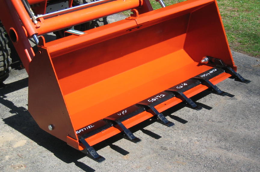

Gray: ...... I, too have read about all the advantages of a toothbar & like you have sprung
to add to my FEL. /forums/images/graemlins/cool.gif
The installation was easy ( using the techniques that were reported here ) 3/4" holesaw worked great!
/forums/images/graemlins/smile.gif My install was on a LA402 Kubota FEL @ $273
( 6 tooth from NH dealer) see photo.
It still is wet and soggy at my place, so it will be awhile before I can test. /forums/images/graemlins/laugh.gif ....RayBee

I got one this spring also and it is unbelievable what a difference it makes. I like it for brush even better than dirt and I hadn't been counting on that. It's even worth the extremely high $417 I paid for it.

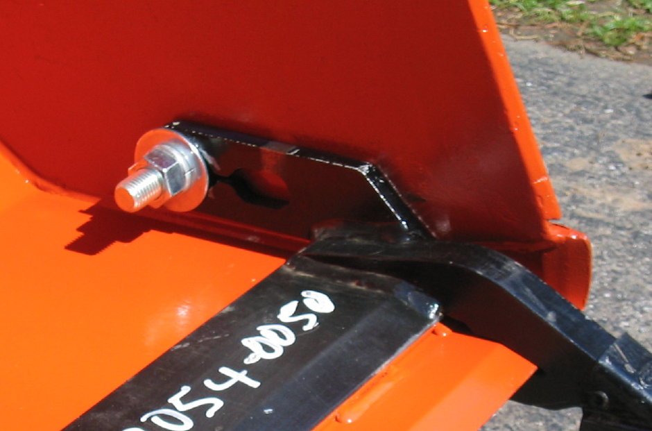

I'm also including a closeup of the bolt-on bracket.
Notice the double slot ( I guess for flexibility of fitting many buckets ) /forums/images/graemlins/smile.gif
I hadn't seen this before on previous posts.
New Holland buys these from FFC to fit their buckets.
You can check the specs. here -- www.sweepster.com/buckets/tbar_sd_specs.htm /forums/images/graemlins/cool.gif ......RayBee

You may want to consider adding a few nuts to cover the threads on the bolts. All it takes is one stone to hit the threads and you will have a lot of fun taking the bar off.
/forums/images/graemlins/confused.gif
/ Tooth bar #7
I put my bolts in from the inside out and cut the extra off so that I didn't end up catching my leg on them easily either.
/ Tooth bar #8
I wrap black tape around the exposed threads and cap the end with plastic caps. It seems to work.

</font><font color="blue" class="small">( I'm also including a closeup of the bolt-on bracket. Notice the double slot ( I guess for flexibility of fitting many buckets ) )</font> RayBee, on my Woods Toothbar, that mount is a slot, open all the way instead of having double slot. Guess it would work the same way, but give more options. I cut the hole and put the bolt in closest to the font of the slot (cutting edge side). I wasn't sure if that was a good idea, but it's holding well. Wish I had had a 3/4" hole saw, I had a 1/2" drill bit and did the rest with my dremel tool with a grinding wheel. Actually worked quite well. John
