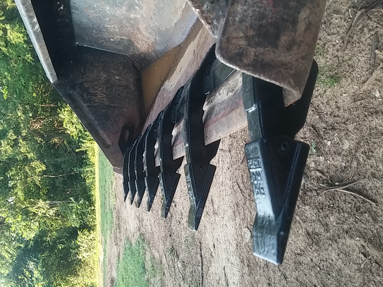

Just received my 60 inch bolt on TB tonight. It took about 15 minutes to install. I worked it for a couple of hours tonight digging, back dragging, and digging up a concrete patio.
I don't have much time on mine yet, but there does not seem to be any play between the bucket and tb. I am impressed by how the tb seems to be one with the bucket, being only secured by two 5/8 bolts. Mine did not come with mounting instructions, but the install was about as easy as it gets. I did put vertical down pressure on the toothbar to force the tb female wedge tightly against buckets cutting edge, then I tightened the bolts. It feels extremely solid. I weld most of my stuff that takes a beating, but I don't feel it will be necessary on this.
