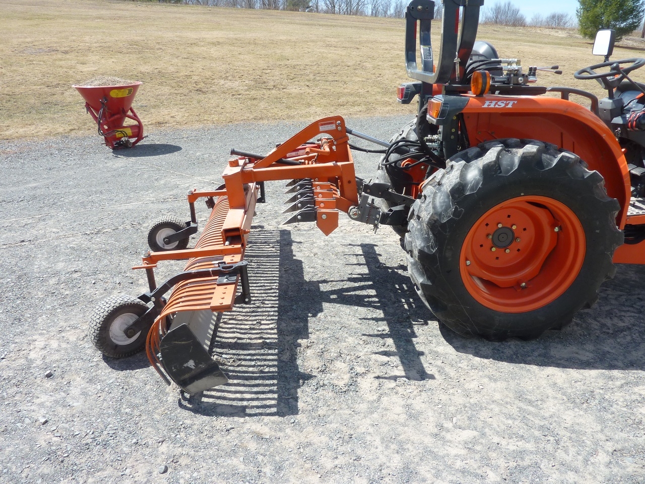

This is what I'm using now:

Thats a nice rake!!!
I can see that the scarifier section is not that wide, though. Still cool to have it at all.
As far as having the bucket fully dumped (and loader in float i assume) i think how safe that is depends on what angle the teeth end up at, and whether the bucket has ‘travel stops’ that physically prevent the bucket from rotating any further.
Reason being, if there is no metal on metal interference that prevents the bucket from moving any further, then any snag on the bucket edge/teeth would be trying to rip the bucket cylinder glands (the end cap that the rod slides in and out of) out of the cylinder, and very well might.
If you have robust bucket stops to protect your cylinders AND the teeth end up angled sufficiently towards the rear to make a ‘ramp’ to push the loader up and over any snags, i would say ‘proceed at your own risk’. If either of those elements are missing i would call it a hard no, personally.
I can understand not wanting to venture into the realm of fabrication but it seems like you just need a wider version of the scarifiers you already have on your rake. Perhaps they are kept narrow so as not to limit the rotation of the rake, so a whole separate implement might be called for vs widening them.
Yes, the rake pivots but the scarifier bar does not. It isn't as wide as the tire track.

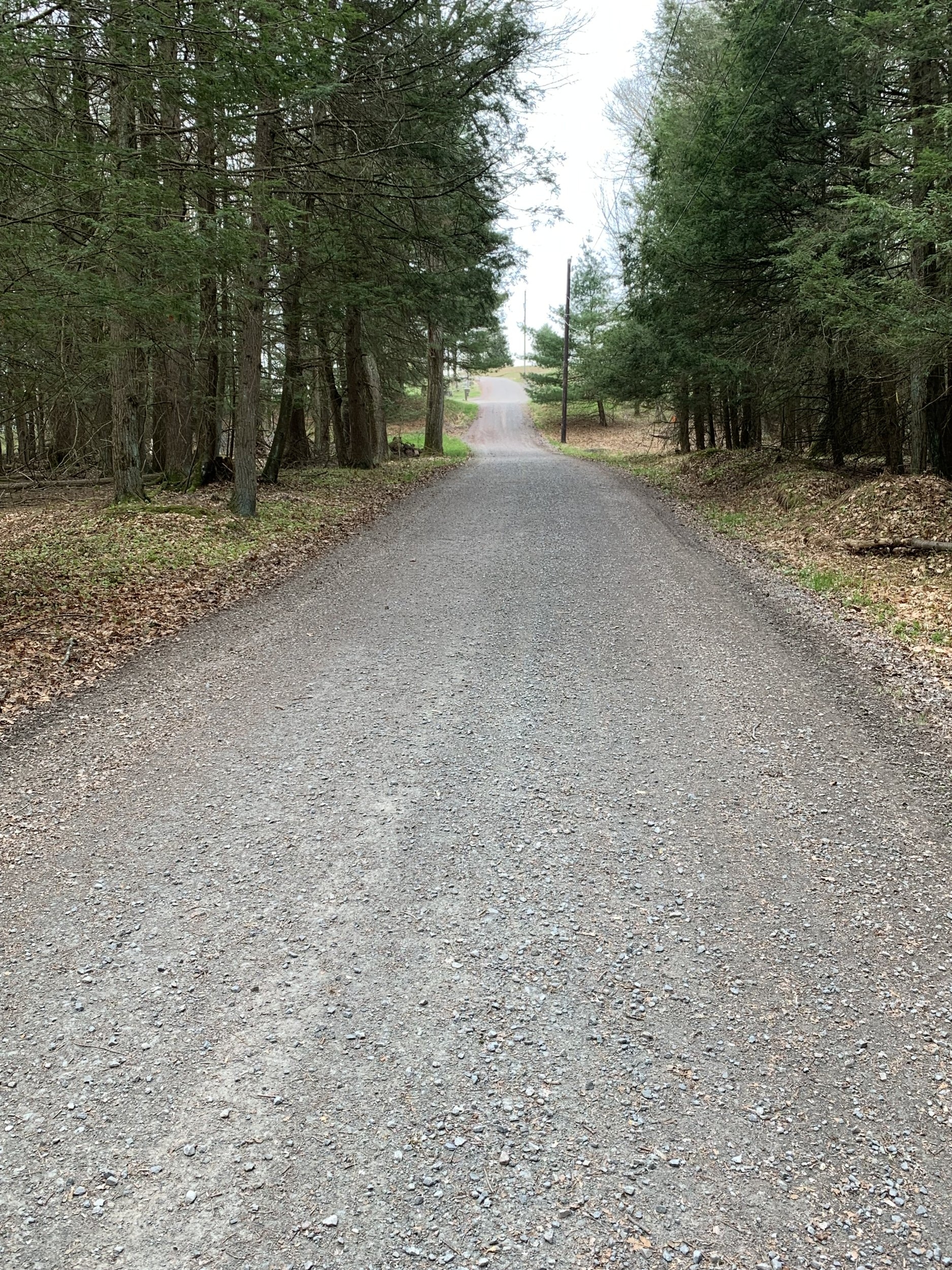

Locally, it's called 2RC modified. It's a mix of crushed stone, 1" down to dust. It's heavy on the fines, which makes it pack well. It holds on the level but tends to wash out on the grades.
I also plow off a fair amount during the winter. I have to use the rake to pull it out of the ditches and back onto the roadway. The ripper is necessary to level the surface every spring, or after a torrential rainstorm. I try and do it when it's wet to minimize dust. That way, vehicle traffic packs it down quickly.
I did these sections yesterday, but still need to do the ditches. We're supposed to get showers today, so it should pack down in a day or so.
