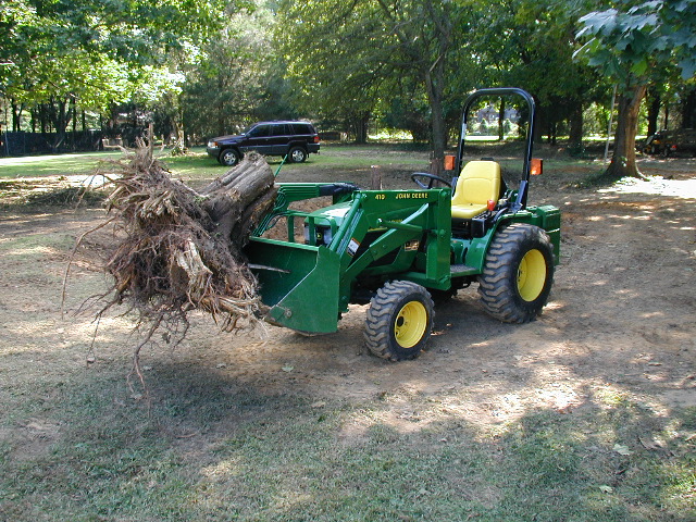

cant remember where or when I got (year 2000 ?) it but its solid and will never break - I dug out stumps this size with it (pre-backhoe days) with a smaller machine (but very capable)

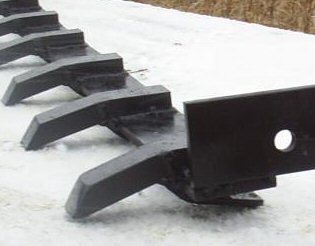

Can I get some of you lucky tooth bar owners to post pics? There is some debate with myself and another person that the CAST FORGED teeth are much better than the WELDED teeth. It appear like the Markham bar has welded teeth and not cast. I have attached three pics. Once is the Markham, the other is from United Steel Works and the other is from Yankeewarehouse. The only one that looks like the high-end toothbars offered by Bobcat it the forged United Steel Works unit. What do you guys think?
I would be greatful if you toothers could post some pics!!

Your a worrying to much...The Markham toothbar has welded on shanks, and replaceable teeth. It is a proven design that will take more abuse than your tractor can ever dish out;)

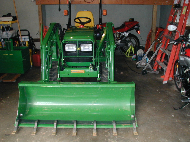

I think 5 teeth for a 53" is fine, I attached a older shot of my 61" bucket with 7 teeth
