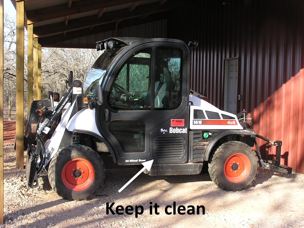

The problem we had was the air conditioning quit cooling because we didn't open the access door on the left side and brush off the dust and clippings. If you keep it clean it will keep you cool in the cab.

My F series 5600's air filter clogs in a short time. Poor location. I had a B series with a pre-cleaner and it worked great to keep the machine breathing. The radiators are another story. Get some "cut to fit" ac filter and lay over the radiator housing and close the bed down on it. Change it or beat it against something when your temp starts to climb. These things suck a lot into the radiators. A/C filter location is not very smart, either. I get a lot of dust in my cab when I mow. A LOT and my B series didn't.

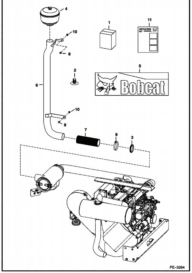

I have problems with grass getting sucked into the air cleaner. I just found a precleaner that will bolt up nicely. I think it's approved by Bobcat for F series and later.
/ Toolcat #12
Need more details please.
Pictures, part number.
I need one!

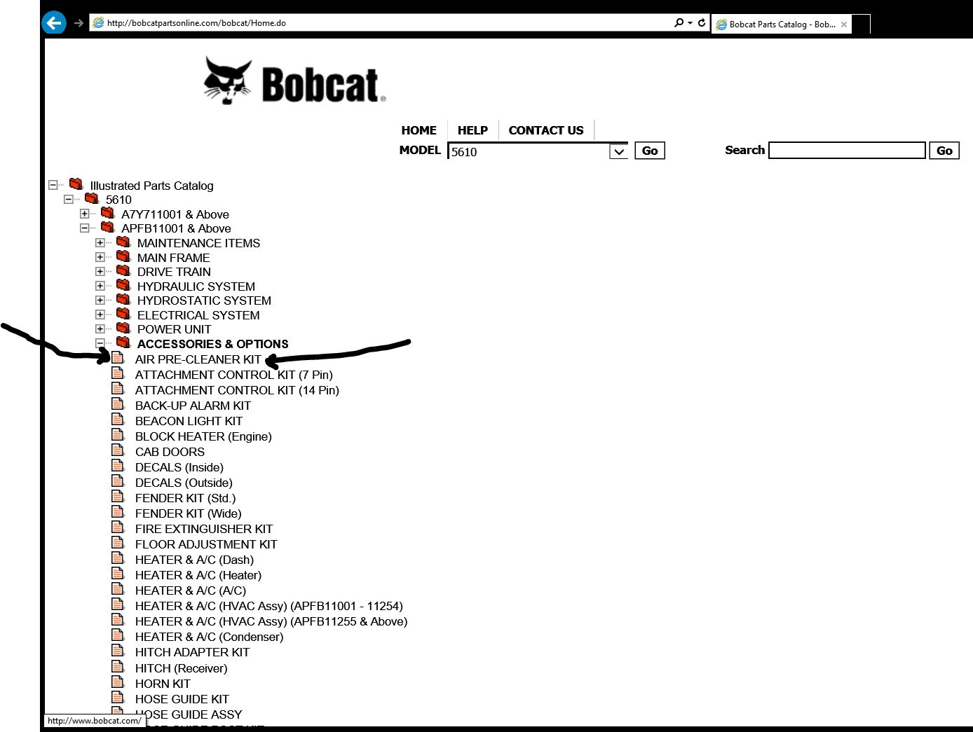

Go to the parts illustrations in bobcat.com then look in the Accessories/Options section under your model & serial number to find all kits available with parts illustrations.

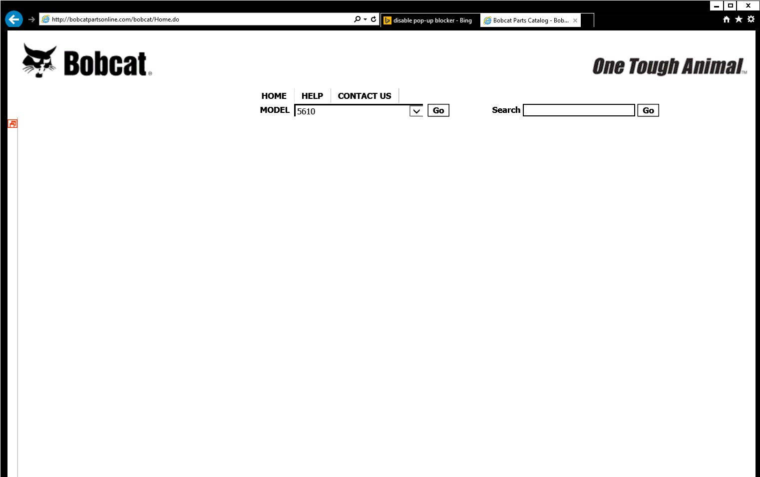

That doesn't work on my computer. After I click the item, nothing comes back.
/ Toolcat #16
I can get this on IE, W8.1
attachment.php
But this is after clicking it
attachment.php
Can anyone post a picture of the Air Pre-Cleaner?
TIA.
/ Toolcat #19
Thanks, it worked, now I know what it looks like.
