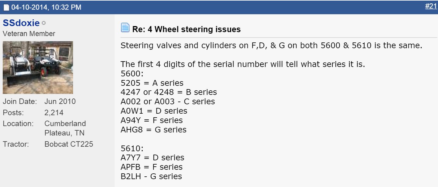

And a snip from SSdoxie​.
attachment.php

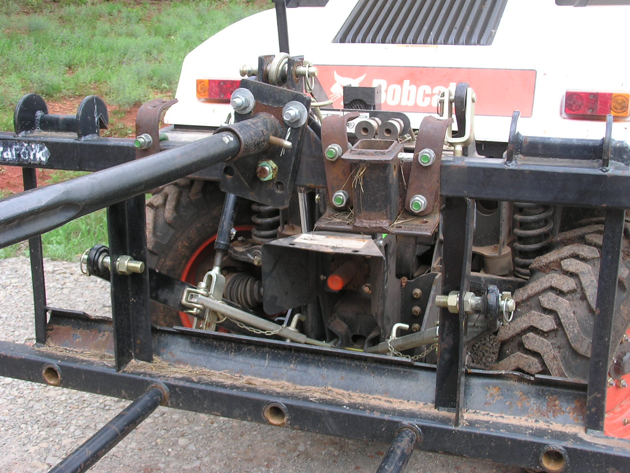

What will you be using a 5600 for? Do you have to have the cargo box?
My 5610 has the PTO, have only used it with a post hole digger. :thumbsup:
This is the only picture that shows the PTO up close.

What will you be using a 5600 for? Do you have to have the cargo box? My 5610 has the PTO, have only used it with a post hole digger. :thumbsup: <img src="http://www.tractorbynet.com/forums/files/toolcat/444066-toolcat-series-pc190005-jpg"/> This is the only picture that shows the PTO up close. <img src="http://www.tractorbynet.com/forums/files/toolcat/444067-toolcat-series-p5240040-jpg"/>
Probably not a ton of things for the pto but we do have a post hole digger and a 5 foot bush hog style mower though I likely would look for a front mounted flail mower to purchase with the toolcat.
I just like the flexibility.
As far as the box, countless things. We have a 50 acre property to maintain with horses. We'll use the box and use it a lot, though if we upgraded to a heavier duty utv maybe that would be minimized. But nice to have the convenience for multiple things.
